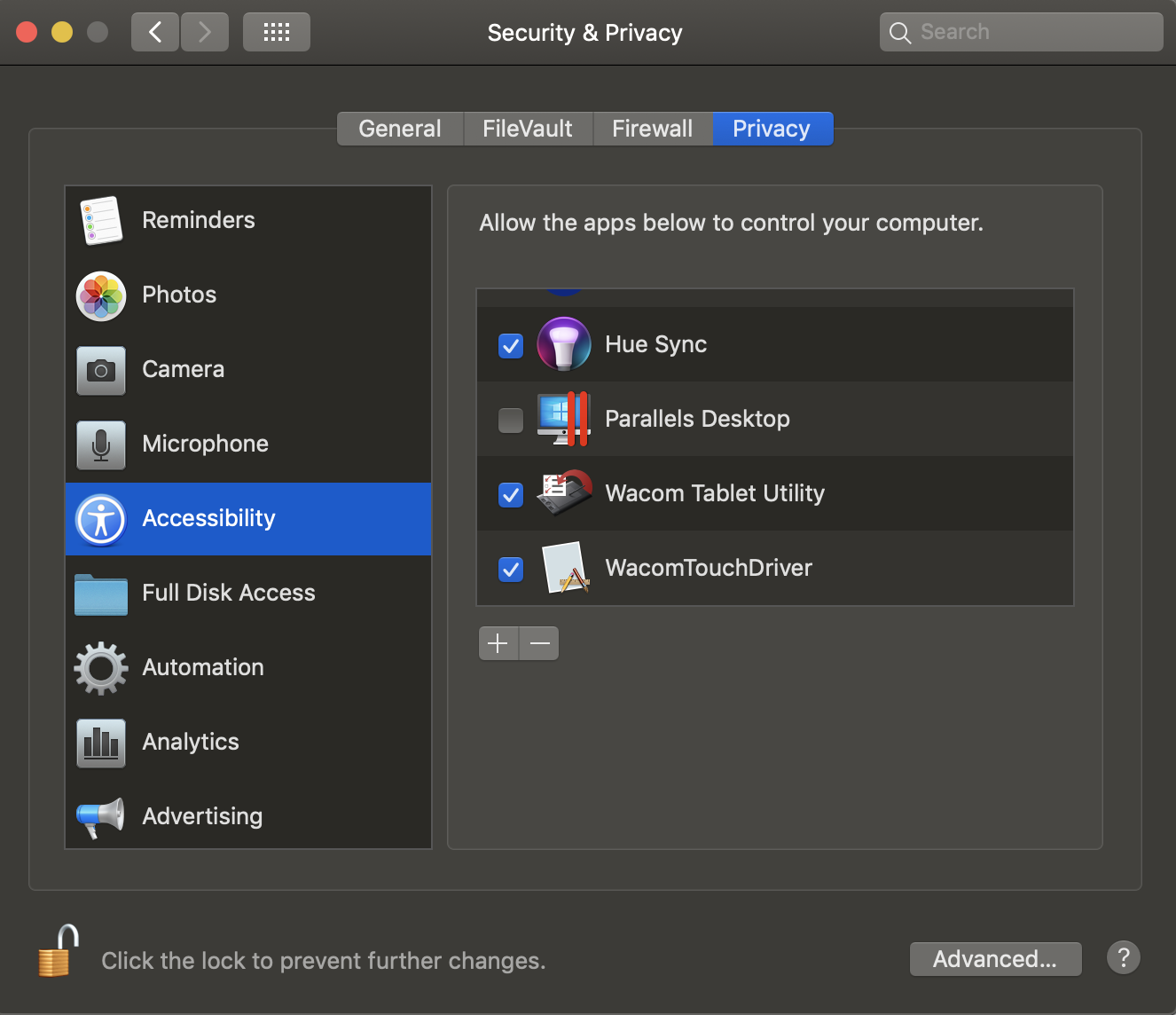

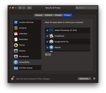

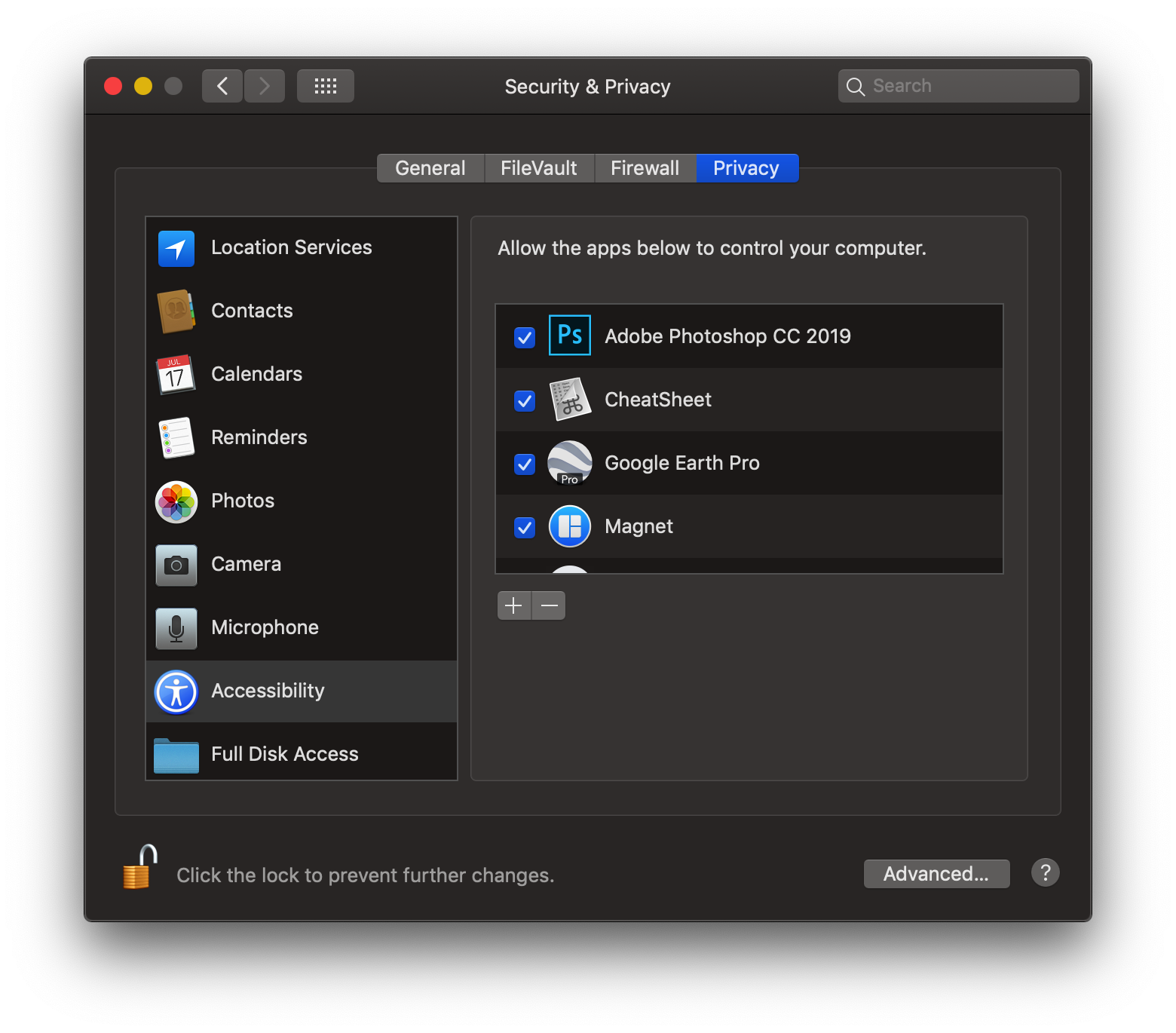

Close PS, then open System Preferences > Security & Privacy > Privacy > Accessibility.
Photoshop will be on the right hand side of the box, under heading 'Allow the apps below to control your computer.' If the checkbox is unchecked, "tick" the unchecked box - like the one you can see in the attached screenshot - and reopen PS. Do the same for the Wacom Tablet (and Touch Driver if you have a touch tablet - if this beastie is unchecked with a Touch tablet that has touch enabled, your tablet can be a bit of a PITA - trust me on this bit...). This is my setup...
If that selection checkbox is selected already, make sure PS is closed/quit, remove that app option from the Accessibility Pref Pane, restart your Mac, open PS (and wait.....), then quit PS, open the Accessibility Pref Pane and check that driver control option as I'd indicated in the para above.
I'm not going to take full credit for this, MacWorld UK figured this out a few months ago during the beta process before the GM came out. I had similar issues during the Mojave Beta process and dove into the interwebs to figure this one out - no problems since. These aren't the only forums I dance with... 😀

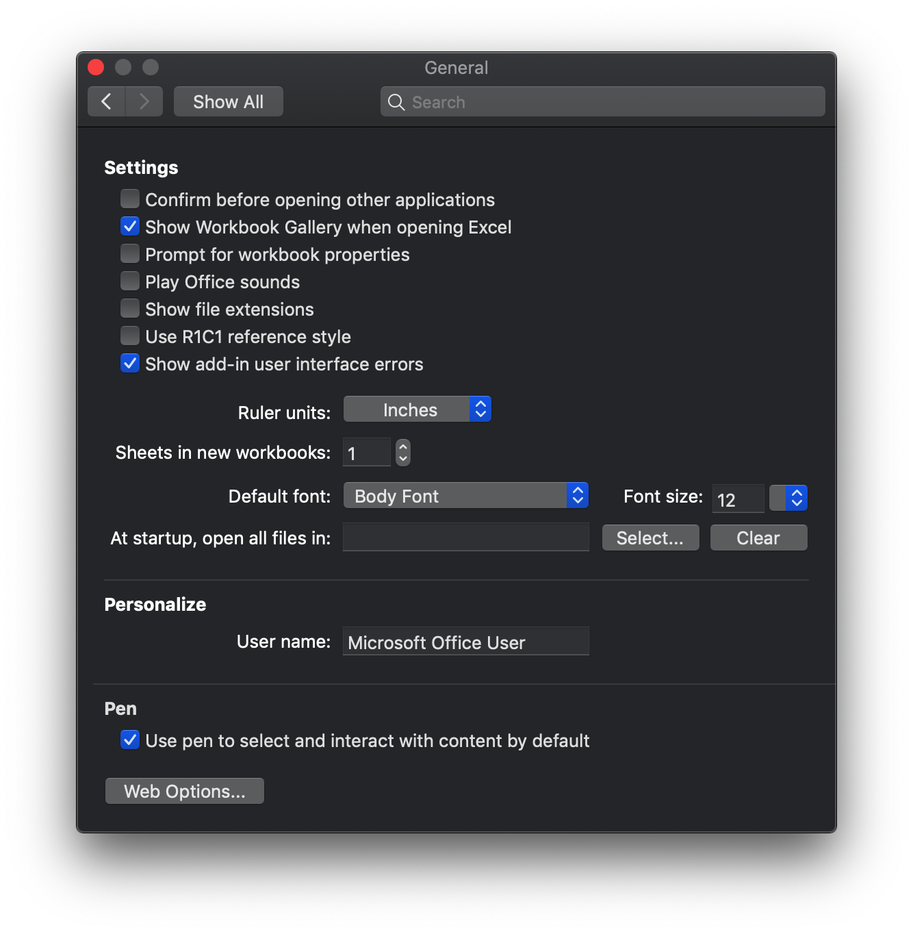

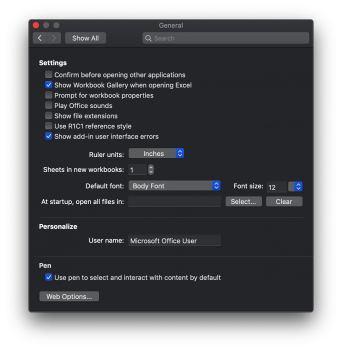

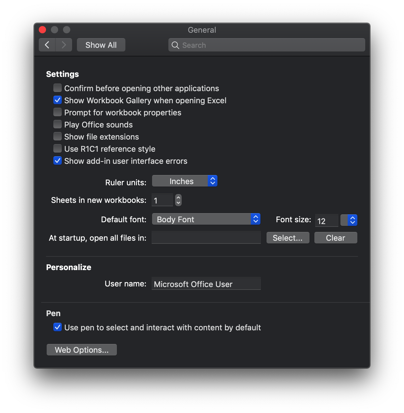

In macOS Excel, in the Excel app "General" Preferences Pane, make sure the "Pen" option is checked. If it is checked, uncheck it, save your work (Excel always updates its preferences upon Save/Save As), then quit Excel, then reopen Excel, and check the "Pen" option, then Save/Save As, then quit Excel, then reopen Excel and you should be good to go.
If that option isn't present, you may need to switch to the Fast Ring to get that Pen option in Excel.
If issues with Excel persist, add Excel to the Applications in the Wacom Pref Pane, and in Excel's new options, under "Mapping" change the Pen's Mode to Mouse.

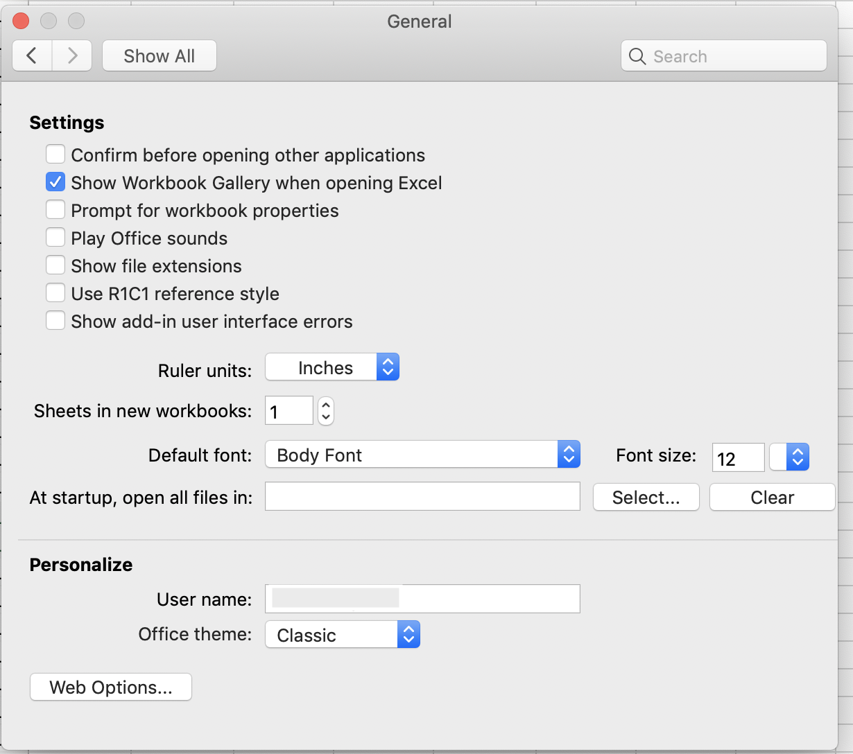

I don't have the "Pen" Option in my Office 😱

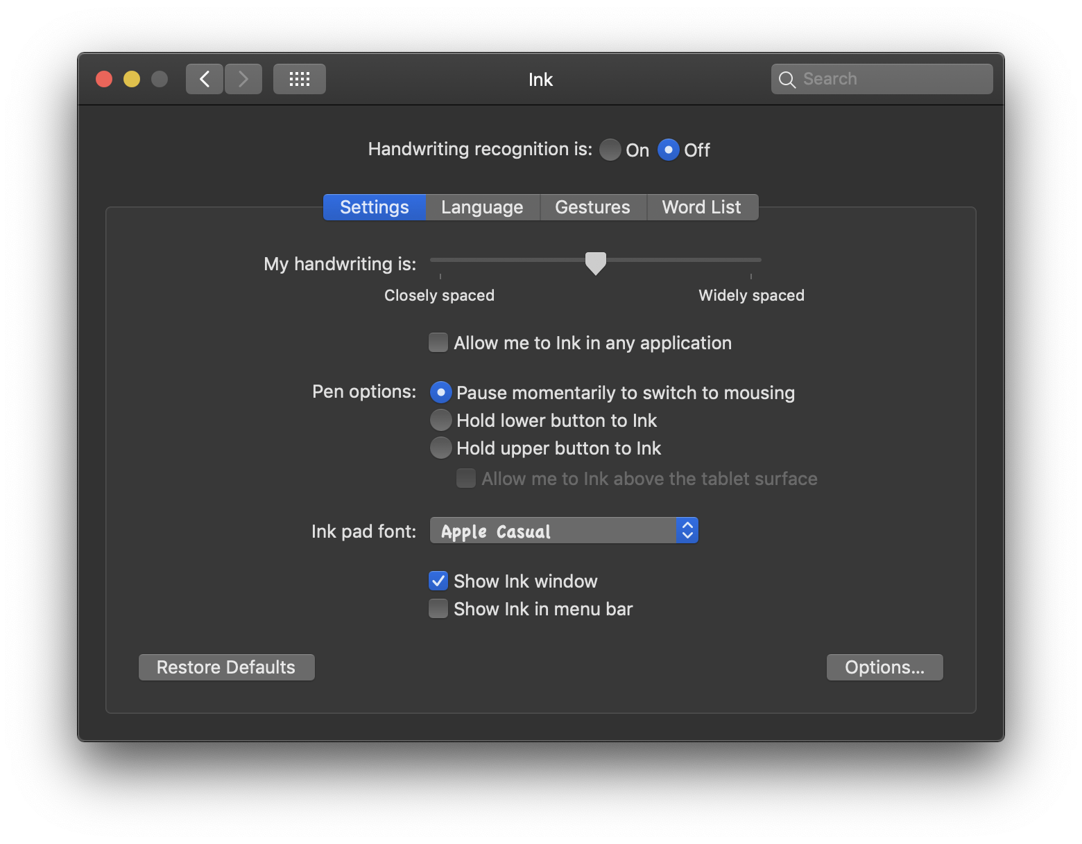

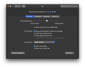

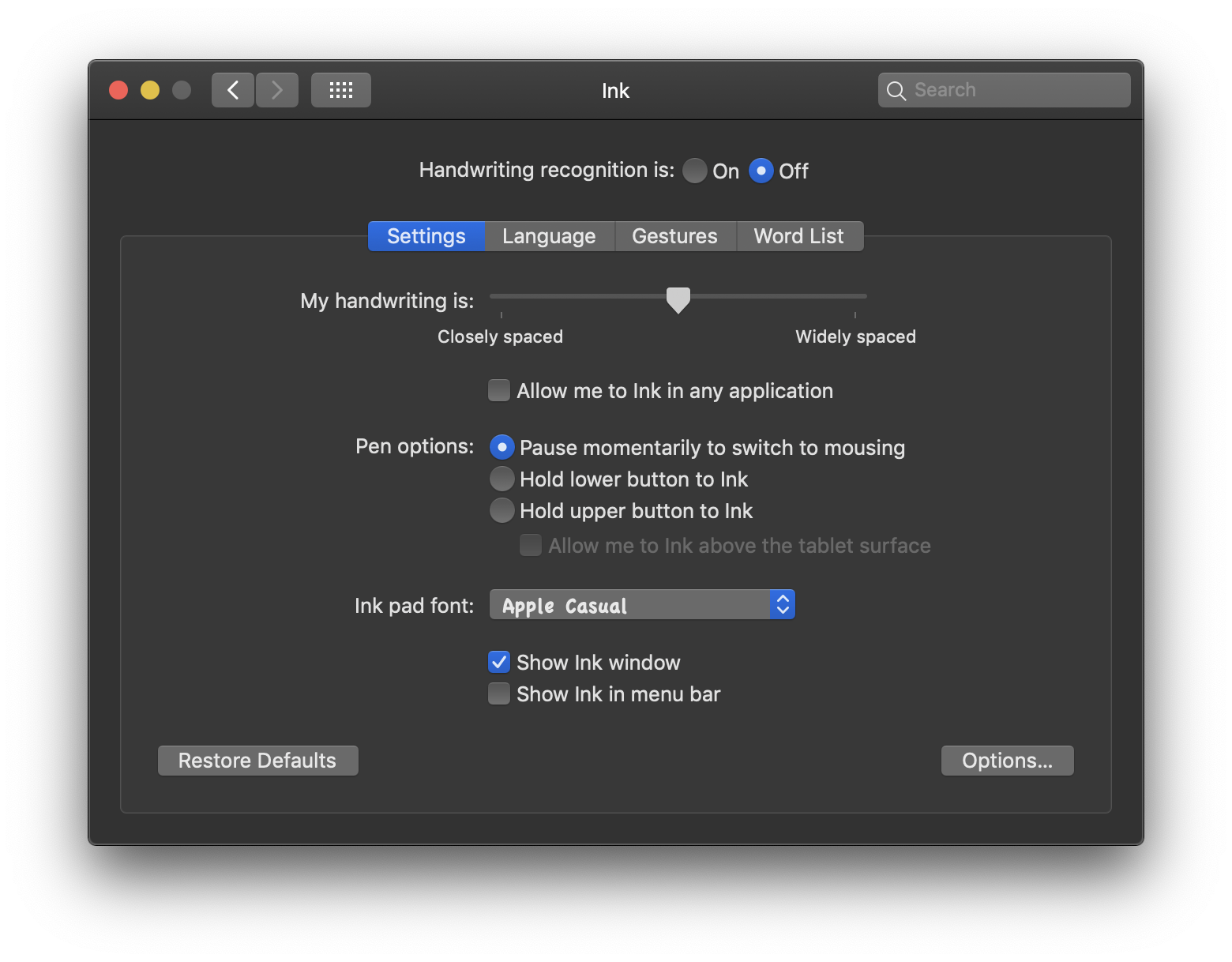

Have you disabled Ink in any application? It's pretty much the same option in Windows, one of the first options I "dis-enable" - it's enabled by default, but I never use it as cool as it sounds. Unchecking that option disables Ink in applications systemwide - I'd offer restarting after unchecking that option just to be on the safe side...
Unfortunately the problem persists, even with Photoshop. This is absolutely unacceptable that a GRAPHICS tablet is not functional with a GRAPHICS software.
