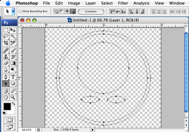

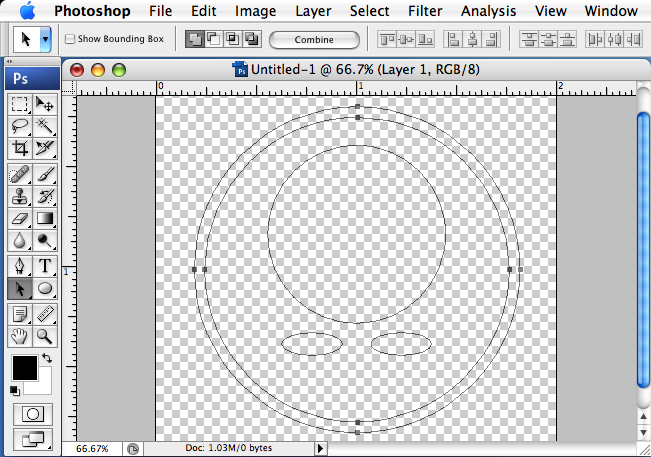

Alternate method in Ps
I suspected the absence of Ai when viewing how complex your Ps paths work was. There is a more tedious method within Ps. Pay attention to the tool options bar as the attachments show. You'll use various path operations to "combine" related elements; then "exclude" some from others.
  1. Highlight Path Selection tool.
  2. Shift-click (3) outermost shapes on path layer.
  3. Select 1st Path operation on options bar ("Add to shape area").
  4. Press "Combine" button on options bar.
  5. On History palette, press camera icon to take snapshot.
  6. Shift-click another group of elements (teeth), repeating steps 3 and 5.
  7. Work your way through, combining remaining related shapes.
  8. Shift-click two of the groups.
  9. Select 4th Path operation on options bar ("Exclude overlapping shape layers").
  10. Thumbnail preview of path layer depicts result.
  11. Press "Combine" button on options bar.
There may be a bit of trial and error to determine how and which groups should be combined. Keep reviewing the thumbnail preview as you go. Saving snapshots of history states will enable you to go back and try another option. (It shouldn't be too bad but you may wish you had Illustrator by the time you're done.)
