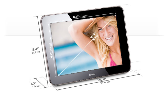

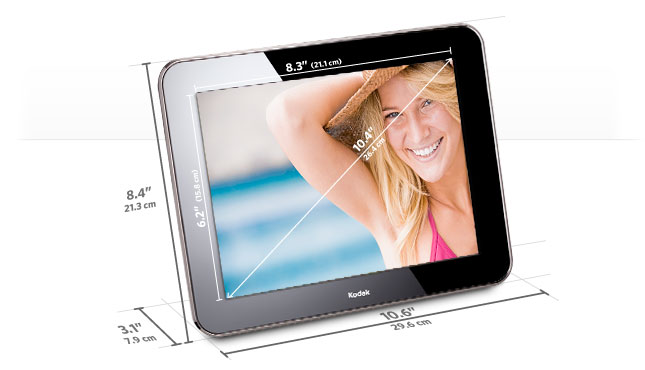

Yah those frames were kinda test guinea pigs and they turned out out to be extremely unsatisfying... My advice would be selling it on eBay or craiglist to someone who wants to use the mother board. However, if you want a quality digital Kodak would e the perfect choice.
