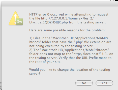

I recently installed MAMP Pro but now I have a problem which I can't solve.
I use Dreamweaver CS3 together with MAMP Pro, and it works fine, when my scripts don't contain any mistakes.
Then I can use the Live data view to see the result.

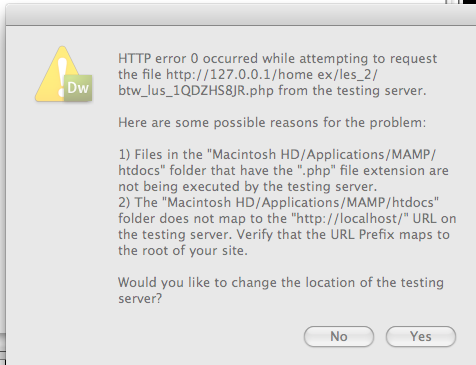

When there is a mistake in the script I don't get an error display, but only this question to change the location of the testing server.(see image)
I know the location of the testing server is correct because the scripts work when they don't contain any mistakes.
In php.ini the error_reporting=E_ALL
and display_errors=on
So I'm out of options.
Any hints?

No the testing server is set up right.
I can use Live data view when the scripts are working.
It must be something else.
Just making an observation the filename it had trouble finding was (guessing) a TEMPORARY file generated by Dreamweaver during browser preview. I based this on the long filename with he odd random characters. If so, I suggest you disable that option, go to the preferences area, preview by browser, uncheck "Preview using temporary file" for all browsers configured for preview.
Besides that, make sure in your test site, the server model is PHP/MySQL since that was also mentioned here.
This is all done in DW.
-jim
-jim

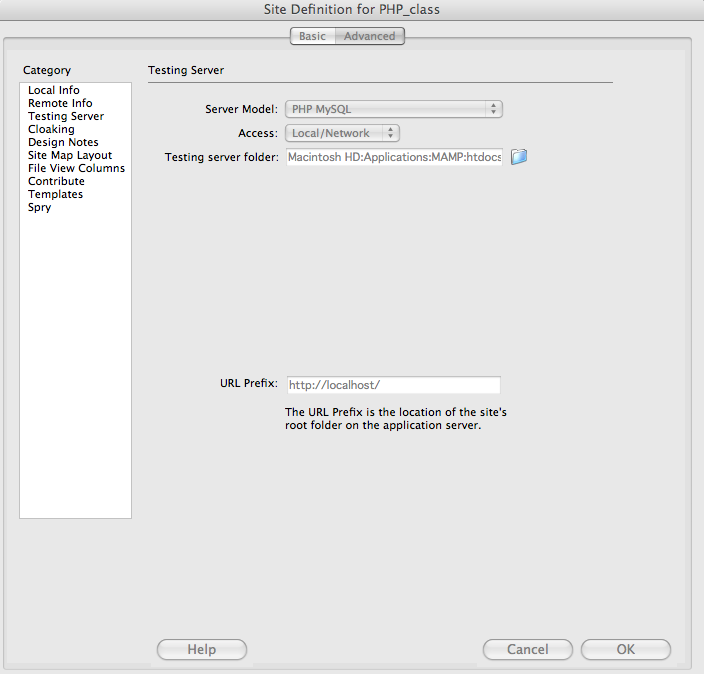

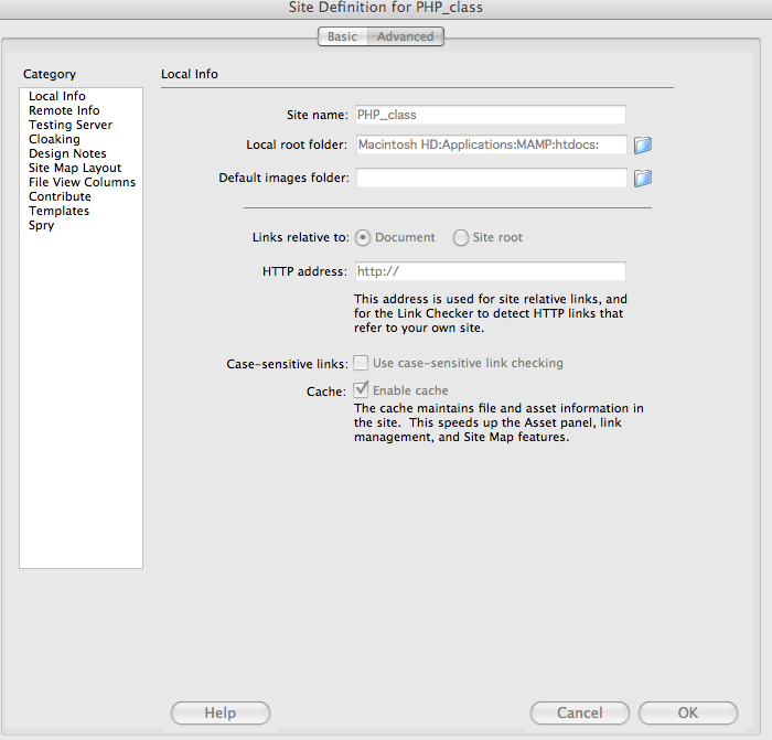

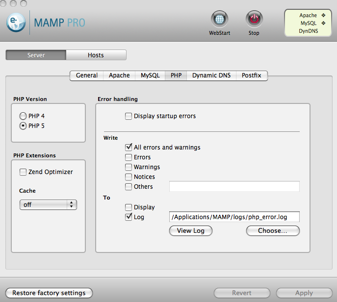

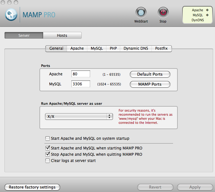

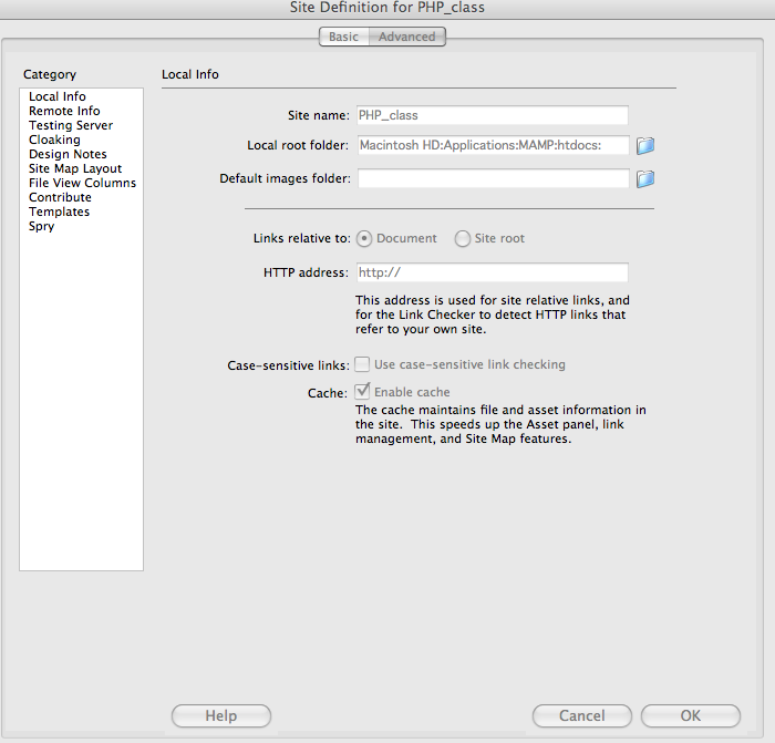

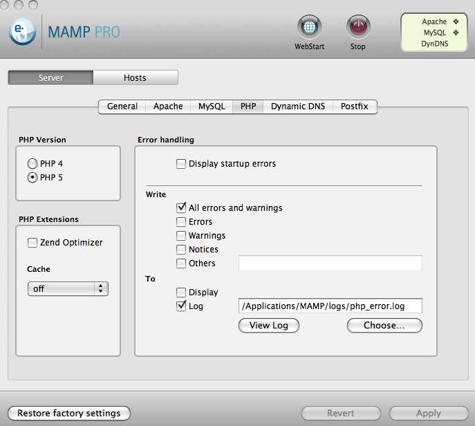

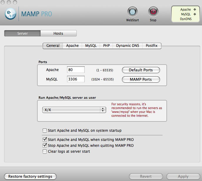

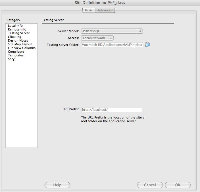

Here are some of my settings in DW and mamp pro
thanks

It's ok, I have found the problem.
I changed the user to www/mysql in the MAMP settings and it worked again.
Where the logic is in that is still a big question for me.

Okay just a few things:
first: remote info should be set to the htdocs folder /the foldername
example: Macintosh HD:Applications:MAMP:htdocs:foldername:
In the testing server you have it set like this: http://localhost which is incorrect
it should be like this: http://localhost:8888/foldername/
for further assistance please view the Video Training Module I did for another website. It will walk you through the complete setup and how to set your testing server properly. It is a step by step video tutorial
http://www.dreamweaverclub.com/vtm/mamp.php
