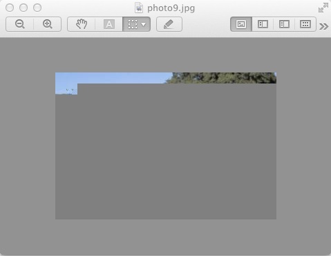

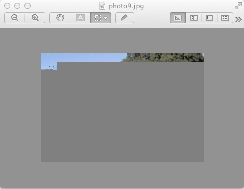

Bump. Still need help with this. Everything works perfectly when I write it locally. I am using a different technique writing everything to a buffer first and then trying to upload it to the server. I get no errors anymore but the data stops writing and my photos look like this attached image I took a screen shot of. I am using a buffer to capture the data and trying to write it out.
What would cause the code to stop writing and think it is finished?
