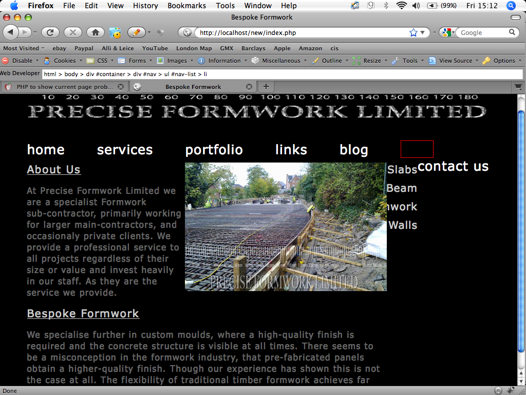

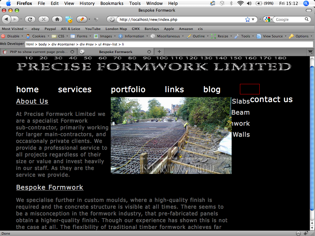

What I think is happening is that my css is not applying the 'class' tag. From my amateur eye my php looks good, it's not showing errors and my page is loading 🙂. However the script is not showing what page we are currently on in the nav bar at the top, and since incorporating the script the final item in my list, which has a class 'no-pad' applied to it - which removes all the padding out of the item and floats it to the right to make the nav-bar seem neat and universal.
Since using this script the nav-bar is ruined and contact us goes on the next line. So it's gotta be an issue of applying class tag. Am I applying it correctly with my script? I have noticed with the developer toolbar that we have an empty list (pictured) <li> but I think this may be the final list item just where it overlaps on next line, I have checked my code and there are no empty li tags.
Can anyone see anything wrong with my code? I can't be trying new methods now as I've spent over a week on this and need to get it done.

Like I said in previous post or two ago, I'm a little concerned that an extra <li> is being inserted but examining my code it doesn't look like it's being inserted. 😕
I recommend using Firebug to see what is up. Go to the tag in question and see what styles are being applied to it and overwritten. This will also let you see the current HTML structure that the page has.
If that doesn't lead you to any results it would help to see your latest code with what you are trying so we can see if there are any other typos.
I can't see nothing sinister in firebug.

The CSS is working, you're just not getting the desired effect you want. The Contact Us bit is ending up a line down. Move the class no-pad to the li element.

		echo '<a href="services.php" class="highlight">services</a>';
	} else {
		echo '<a href="services.php">services</a>';}
echo '</li>';
echo '<li>';
	if ($scriptname == 'portfolio.php') {
		echo '<a href="portfolio.php" class="highlight">portfolio</a>';
	} else {
		echo '<a href="portfolio.php">portfolio</a>';}
echo '</li>';
echo '<li>';
	if ($scriptname == 'links.php') {
		echo '<a href="links.php" class="highlight">links</a>';
	} else {
		echo '<a href="links.php">links</a>';}
echo '</li>';
echo '<li><a href="http://www.preciseformwork.co.uk/wordpress">blog</a></li>';
echo '<li class="no-pad">';
	if ($scriptname == 'contact.php') {
		echo '<a href="contact.php" class="no-pad">contact us</a>';
	} else {
		echo '<a href="contact.php" class="no-pad">contact us</a>';}
echo '</li>';
CSS
HTML:
#nav-list {
position:relative;
padding:0;
margin:0;
#nav-list li{
position:relative;
display:inline;
padding:0 2.5em 0 0;
margin:0;
font-family: "Lucidia Grande", "Lucida Sans Unicode", "Verdana", sans-serif;
font-size: 25px;
#nav-list li a{
text-decoration:none;
color:#FFFFFF;
margin:0;
padding:0;
#nav-list li a:hover{
color:#999999;
#nav-list li a.no-pad {
padding:0;
margin:0;
float:right;
#nav-list .no-pad {
padding:0;
margin:0;
float:right;
#nav-list li a.highlight {
color:#33FFFF;
I think it's related to the first line because the highlight class doesn't get applied to list item.
PHP:
$scriptname = end (explode('/',__FILE__));
I suggested a better way earlier for getting at the file name.
PHP:
$scriptname = basename(__FILE__);
I did try writing basename earlier but had no idea on how to write it. I spent a couple of hours this evening trying to understand it, and various different commands but unless you have an idea of certain components and how they work it's like trying to read japanesse for me 😱.
I have it now exactly how you suggest but it still not highlighting. Thanks for trying though 🙂. Appreciated.
