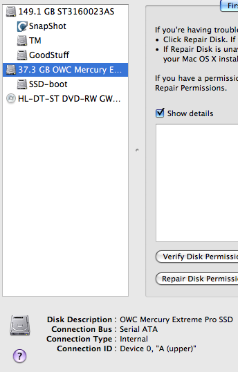

Tried to install Leopard on the SSD drives.
Unfortunately, they don't show up in Disk Utility or the installer.
That's odd, my OWC SSD's work just fine as boot drives in my G5 Quad, and make for a nice reponsive operating system.
Unfortunately, OCZ drives are SATA 3 and though they work on Mac Pro by automatically configuring down to SATA 2, they don't seem to show up for installation on the PowerMac G5.
They do work as storage devices which is great if you need to use it to store pro apps/games/cache drive etc.
