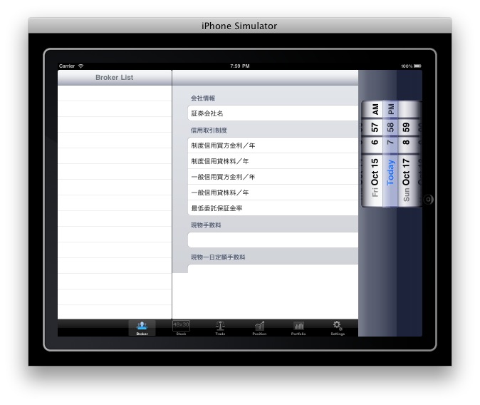

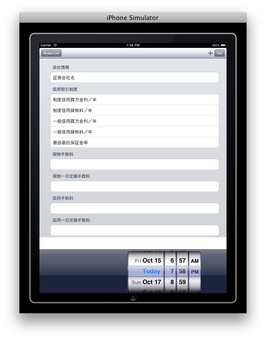

I use code as below to show a PickerView, but is not located at middle of center, then if I rotated, the PickerView is not to rotated, what should I have to implement for tight showing?
Code:
- (void)showPickerView {
    if (pickerView == nil) {
        pickerView = [[UIDatePicker alloc] initWithFrame: CGRectMake(0.0, 0.0, 0.0, 0.0)];
    if (self.pickerView.superview == nil) {
        [self.view.window addSubview: self.pickerView];
        // size up the picker view to our screen and compute the start/end frame origin
        // for our slide up animation compute the start frame
        CGRect screenRect = [[UIScreen mainScreen] applicationFrame];
        CGSize pickerSize = [self.pickerView sizeThatFits:CGSizeZero];
        CGRect startRect = CGRectMake(0.0, screenRect.origin.y + screenRect.size.height, pickerSize.width, pickerSize.height);
        self.pickerView.frame = startRect;
        // compute the end frame
        CGRect pickerRect = CGRectMake(0.0, screenRect.origin.y + screenRect.size.height - pickerSize.height, pickerSize.width, pickerSize.height);
        // start the slide up animation
        [UIView beginAnimations:nil context:NULL];
        [UIView setAnimationDuration:0.3];
        // we need to perform some post operations after the animation is complete
        [UIView setAnimationDelegate:self];
        self.pickerView.frame = pickerRect;
        // shrink the table vertical size to make room for the date picker
        CGRect newFrame = detail.frame;
        newFrame.size.height -= self.pickerView.frame.size.height;
        self.detail.frame = newFrame;
        [UIView commitAnimations];

I knew why PickerView is not at the center of screen, because code as below return a mistake size. I run in Portrait mode, but system gives me a Landscape width. Is this a bug in SDK?
Code:
CGSize pickerSize = [pickerView sizeThatFits:CGSizeZero];
Might be. How does the code behave on the hardware? Have you tried the iOS 4.2 beta?
Regarding centre positioning, set screenRect.size.width as the width in the startRect and pickerRect. (UIDatePicker centres itself within the given rectangle.)
I used code as below to correct miss width. Only in 4.1.
Code:
pickerSize.width = screenRect.size.width;
By the way, do you have any idea for rotation problem?
