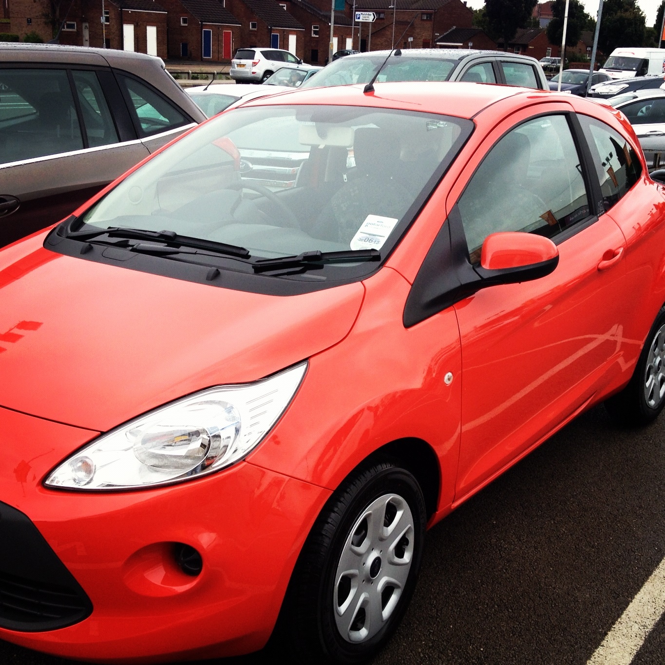

Only had it a couple of weeks. The pics were taken after a full clay.
And this one from the dealer :
Glad to be back to alloys and rear discs.

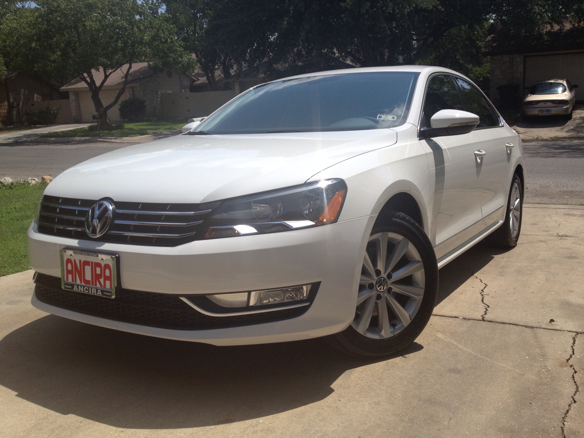

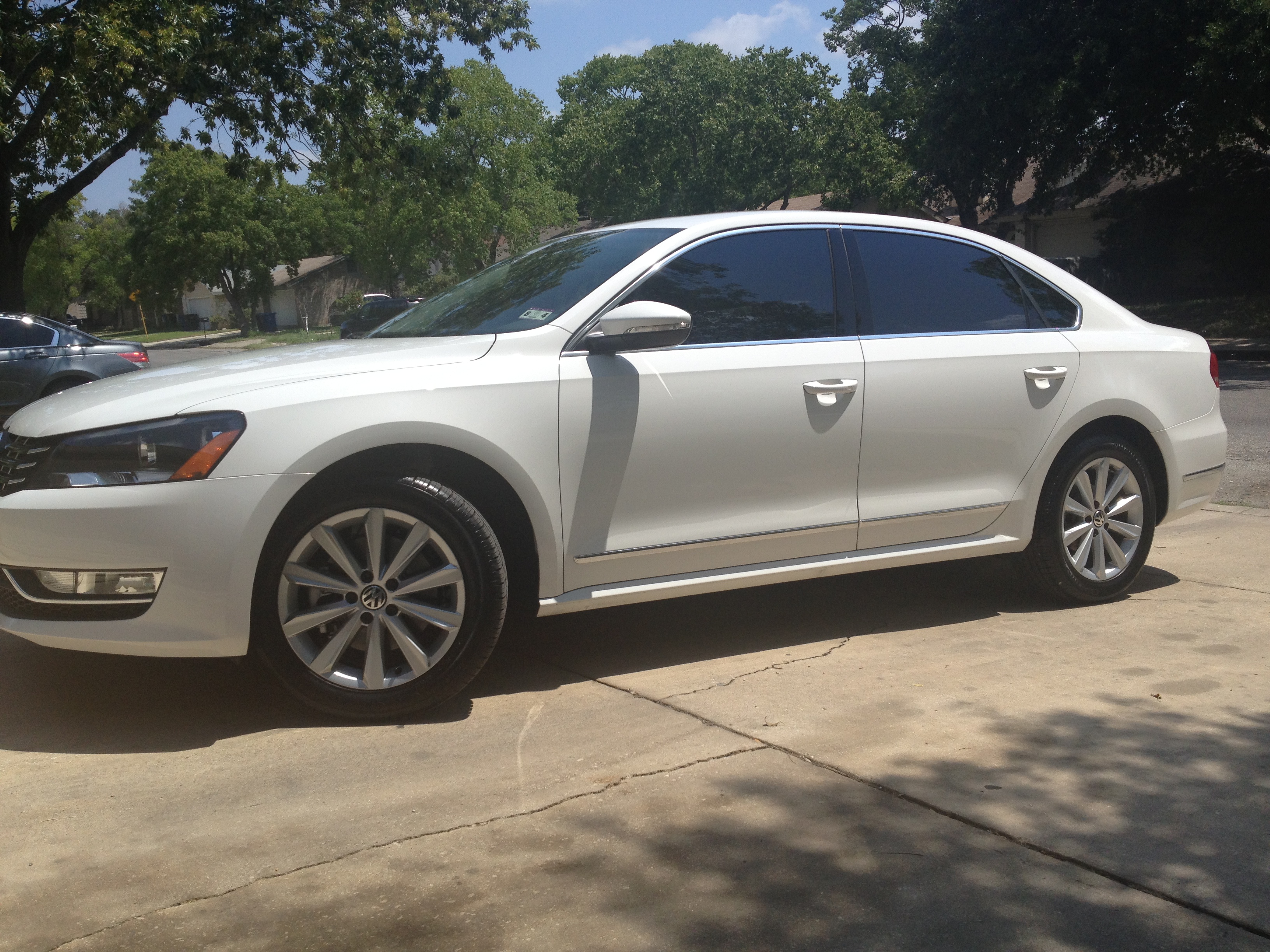

My 2012 Passat SE TDI
I've had it for about a month now. Great car. Getting 45-50 mpg with it on average. Will be handing it off to the wife next year and looking to get an Audi S4.

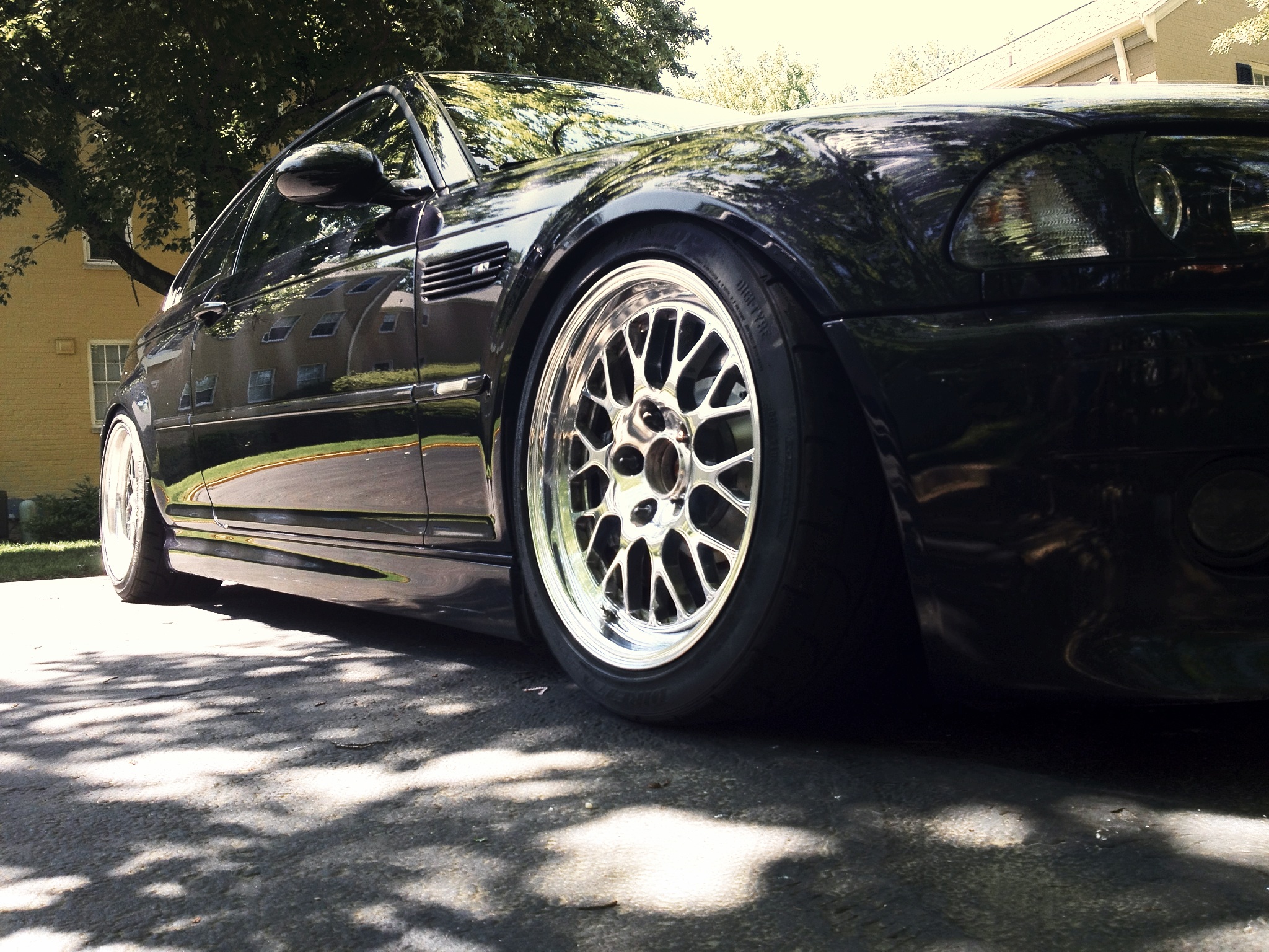

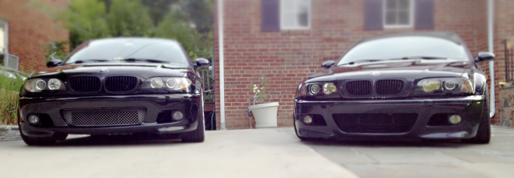

here's two quick iphone pics of my car. One after some quick polishing on the wheels and another after a wash with my buddies 330 on the left

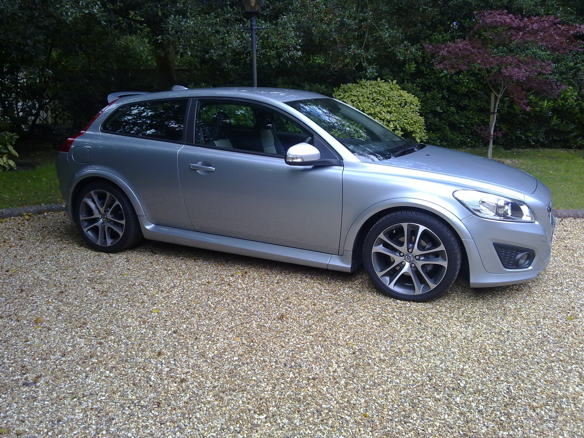

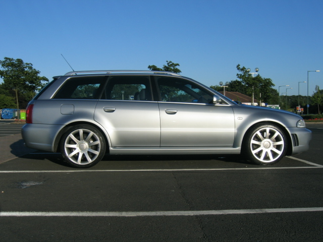

My every day car and weekend bit of fun.
