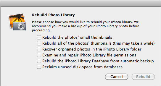

Is your hard disk space running low? How large is your photo database? You could try rebuilding your database file which may speed things up, hold apple and option key when launching iphoto and follow the dialogue to rebuild the database. (make sure to back up the database first 😀)
Hi, thank you for helping. 🙂

Which boxes do I check?
