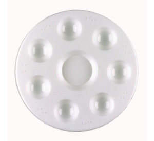

I would suggest using good tools, to help keep the screws in order, I would use plastic paint pallets, like the onle pictured below. Above all, have patinece.
