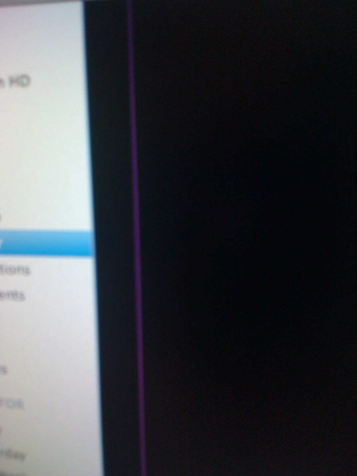

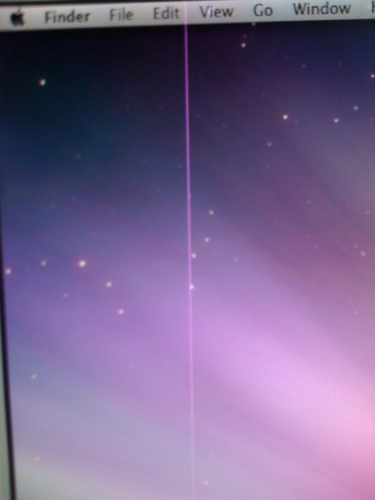

Here are some pictures of my screen...
Yep, that's exactly what I saw on my iMac G5 when it developed this issue. At first the line only appeared at times, then it became constant, and then it was joined by a friend. By that time I'd backed up my stuff and had an appointment booked at my local Apple Store.
It's either a problem on the screen panel or with the cable that links to the panel to the logic board. Either way it isn't going to go away on its own, but the computer will still work whilst its there.
