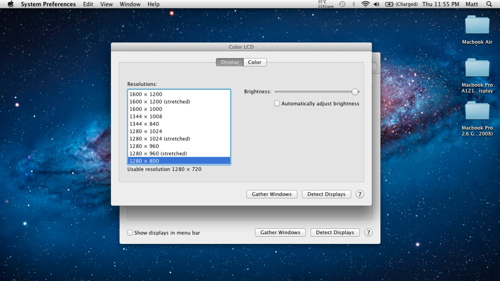

I hooked up to an external display and it gives me issues at anything above 720p. A bit confused as to why that is. I would think I'd have issues at all resolution.
