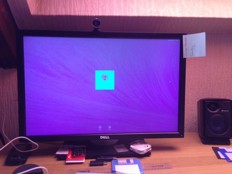

Update on this..
I bought a genuine Apple adapter and everything had been fine up until today when this happened again..

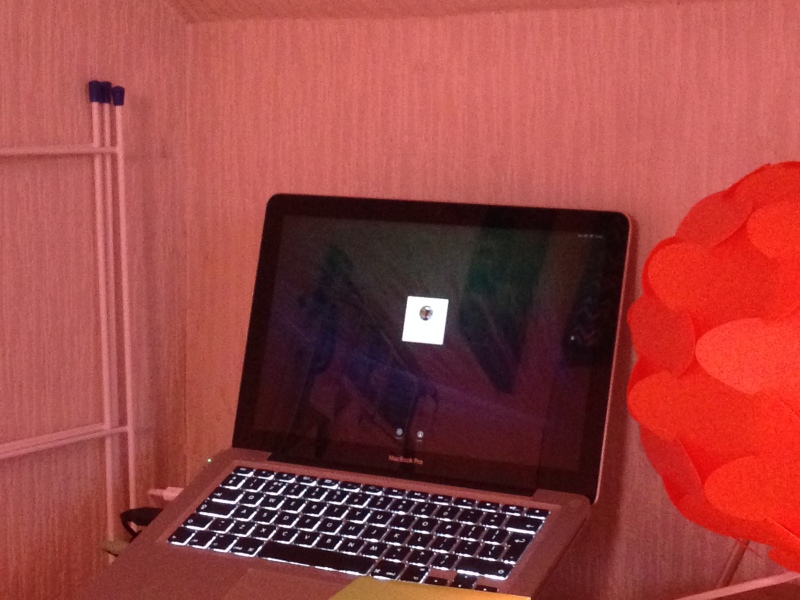

External Display
MBP Screen
