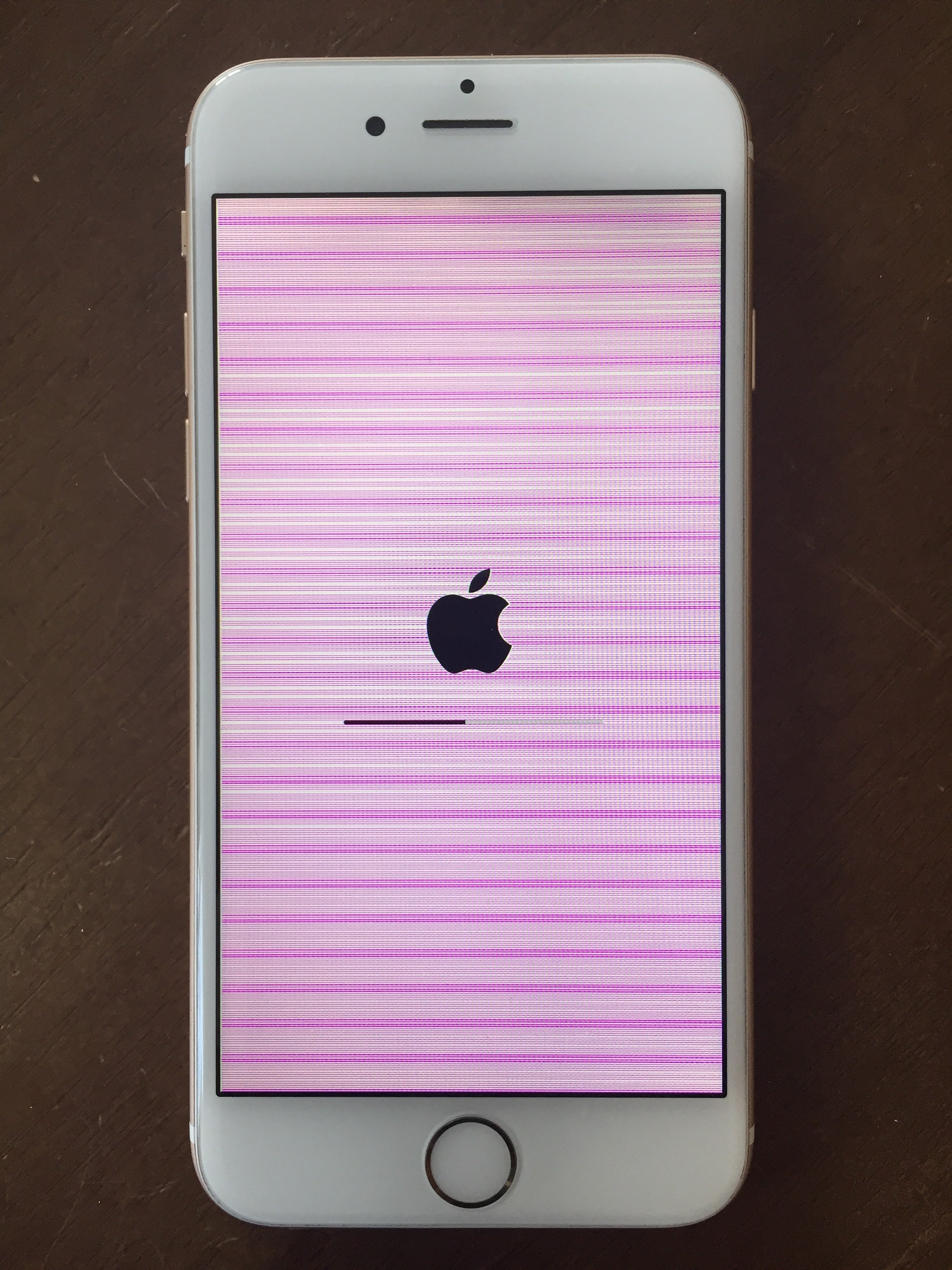

iDAREK macrumors newbie Original poster Sep 2, 2017 #1 Could somebody advise me about an issue that have. From time to time, now everyday got red stripes on my screen. Phone not fall down or been water damaged. See picture attached. Attachments IMG_7165.JPG 1.4 MB · Views: 165

jr866gooner macrumors 68020 Sep 2, 2017 #2 That's likely to be the ribbon cable that carries the image to the screen. Apple Store visit best bet to diagnose further.

iDAREK macrumors newbie Original poster Sep 2, 2017 #3 Think that may be the case, as sometimes screen not turning on at all and when I press it hard on centre on top (in possible place where LCD connector is) it is turning on. Thanks. Reactions: jr866gooner
