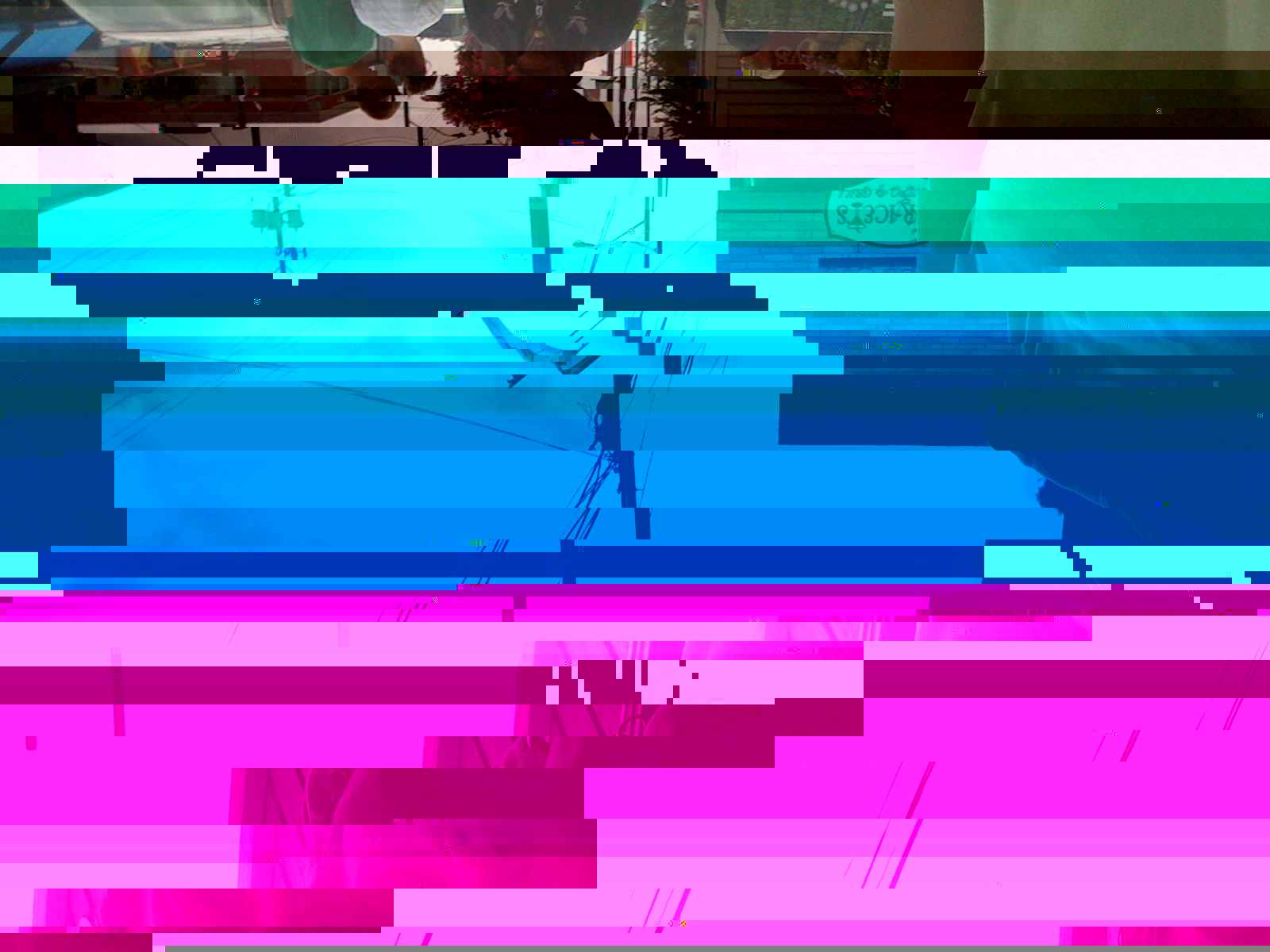

Did a search on the forum here, but couldn't find anyone having the same problems I am having.
When I download files from my cameras, usb or firewire card readers to my G5, I occasionally get photos pixellated and distorted. Lately the problem has got a lot worse. To the point where I can't use the G5 to make any photo adjustments. Sometimes the photo will download correctly, and when I hover over a file in the finder, the small version/icon appears that the photo is ok, however, when I open it up in any photo program (CS3, iphoto, Aperture, etc) the photos come out pixellated. Sometimes is it very subtle and others is drastic. I've tried connecting the cameras/reader to different port on the front and rear, same issues arise.
At this point I'm thinking it has something to do with my video card, but I have no idea where to start to trouble shoot it.
My G5 is a dual 1.8, with 8gb Ram.

Do you have another computer you can try to upload them to? Does it do the same thing to them? It looks like the jpeg files are corrupted. Maybe the files are not transferring properly?
When I use my powerbook to load photos, I get zero problems. I can load them to a portable drive that I share with the G5, and they appear fine on the PB. Then when I view them on the G5, bam! the pixellated photos start appearing again. So I know the problem lies on the G5 and not my camera or card readers or PB.
Then something is messing up or corrupting those files. Might be more of a software issure more then a hardware issue. If it was your video card then it shouldn't effect the file itself, just how it might display on your monitor. Can you transfer those "pixelated" pictures to your PB to see if they are still corrupted or displaying properly on another machine?
Thanks, but that picture I uploaded with this post was sent from my MB (I copied the file over from the G5.... So anything that gets messed up with the G5 stays that way. It corrupts the file permanently.
I'm at a loss where to go from here.

Well I solved the problem.. sort of.... my daughters' PC died so she inherited the G5.. I bought a new 24"imac. Have zero problems with photos now. I gave up trying to find out what the problem was. I had heard everything from bad firewire/usb cable (it was not.. I tried 5 or 6 different ones.. and this was the answer the local mac repair depot came up with after a week of diagnostics) to a faulty motherboard (which wouldn't be cost effective to replace due to the age of machine) or a faulty graphics card (tried that, same results). So the lesson I learned here was to buy the extended warranty if you are going to buy the high-end $$$$ machine and let apple repair it or buy the imac and be prepared to replace it in 3 or 4 yrs.
I think it would have to be a bus issue with the AGP controller, which means video card or the motherboard is going.
I like your solution though!! 😀 Grats on the new iMac.
