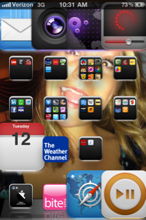

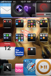

Jailbroke my phone successfully this time...Now I'm working on my customizing my own theme using different icons and what not from what other people have posted.

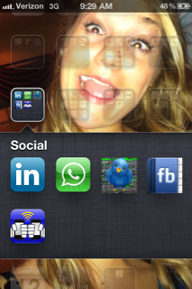

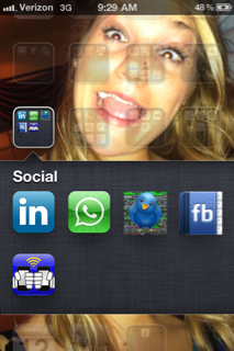

I managed to set it up with the custom icons via Fugu and OpenSSH. My first problem was the icons were HUGE! But then I resized (59x60, read that number somewhere. ?) them via iPhoto and set em up.
Now my problem is the icons are pixelated and there are some random colors and odd pixelation around the icons.
(In the photos around the Twitter icon and the phone icon, excuse the crazy girl in the background)
Is my sizing wrong? Or is there a way to clean up the space around the icons so they are transparent? New to this, so any advice in layman's terms would be great!

You have 59x60 icons so I'm assuming you're using an iPhone 3G/3GS? From the looks of it, whenever you tried resizing the icons, there must have been some error either with the cropping or whenever you saved the icon in it's newer size. Need to make sure they're saved as PNG's whenever you save them and I'm also assuming you're trying to downsize iPhone 4 icons to fit on your phone right? Best bet would be to get an actual theme/icons made for your 3G/S and use those. Also might want to use pixlr.com as it's pretty easy to use for whenever you're resizing icons.

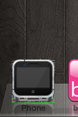

When I first viewed the icons they were saved at 120x120, which is why they were HUGE! Here is what they looked like (different icons/theme) before I resized them.
The icons look very nice, just too large for my screen. How should I resize them, or save them in Fugu for the 4?
^^ Yeah, check that. iPhone 4 icons should be 118x120 or 120x120 depending on the icon(s). 59x60 res icons are for iPhone 3G/3GS only. Looks like you may have replaced the wrong icon which is why you're getting that big icon look. Are you using the bundles method to change icons or no?

might as well also see if anyone knows how to change the wallpaper that is in the background when a folder opens....in the pictures above, the "crazy" girl, change it to either blank or the same as the wooden wallpaper.
What file it is, or how to go about changing it.

So I solved the problem of the pixelated icons, just as you said name the icons icon@2x.png or whatever they were originally.
Now is there anyway to change the wallpaper that is in the background when a folder opens up?
