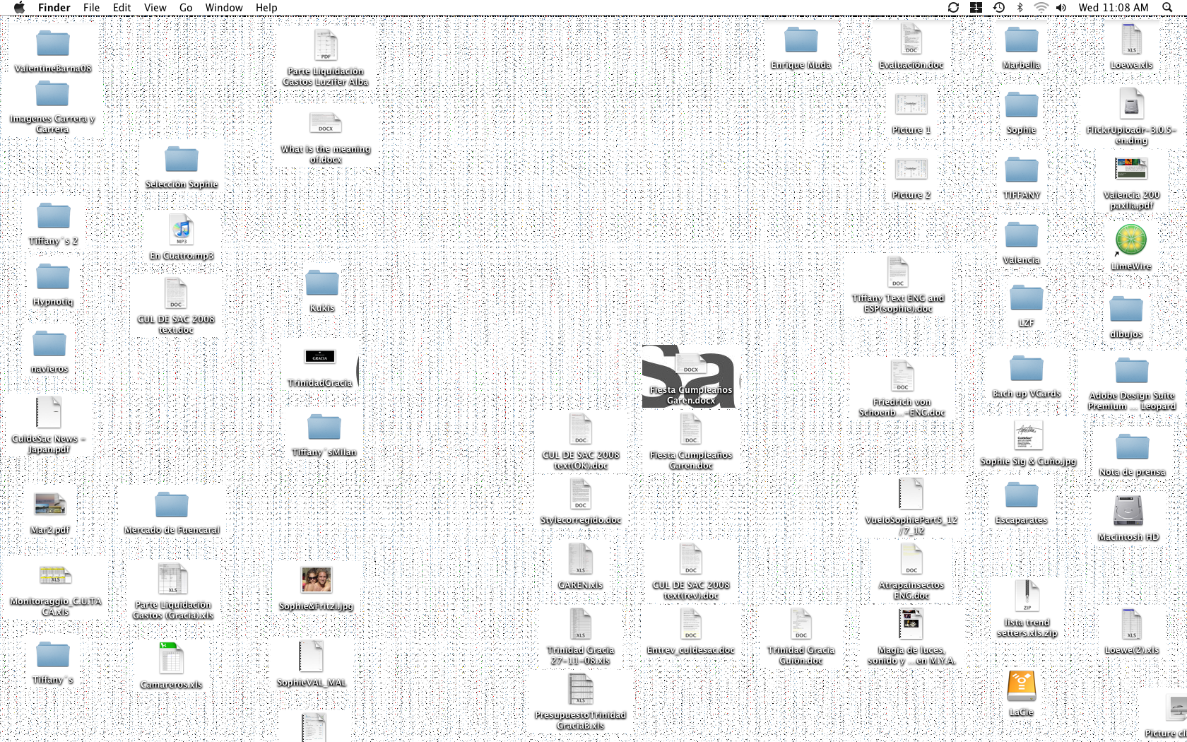

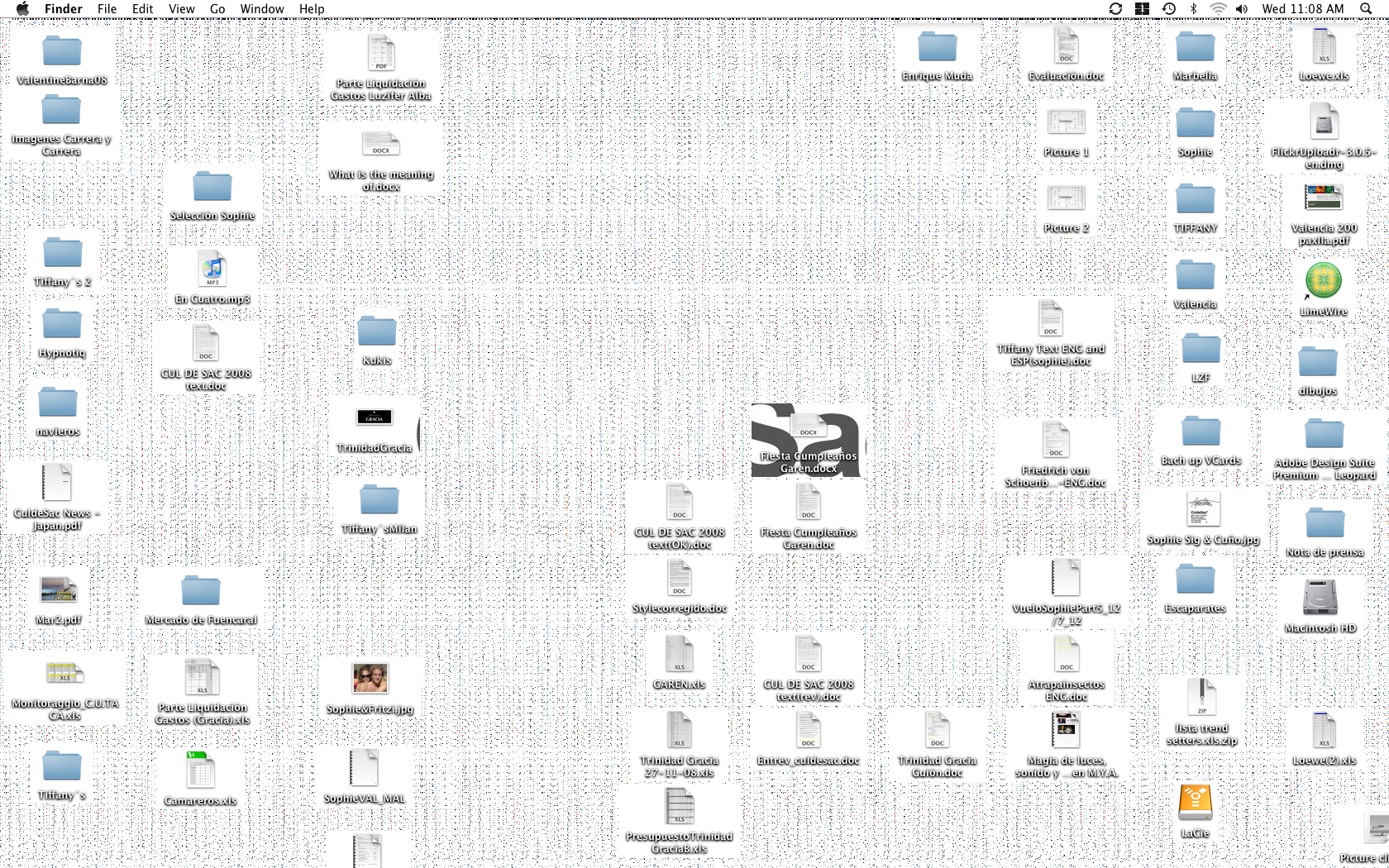

Screen Capture Pixelated Screen at Start Up OSX10.5.4
This is the image I get on my iMac 2.4 GHz Intel Core Duo OSX10.5.4. I have repaired permisions and removed all login items. Once I move the cursor or open up a window the screen clears behind the cursor or window etc...Any suggestions? It freezes up at least once or twice a day...
