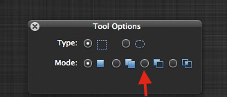

Yes you should, although weirdly, I've never run across that Tool Options palette before. What happens if you select this button (below)? I always see that in my menu bar but didn't realize it detached. FWIW, when I have a selection over a rastered layer and delete, it deletes.
Those buttons modify the selection tool. The particular one you indicated is for subtracting from your existing selection, and will have no detrimental effect on the OP's original problem.
