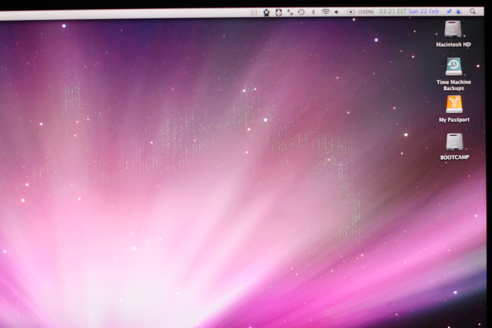

I just received my unibody 17-inch MBP Friday. After I switched to the discrete graphics card I stared to get lines of green pixels flickering on the screen. I have tried logging out and back in. I tried switching between graphics cards. The 9400 works fine but as soon as i switch back to the 9600 the flickering pixels come back. Restarting helps but they come back. 🙁 I have all the updates loaded. Does anyone else have this problem? Please look at the picture and let me know what you think.
This computer was a replacement for a broken late-2008 MBP. I'd hate to have to send this one back too.

I think you need to call Apple ASAP.
I think so too. I just emailed the case manager (who got me this computer)
with the same information posted above and the picture. If no one else is having this problem I can't assume it's a driver issue.
I'll keep posting what happens here in case anyone else runs into this problem.
Looks like a broken connection, but could be a faulty logic board, does it happen on both graphics cards? the 9400 or when your using the 9600?
Get the laptop replaced since its obviously less than 14 days old and your entitled to that, dont settle for a repair, you want to whole machine replaced, yes it may take a bit longer because their arnt many around but you should get the first one to hit the stores and it will be much better for you if you have a duff laptop.
Looks like the 9600GT discrete chip is flaky. Have it changed. The problem with Apple's so called "zero QC" rule is that these things happen. Even if I got a refurb with this, I will return it. You paid for all the components in there and expect them to function properly to specifications, or else ...you will keep returning until they got it right period.🙁
It only happens with the 9600.
You are all right. The computer is less than 2 days old and although I had to wait over a month to get it I shouldn't settle for a repair. I'd rather wait for another brand new one than have this one fixed. I'll keep you posted.
This is terrible news, this seems like the 30" acd's dancing pixel issue. With the 30" acd no one knows why to this day because the dancing pixels occur with different gpus installed as well.
But in this case it's only with the 9600m gt card, maybe it's defective but hopefully most 17" doesn't have this issue because it would be a pita to wait for a software update as apple takes forever to address issues via software.

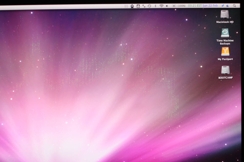

I have a similar problem:
When I change from 9400 to 9600, it sometimes happens (3-4 out of 10, I think). I just change back to 9400 and then change to 9600 again. It will be fine.
I think it is a driver issue and will wait for a while (it is covered by one year warranty, and if it is a hardware problem, I would replace it later)

The flickering problem only seems to happen when the computer is warm. I just recreated the problem and it was just warm. Not even very warm like it gets after I have been using the proccessor and/or superdrive a lot. For example, loading programs. That is what I was doing when the flickering occured both times. But once it starts it does not go away.
Also, It happens under both OS X and Windows Vista 64-bit.
The problem is intermittent. How is Apple with intermittent problems? What if their techs can't recreate the problem? Will they just try to send this computer back to me? Or will they accept my photo as proof of the problem?
I can't get ahold of my original case manager until Thursday at the earliest (he is out until then) and I don't want to start over with Applecare because I am worried that they will just return this malfunctioning computer to me. 🙁
This sucks. It is a beautiful computer. I just wish I didn't end up with another dud. :-/
Whether or not it's intermittent, you have a picture of it. Use that picture to your advantage and don't settle with Apple saying that the computer passed their test. This is obviously not a characteristic that one expects from a $300 laptop let alone a $3000 laptop.
Hope you get it replaced.
Apple is replacing my computer.
Apple is replacing my computer with a new one. It wasn't difficult to get them to agree that it was a hardware issue. Just as all of you said it was. Thanks for all the help, BTW!
At least this time it shouldn't take more than 2 weeks to get my new laptop. I wish mine being broken would give me head of the line privledges. 🙁
