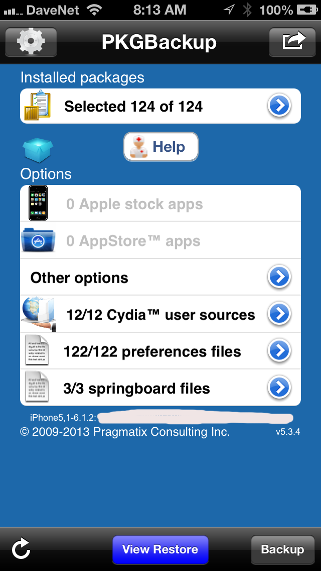

Well I have done some more reading on PKGBackup and noticed that under the options part, I am not
able to select the 1st 2 options only the 3 under other options. I guess that that is correct because I
guess there is no reason to backup Apple Stock Apps and Appstore Apps. That gets done with my backup
in Itunes. So I guess everything is running normal again. Not really keen at the moment to test that the
restore works but I guess to really trust a backup is to test the restore live and not just assume that it
willl work.
Anyway, thanks to the above for some insight/tips. (Especially not being able to JB 6.1.3)
Correct, the first 2 categories cannot be selected.

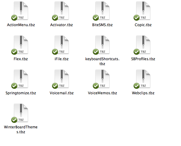

I use the DropBox save option, the data is saved as .tbz files.

That is strange then. I only get the PDF file nothing else. As I mentioned earlier
I got a bunch of files before together with the PDF file.

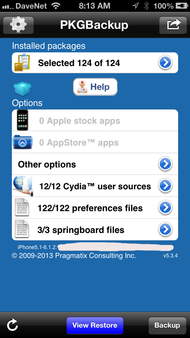

My PKGbackup crashes when I first launch it as well. Reinstalled/ REbooted, same problem. I can see a message flash very quick that a backup. Here is a perfectly timed screen shot. (only lasts like 1 second)
I went into the regular iPhone settings, found PKGbackup and turned off Auto Backup. That let me back in.
I still sent the crash report to the Dev
