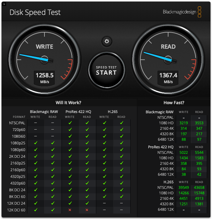

I put a 2TB rocket Q in my 2015 13" it didn't make it faster but I have a lot more storage. I get about 1300 R/W's

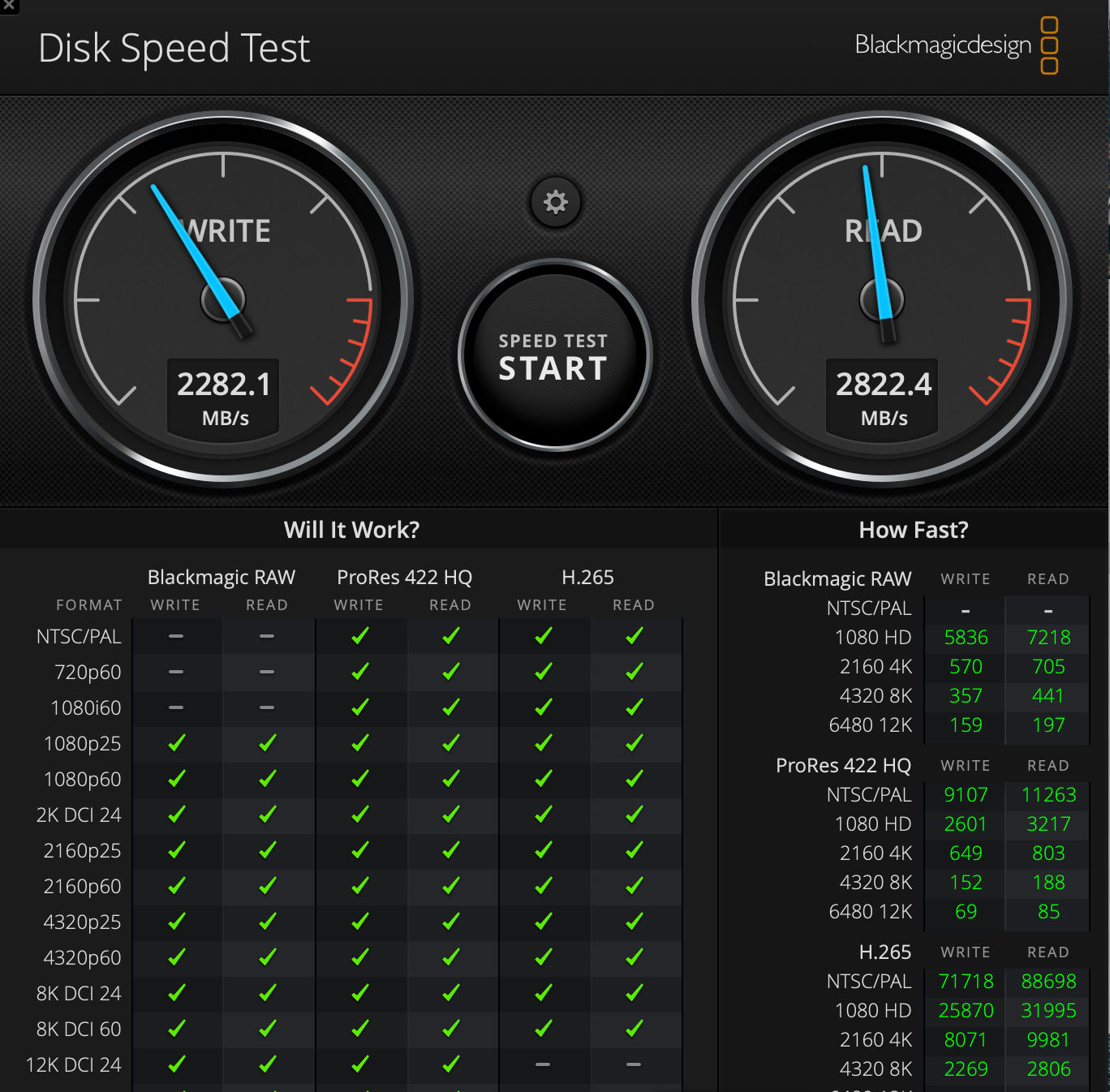

Update :
Finally I have upgraded my 128gb SSD to new Samsung 970 EVO Plus 1TB in use along side the Sintech adapter. SSD performance has improved alot with greater Read/Write speeds.
I also changed battery with new one. Only downgrade is that I can no longer update from MAC OS Monterey on my MBP 2015 model. still i will keep this machine for next 18 - 24 months
