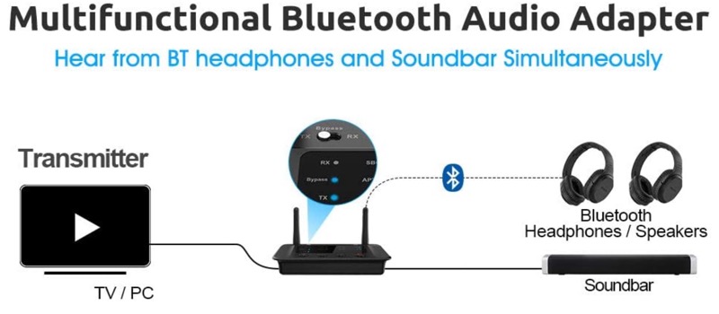

I'm guessing this want is best resolved at the "optical splitter" link in the chain. It appears now you need a new splitter that can still send an optical out to the soundbar but also bluetooth to the wireless headphones. That probably exists and could keep it all in one "dongle" box. For example, this looks like it could do the job within a single (replacement) box. One of the connection images shows exactly that: bluetooth headphones and soundbar under the word "simultaneously..."
Else, add a device to the existing splitter taking an optical out of that box into an optical IN on a box that will then "toss" the sound via Bluetooth to the headphones. This looks like it might do that. And there are many others. Seach for Toslink bluetooth transmitter.

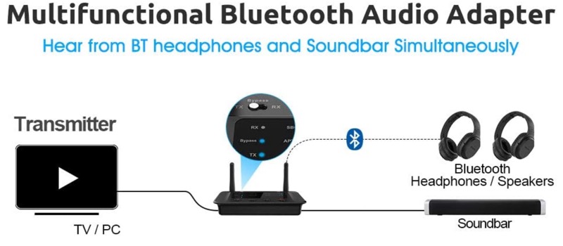

Interesting options, thank you. I’m guessing if the Apple TV isn’t connected by direct Bluetooth to the AirPods Max that you lose spacial audio. Not necessarily a deal breaker, and this would address the issue. I may have some thinking to do.
