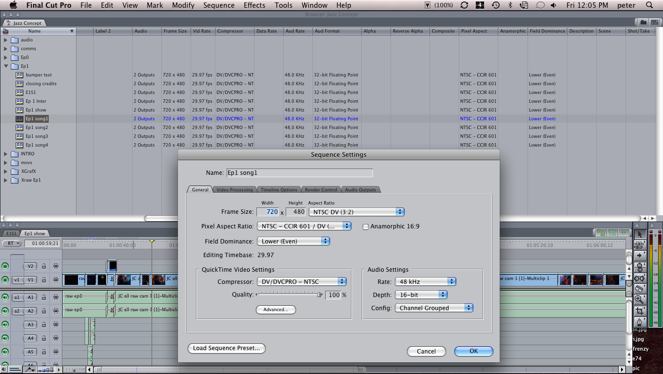

Can you take a screen shot of your sequence settings and a screen shot of your Browser window showing the columns for codec, frame rate, etc., of the clips you are using?
720x480 implies DV or DV50 and that stuff can be played back by an 8yr old G4 so your machine shouldn't have any problems... assuming everything is properly setup.

I don't recall this many problems before. I thought it was because of the big monitor. Is that possible? I did get a warning about the monitor when I first opened FCP. I also have the clips stored on a new internal HD. I'll try to edit with something not on that drive. As far as cuts, filters, effects etc. NO. Barely any! Picture 1.png
