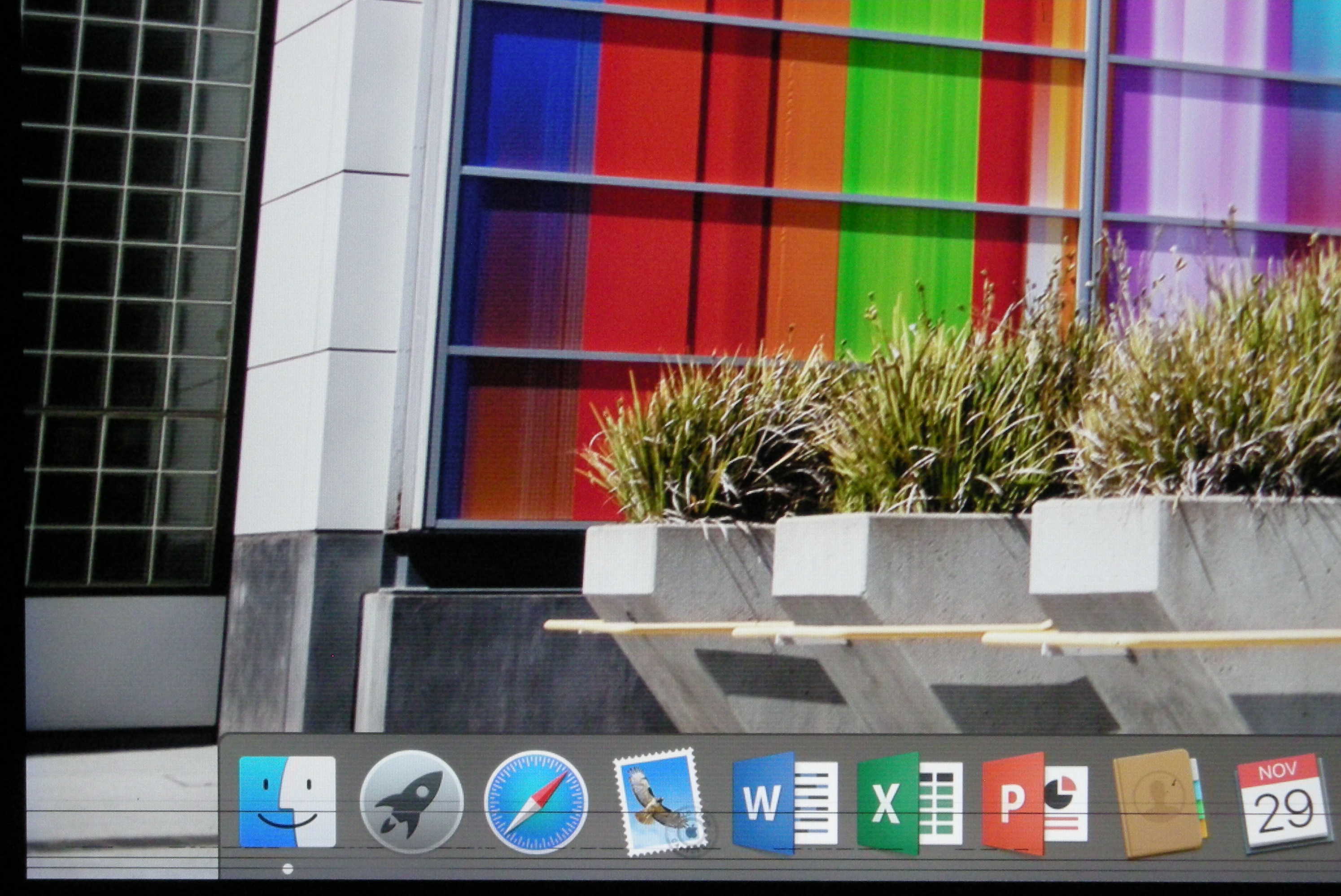

There are a number of horizontal lines right at the bottom of the screen (over the dock essentially), like lines of bad pixels.

It would help if you could post a picture of the issue you're seeing. If the image looks good on an external display, its possible that it is not related to the GPU or logic board.
Thank you T5BRICK, that was my thinking too.
I will upload an image very shortly, cheers.
That's about as good as I can capture it guys, hope it may help with the solution.
Thanks once again.
That's really odd. I've seen lines across the screen before, but they're typically solid, unbroken lines. I'm still suspecting that the screen itself is the problem here. Hopefully Apple can diagnose it quickly and fix it for you.
