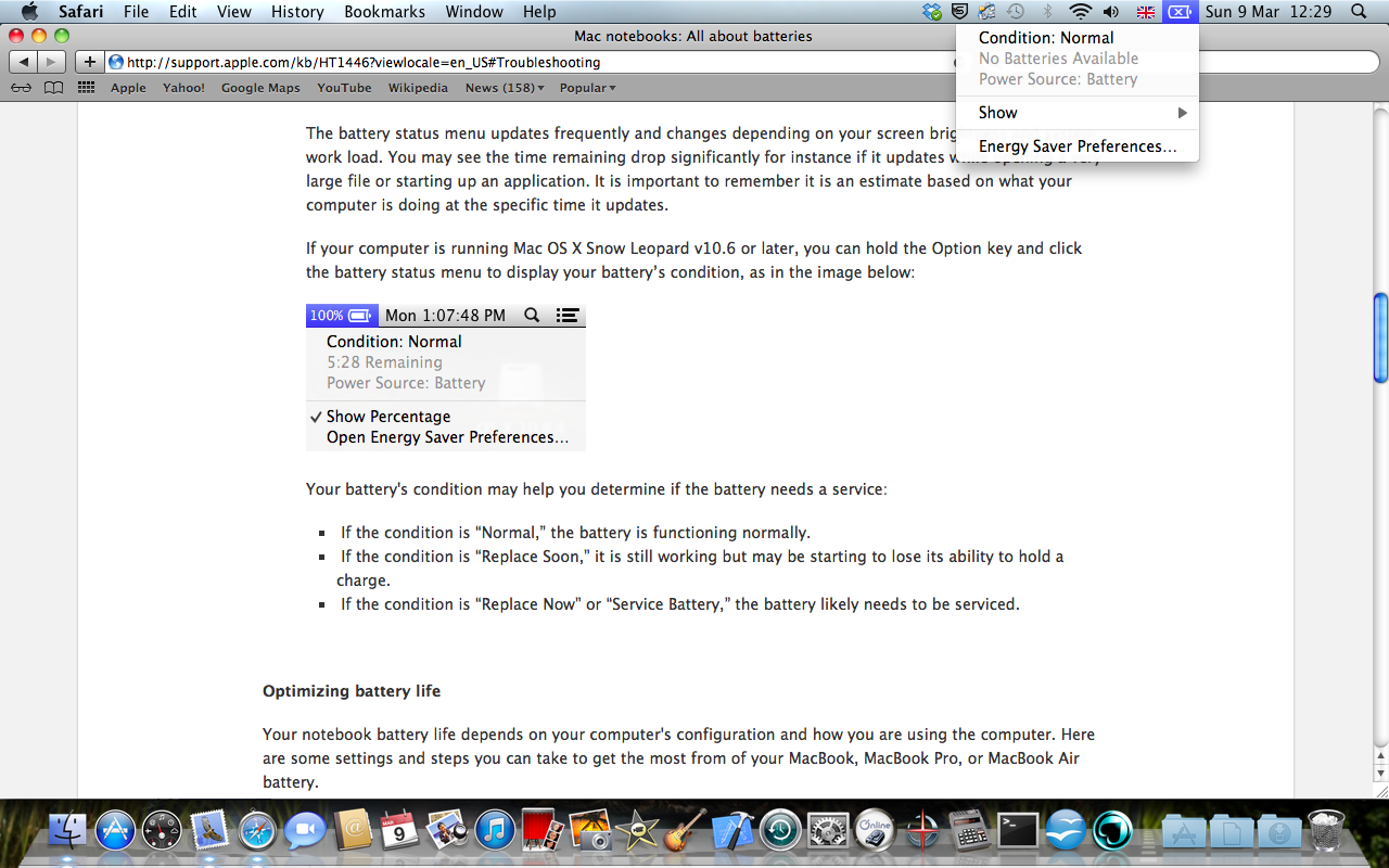

In addition, I pressed alt and clicked the batttery [X] icon and it showed this (screenshot below). How can my battery's condition be "Normal" and yet the battery is not recognised? I don't want to pay for a new battery only to discover that the battery is fine and there is some other problem. Any assistance would be much appreciated.

... How can my battery's condition be "Normal" and yet the battery is not recognised? I don't want to pay for a new battery only to discover that the battery is fine and there is some other problem. Any assistance would be much appreciated...
I think the important points are: condition normal, BUT no battery is available.
