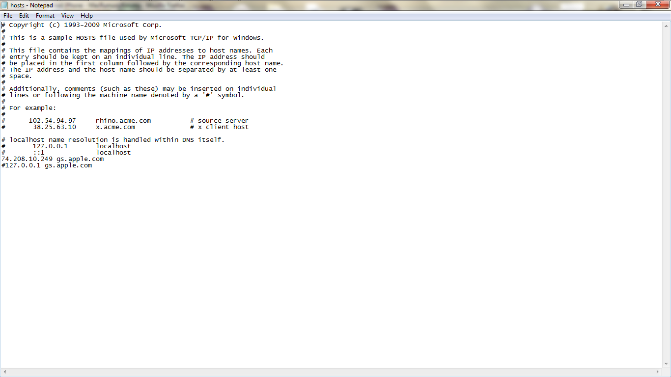

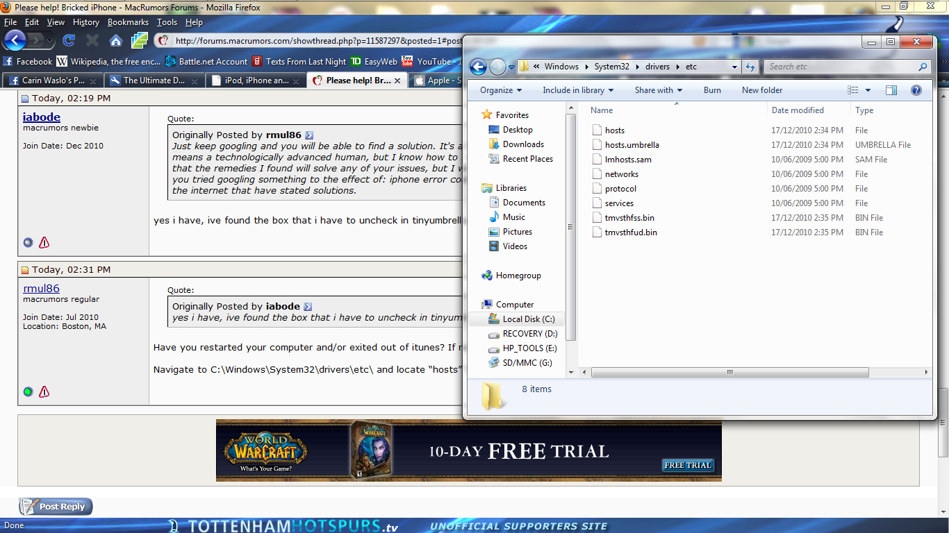

Have you restarted your computer and/or exited out of itunes? If not send me over a screen shot of your host file from this location on your computer:
Navigate to C:\Windows\System32\drivers\etc\ and locate “hosts” file.

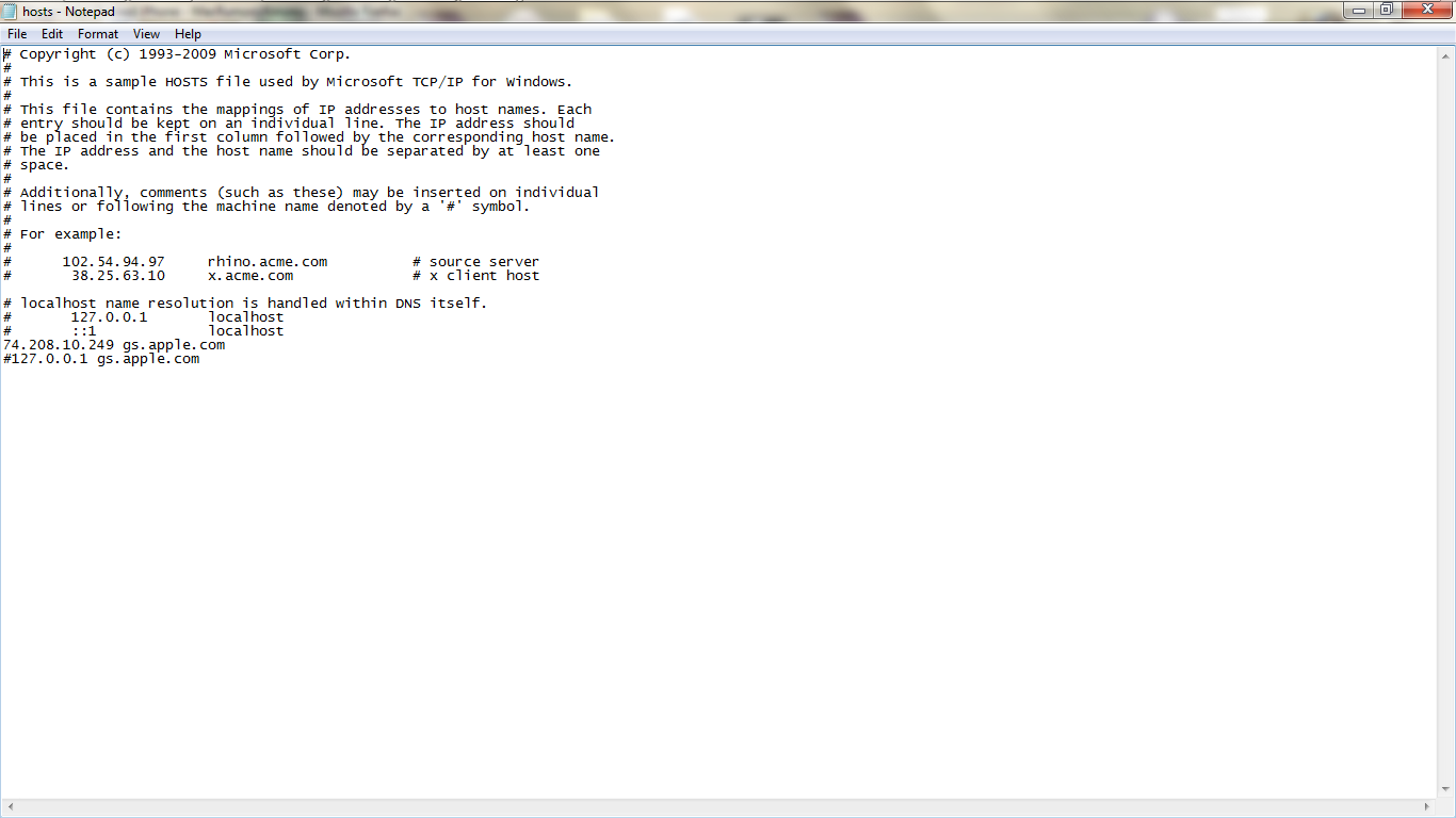

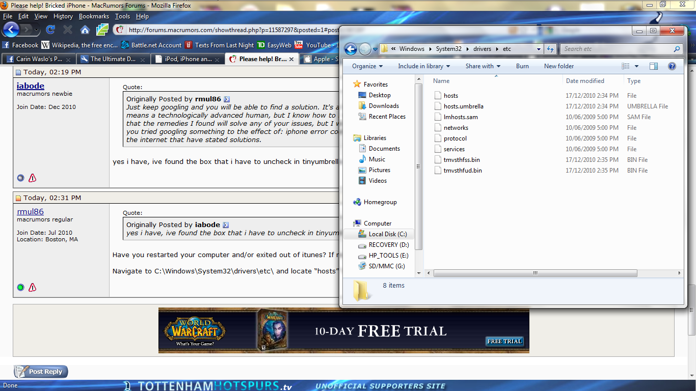

here is the picture

When I had an error code: 10something, the hosts file fix worked. but the hosts file you showed me was different which leads me to believe I gave you the wrong file path.

I had the same problem with my wifes iPhone 4 a while back, we were trying to update from 4.1 jail broken to 4.2 unjailbroken.
Your problem is the last line in your host file, (or at least that was my problem) tiny umbrella puts that line in the host file so that iTunes checks with it, or cydia on a restore to verify that the firmware is good.
You need to open the host file as an administrator, delete that line, save it. Then open iTunes and restore.
Every time you open TU, it puts that line back in the host file.
