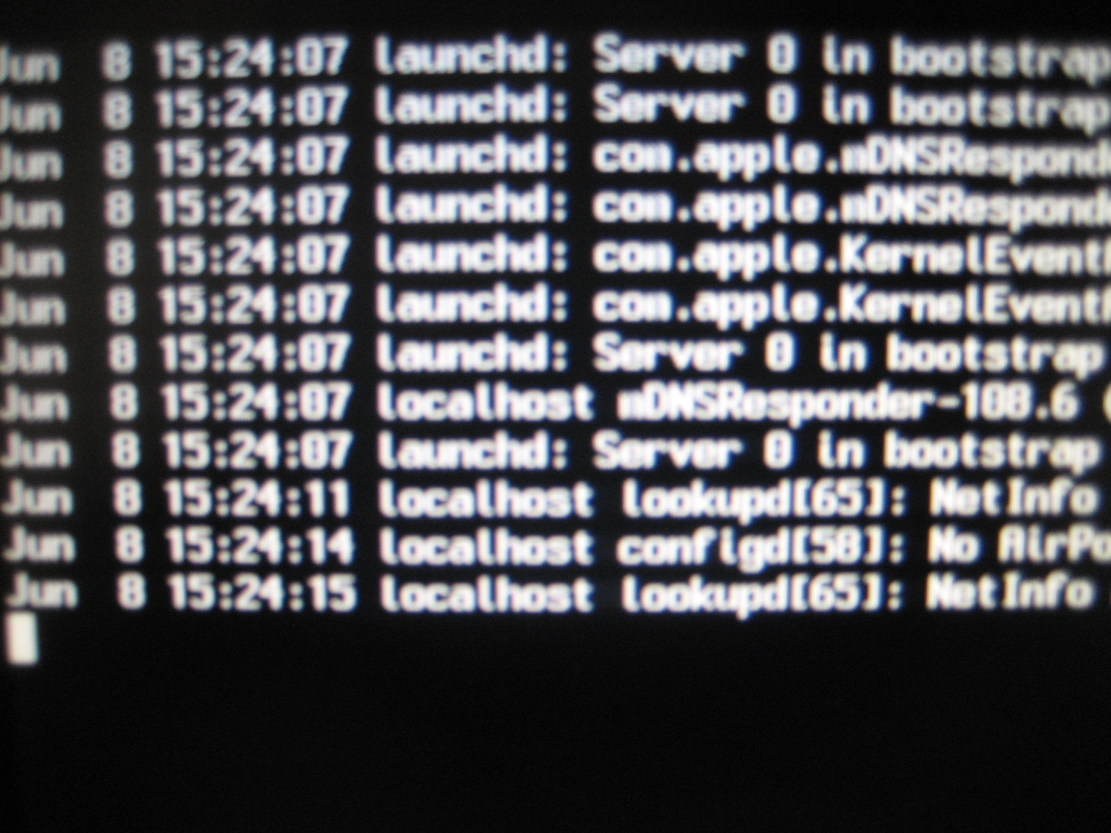

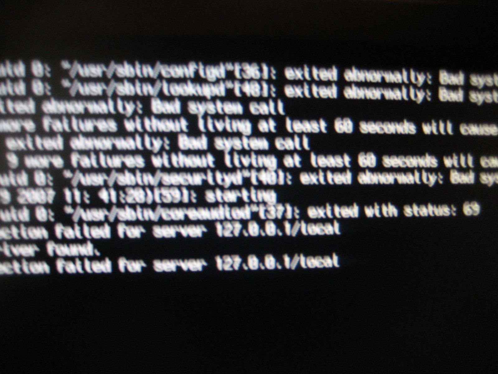

My brother's intel mac mini is going crazy. For a while, it was just freezing a lot - i.e. every time you'd open up Safari or Firefox, it would freeze. We restarted the computer manually, but now it won't start up! It stays on the apple with the progress wheel for a few minutes, then cuts to a very frightening screen that looks like DOS. I took some pictures of this screen with my camera, it's hard to read but you get the idea.
What can I do? I tried starting in safe mode and that didn't even work (though maybe I'm doing it wrong?). Any help would be greatly appreciated, thanks!

Looks like one of two things to me: either your OS installation on the disk has gotten corrupted, or a piece of hardware has gone bad. The "Bad system call" messages seem to indicate that something is wrong at a fairly low level.
To test the first one, I'd try an Archive & Install off of the most recent OS X cd/dvd you have. If the dvd boots normally, you'll know right there that it isn't likely to be a hardware issue. The Archive & Install will probably take care of it - though you may want to check and make sure the filesystem itself isn't corrupted. I think the install dvd has a check or repair filesystem option, but it's been a while since I looked. If it says there is a problem but can't repair it, I highly recommend DiskWarrior.
If it is hardware (the install dvd doesn't boot), I hope you still have AppleCare?
