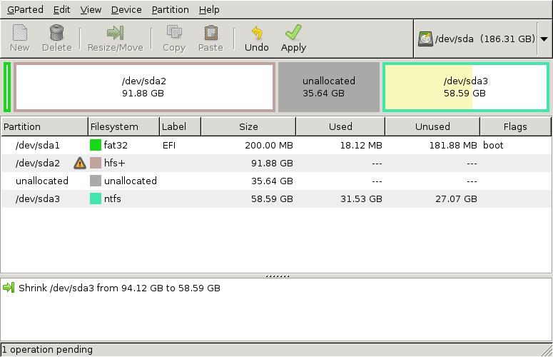

1. Download the latest ubuntu live CD .iso and burn it to disc.
2. Insert into Mac and boot. At the chime, hold down the "c" key. Select "Try ubuntu" or whatever option corresponds to that. Do not install ubuntu.
3. Open GParted and use it to examine your hard disc and the partitions. It should look similar to (but not the same as) the image here. Make sure the boot flag is on your EFI partition and make sure you apply your changes or whatever.
4. Quit your live ubuntu session and restart and it should boot to OS X.
5. If it doesn't, post back here. You'll probably need to do a reinstall from scratch. I hope you've got a time machine backup...

Your Lion recovery partition stops you from booting the Snow Leopard installer.
If you can't repair your EFI boot flag using GParted, you will at least be able to erase each partition manually and then format the whole disc to FAT32. You'll then be able to boot the Snow Leopard installer and proceed as if there was a new hard drive in there.
This ought to work. I managed to maintain my linux dualboot while rolling my Mac back from Lion to Snow Leopard using only gparted, IIRC.
