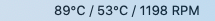

The 27" is 65w with a better cooling solution. I honestly don't know which is quieter but I have an I5-4670 in my 27" 2013 iMac and even when transcoding video the fan RARELY lifts off of 1200rpm and that is with an 84w TDP CPU.
Matter of fact I'm transcoding a video right now.
89c is highest core temp, 53c is GPU.
When gaming fan increases however the game audio makes its unnoticeable.

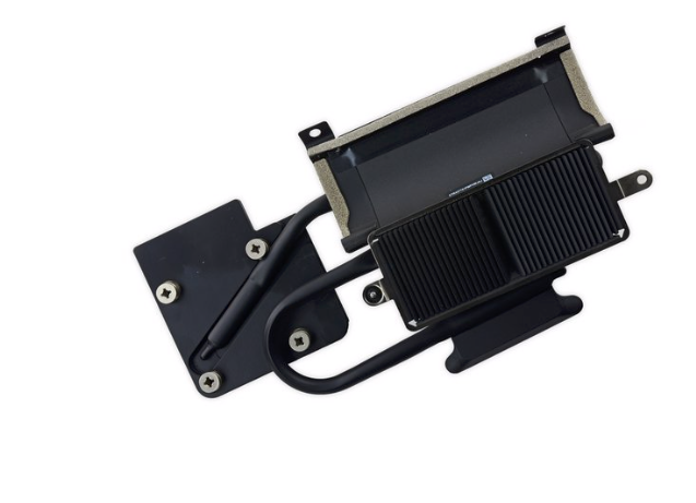

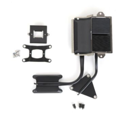

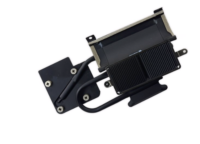

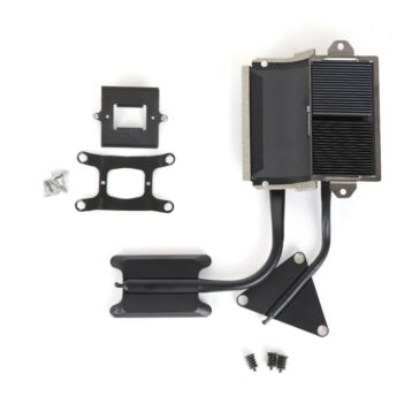

1, Heat pipe design and blocks they are connect to are different because the logic boards between the 21" and 27" has different layouts. So basically GPU and CPU's in different locations. This makes little difference though and that is because the heat pipe needs to be tuned for the application.
This is a 2013 21" iMac

And this is a 2013 27"

Even though the block for the CPU is directly under ducted portions of the heat sink where the heat pipe needs to goto it runs out what looks to be an unnecessary length and then comes back. That is likely in insure phase change of the working fluid within. However there is likely more passive cooling in the area.
2. The heatsink is designed with a duct that air drawn in from the bottom of the iMac is exhausted through. The 27" iMac has more depth so the duct is larger and the fins (which disperse the heat) have more surface area to do so.
3. Similar to above the fan of the 27" model is taller due to extra depth of the 27" which makes the vanes of the blower longer meaning it can move the same amount of air at lower RPM's. For example I believe in 2013 (my iMacs year) 21" iMac fan ranged from 1400-4000rpm, while the 27" ranged from 1200-2600rpm. The higher velocity of the 21" fan combined with a more restrictive heatsink fin duct design = higher static pressure which nearly always means more noise. Comparatively speaking, this is why my 2018 MBP can have TWO fans running at 5000rpm while being very loud and still not be moving as much air as my 2013 iMac running a single fan at 2000rpm.
4. The 27" model heatsink is typically beefier in its design due to faster (hotter) components that are available for it. You can see that in the GPU blocks pictured above.
5. The heatsink is designed for the CPU with a highest requirements for that model (I think Apple could still do a little better at this but that is the intent). So currently the 21" heatsink is designed for a CPU with a 65w TDP and the 27" heatsink is designed for a CPU with a 95w TDP. This is the whole reason people get a less powerful CPU in the 27" iMac range for noise. They are putting a 95w TDP heatsink on a 65w TDP CPU.
