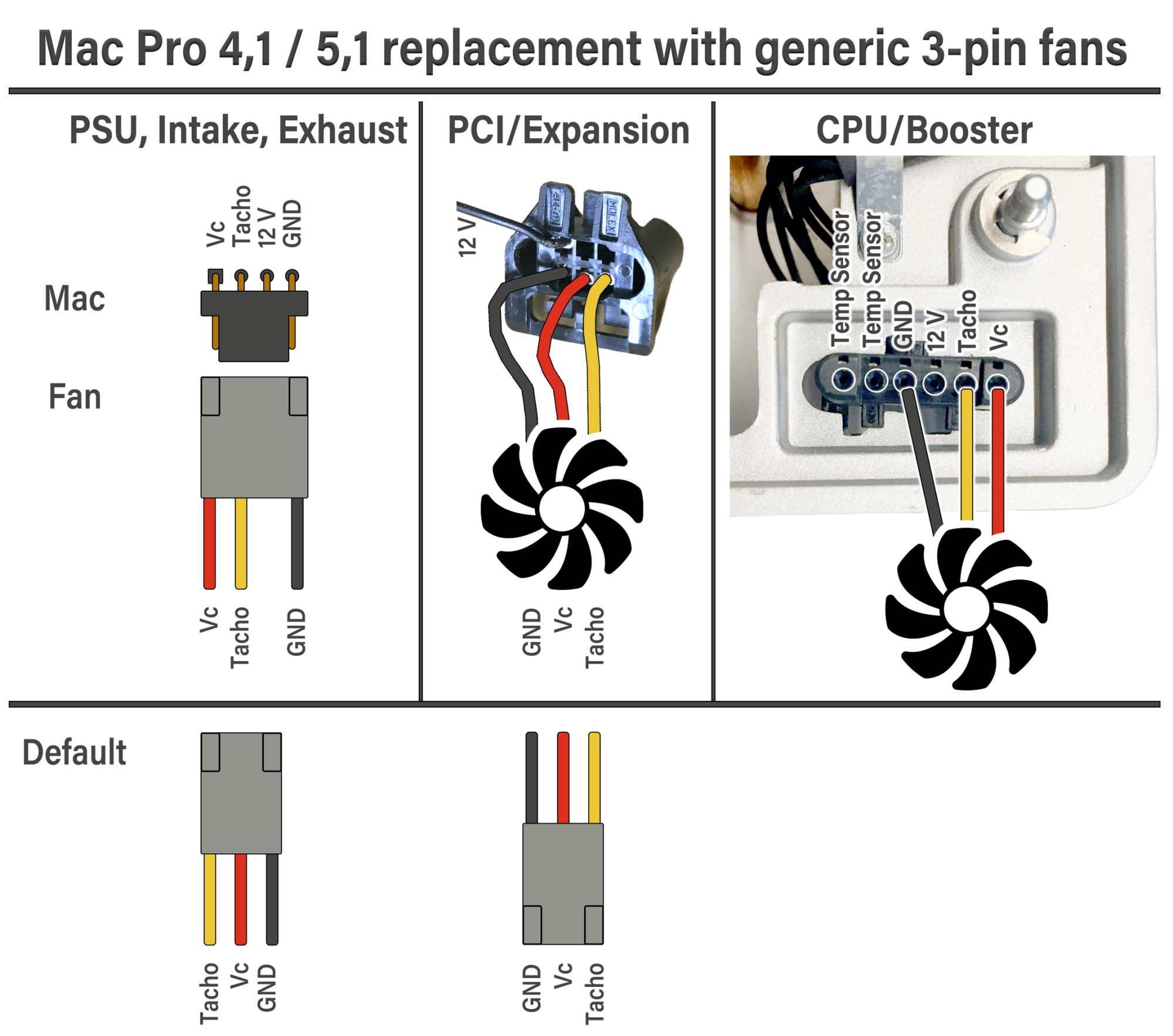

I found a thread that shows how to replace the stock fans with Noctua fans and still retain automatic speed control.
I'm a bit confused on which GPU would be best. I see some reports that an axial fan is generally quieter than a blower. If it is possible to alter the fan curve, TDP, or undervolt the GPU and reduce noise - then it may not matter what type of fan the GPU has as long as it is efficient. It looks like the favorite GPUs are the Sapphire Pulse RX 580 and the Radeon Vega 56.
My initial guess is:
-Replace all fans with the appropriate Noctua fans as described in post #385 in the Noctua thread
-Replace the gpu (but not sure which gpu would be best)
Thanks for your help!
