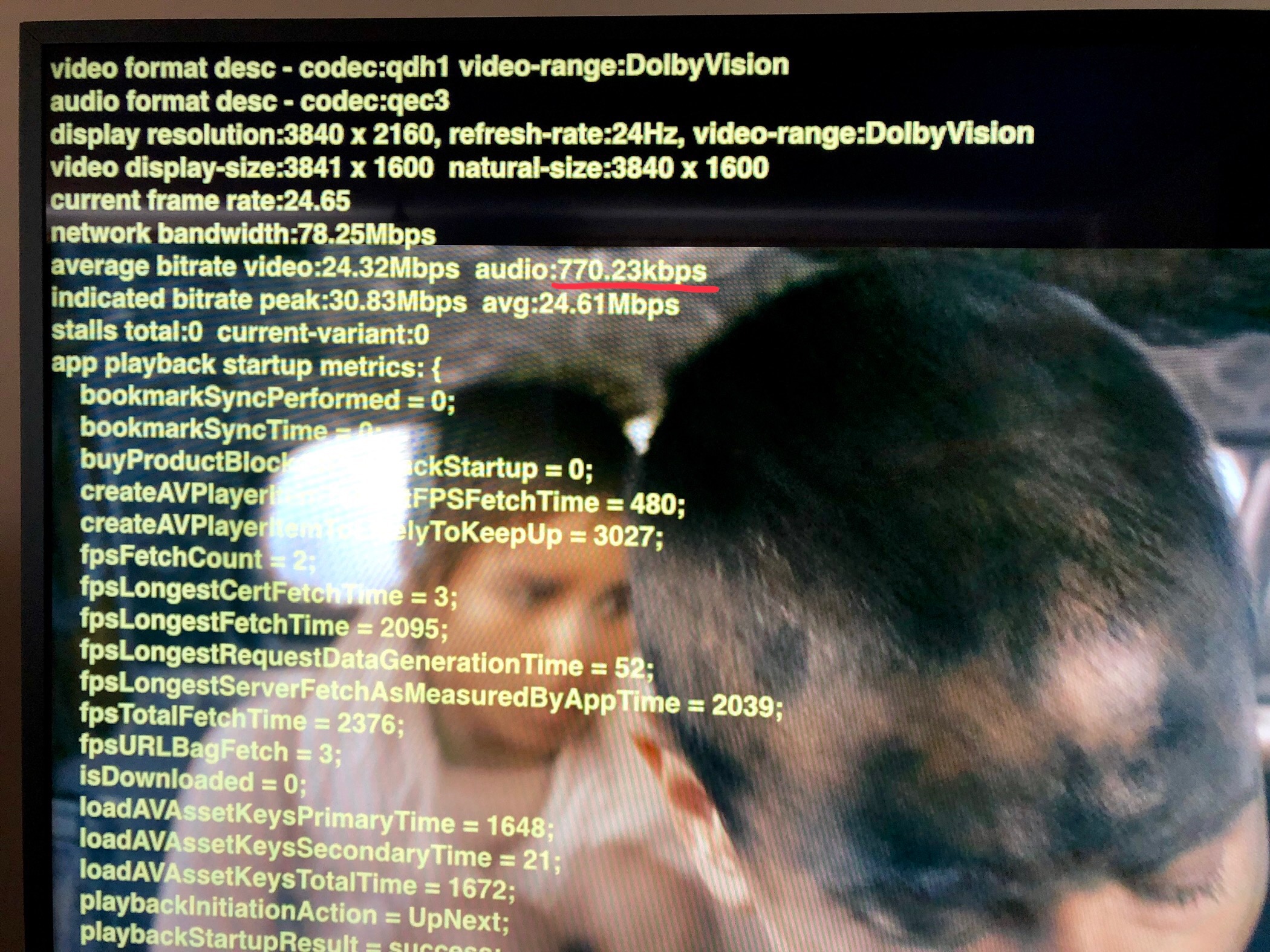

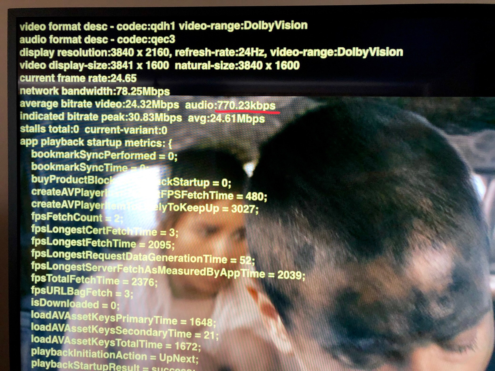

1) True. Bitstream output was blocked since late version of tvOS 11. So Infuse et al are unable to do it now as well.
2) True. https://photos.app.goo.gl/k35xfPL1JhwDQ1W88
3) True. Just the channels have been decoded from E-AC-3 into PCM. Objects and metadata are stuffed in. How, I have no idea.
4) DD+. Mad Max Fury Road shows me 770kbps.
It would be wishful thinking to hope for a lossless audio from a streaming service.
