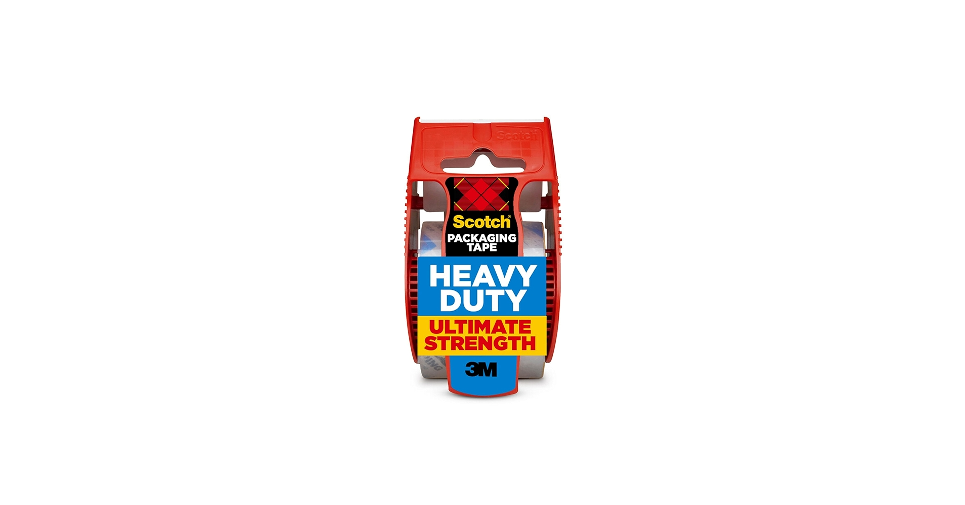

How do I remove the damaged glass from the iPad so that I can charge it and hopefully get some of my data off?😢😢😢
You don’t, or the digitizer (your ability to tap) will be lost. Cover it with strips of clear packing tape.
Thank you for your reply!
I'm really glad you said this!
Can you recommend which tape to get? I'm worried about cutting my fingers on the broken glass... 😢 😢

If you cover the broken screen with clear tape you will have much less or no chance of cutting your fingers. I cant think of any other way to provide this protection and see the screen in order to interact with it.
I've done it myself and it works. For extra protection you could use tape and wear gloves with conductive 'touchscreen compatible' finger tips.
If you dont tape it down, small shards will fall off of the screen.
