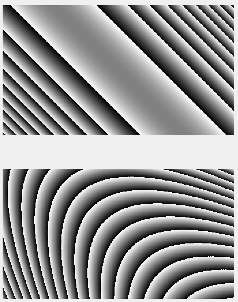

I have done the Matlab code like this:
Code:
k=double(imread('testHologram.bmp'))/255*2*pi;
Mtheta=3/4*pi;
Mphi=pi/6000;
wl = 522e-9;
[x,y]=meshgrid(-960*p:p:959*p,540*p:-p:-539*p);
xm=x*cos(Mtheta)+y*sin(Mtheta);
ym=-x*sin(Mtheta)+y*cos(Mtheta);
wave=exp(j*2*pi/wl*sin(Mphi)*xm);
khologram = exp(j*k).*wave;
phase1=angle(khologram)+pi;
% Hologram
kkhologram=phase1/pi/2;
imshow(kkhologram,'Parent',handles.axes2);
And also did some work in Java, but the pattern is different from each other.
I will be very appreciate if you guys can help
Best regards

I am Java newbie so, my code looks so messy 🙂
Code:
public double[][] compute(File file) {
        try {
            BufferedImage img = ImageIO.read(file);
            Raster raster = img.getData();
            int w = raster.getWidth(), h = raster.getHeight();
            double pixels[][] = new double[w][h];
            for (int x = 0; x < w; x++) {
                for (int y = 0; y < h; y++) {
                    pixels[x][y] = raster.getSample(x, y, 0);
            return pixels;
        } catch (Exception e) {
            e.printStackTrace();
        return null;
Code:
    private int phase2gray(double phase) {
        int scale = gray2phase.length;
        phase = phase / 2.0d / Math.PI;
        phase -= Math.floor(phase);
        int gray = Math.min((int) Math.round(phase * scale), scale - 1);
        return gray2phase[gray];
Code:
public void paint() {
        double[][] iArray2;
        File file = new File("./src/resources/diagram/testHologram.bmp");
        iArray2 = compute(file);
        WritableRaster raster = canvas.getRaster();
        double[] iArray = new double[1];
        double phase, x, y;
        double phy = Math.PI/6000;
        double theta = Math.PI*0.75;
        double lambda1 = 522e-9;
        double xm = Math.sin(phy) * Math.cos(theta);
        double ym = Math.sin(phy) * Math.sin(theta);
        double fixpart = 2.0 * Math.PI / lambda1;
        double temp;
        phase = 0;
        for (int i = 0; i < iArray2.length; i++) {
            x = (double) (i - iArray2.length / 2 + 1) * pxsize;
            x = xm * x;
            for (int j = 0; j < iArray2[0].length; j++) {
                y = (double) (j - iArray2[0].length / 2 + 1) * pxsize;
                y = ym * y;
                for(int k = 0; k < iArray2.length; k++) {
                    temp = ((double)iArray2[k][j]/255)*2*Math.PI;
                    phase += Math.getExponent(fixpart * (x + y))*temp;
                iArray[0] = phase2gray(phase);
                raster.setPixel(j, i, iArray);
                phase = 0;
I attached the result from Matlab:
The area above is testHologram.bmp, and the area below is after using the algorithm
one obvious difference
I see one obvious difference that may explain your problem.
In your Matlab code you have:
Code:
Whereas in your Java code you have:
Code:
Notice that the Matlab code doesn't depend on phi, it uses only the theta variable.
HTH
Code:
Code:
HTH
I'm noticing those lines you pointed out aren't even close to the same. The fact that sin, cos, theta, and multiplication are used are all preserved, along with the resultant variable names of xm and ym, but the java code lacks the addition, the use of x and y, and adds in phy.
