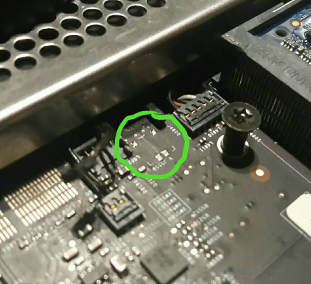

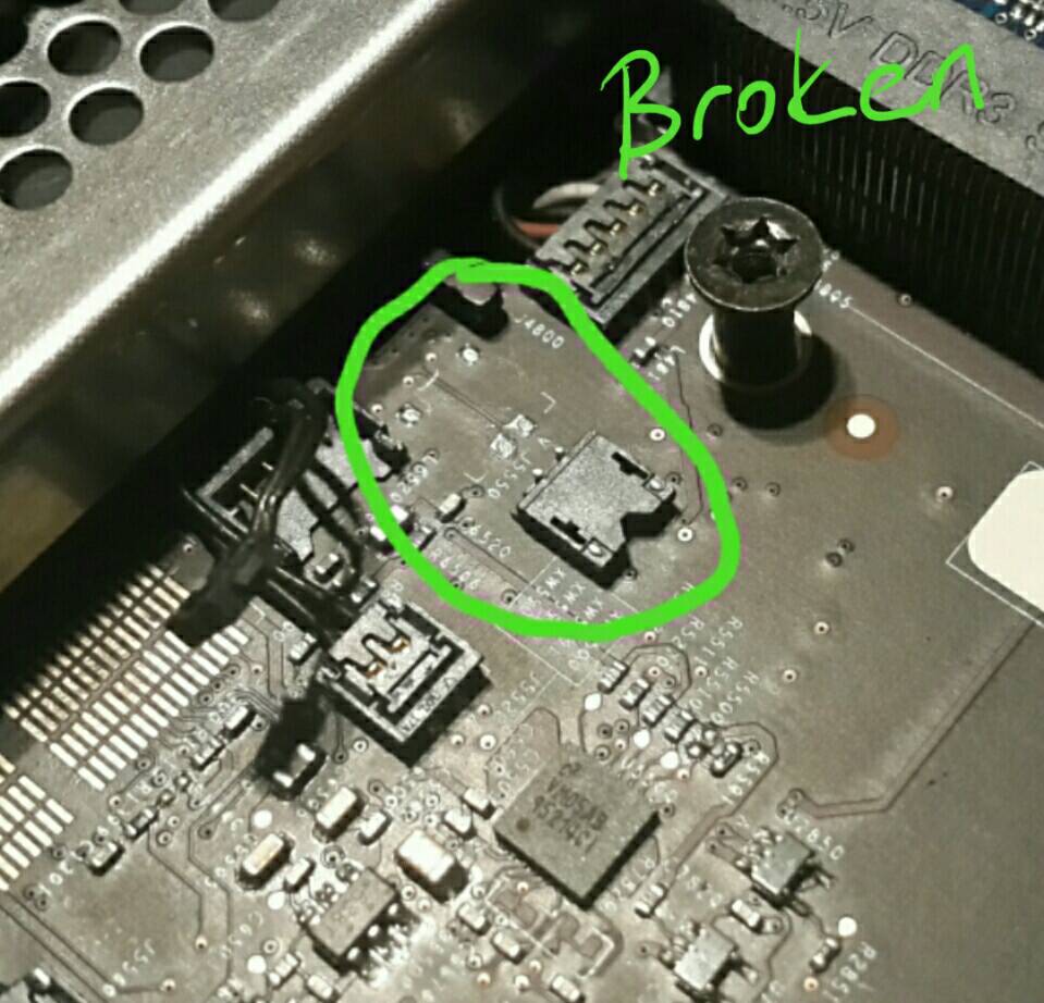

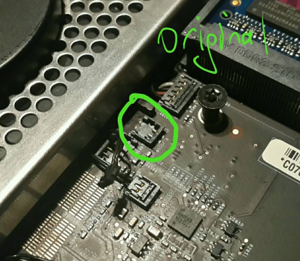

Hi When i installing the SSD drive the thermal sensor detached or broken from the logic board. You can see from the photos. What should i do? How can i repair or who can solder it to the logic board?

You can put it back with a dab of glue people have a 90% success rate. Or you strip the sensor cable and solder it onto the logic board directly

No, don't use glue. Do a web search for electronic repair in your area. Phone the places and ask them if they can solder small electrical parts. If the can, take the computer to them.
I broke something similar on my MacBook Pro and found a repair shop that did it for $50. Worth every penny.

Just regular superglue. You need the smallest dab away from the two contacts then just apply firm pressure.
You could put it in place and then reflow the board but I'll let you google that as not everyone is comfortable with baking products.

Putting in a SSD in a 2012 mini is not major surgery. Major surgery is putting in a 256gb blade SSD and a 1TB HDD in a 2012 iMac 27. THAT'S surgery. In all honesty if you have no mechanical skills whatsoever or just ham-fisted, then pay someone else to do it. But looking at the OP's pictures, that damage is easily repairable with someone who's skilled with a soldering iron.

I did the exact same thing the very first day, I bought a 2010 MacMini off Craigslist trying to install a SSD. I had to buy a whole new logic board -- found one no too expensive ~$200 off ebay tho.

Before you give up or spend $$$ on a new logic board, try to reflow the solder.
Assuming you still have the connector, you will need to glue it to the logic board in exactly the same spot. Just use a tiny dab of super glue, a really tiny dab. This takes care of the mechanical connection.
Next, just see if it works-the metal contacts should now be touching, and should work. A more reliable connection would be to get a heat gun (Harbor Freight is your friend, if in the US) and reflow the solder. I'm not going to go into that, but read up on ifixit.com about repairing the Xbox 360 red ring of death-they have detailed information about how to reflow solder. We're just re-melting those tiny pads of solder under the connector. I'll admit this is tight quarters, but worth a shot if your only other option is trashing the board. Which if you do please PM me, I'll buy it.
The other suggestion above about a soldering iron to reflow the solder is a good one too.

Bad Idea...
Look at all the little plastic bits around the sensor port... Those will all melt along with the connector he's trying to reflow as the melting point of solder is much higher than the plastic for the connectors. Sheesh, is there anyone left in your area that has any soldering skills?! The benefits of the throwaway generation I guess.
