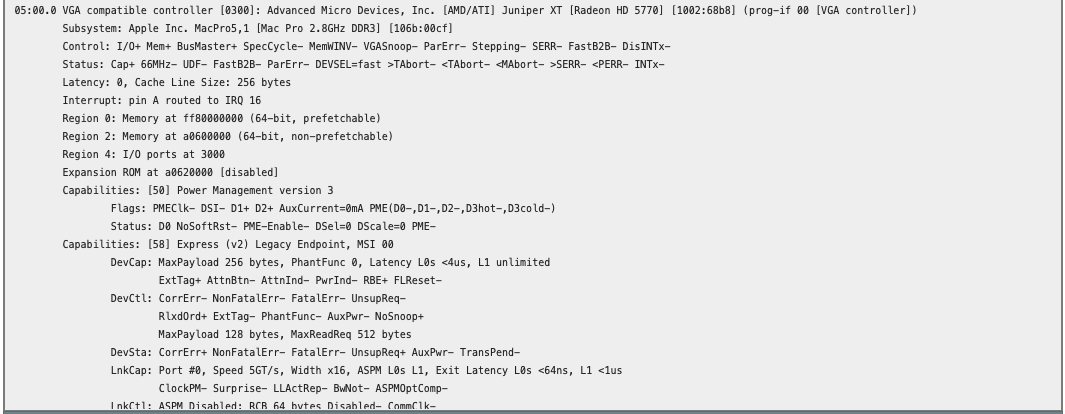

Darwin Dump for MacPro5,1_Apple_X64_Mojave_18G9323_ashok.vardhan with Apple Radeon HD5770 in slot-1 alone:
Weird, HD 5770 is recognized, with correct link width and speed.
Video is working?
Video is working?
No video when booted into normal mode (since this card is not Metal compatible I guess) it only shows up recognized in System Report.
Similarly, no video even when I try to boot into Recovery mode with the Radeon HD 5770 card installed.
It surely is a very baffling situation. Even I am at a loss.
Video should work, via EFI drivers/completely unaccelerated. What display you are using? Maybe your display is DP2.0 or something that is not supported/incompatible with the EFI drivers? Maybe it's something on your backplane…

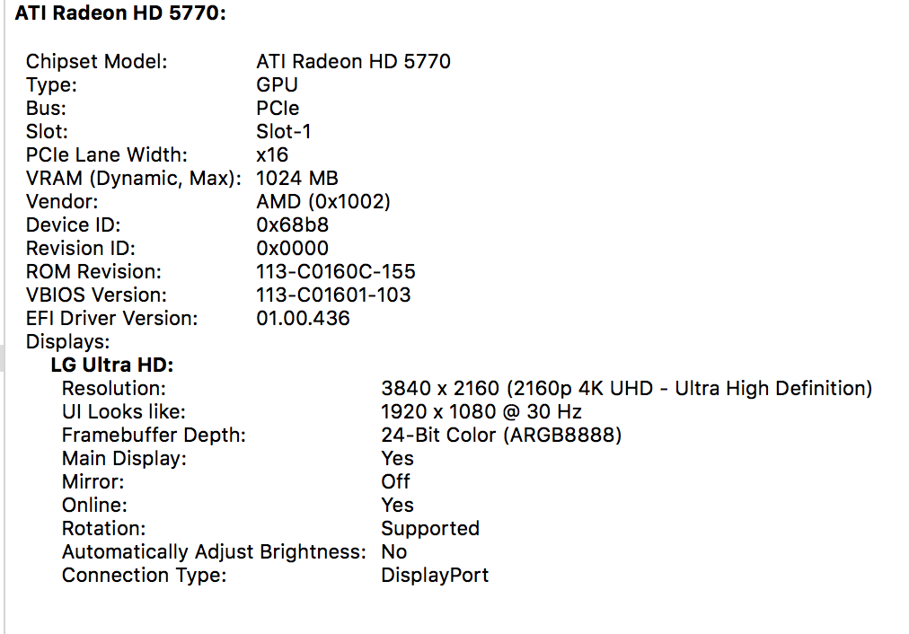

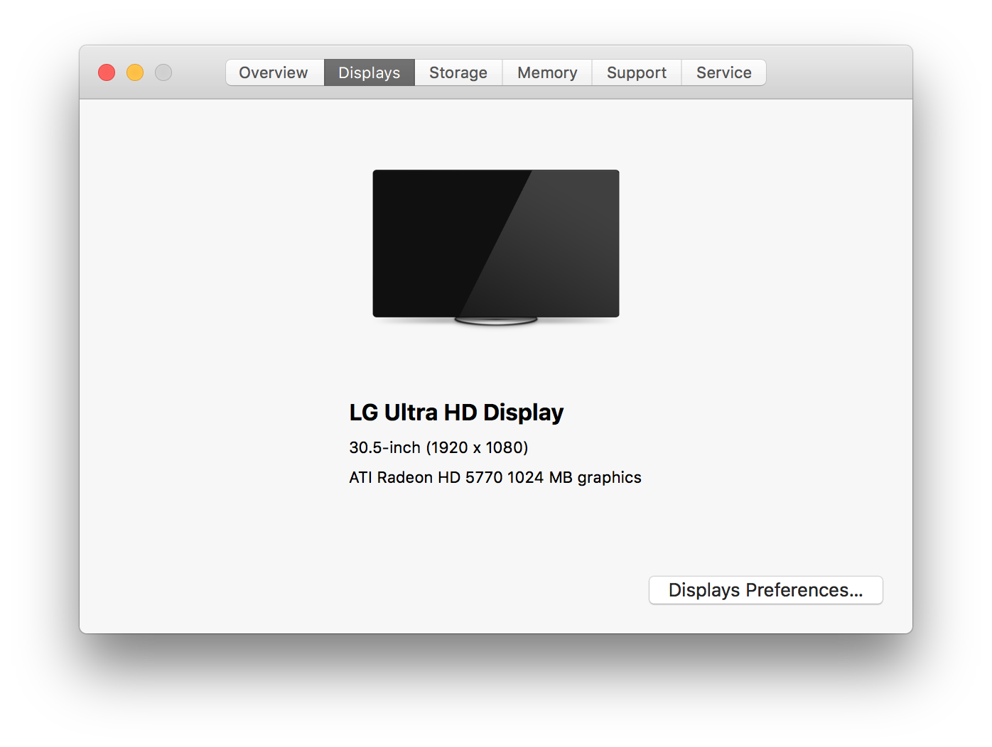

I did think about booting into Windows in bootcamp, however, because I do not have a legacy DVI-D monitor I am not able to install Windows either.
The monitor I am using just does not display bootmanager even with a GPU with a Mac BIOS like ATI Radeon HD 5770 1024 MB.
I read somewhere that modern high resolution displays do have this limitation in legacy GPUs like the ATI Radeon HD 5770 1024 MB:
View attachment 2013298 View attachment 2013300
I completely forgot, yes, your analysis is correct, I had even griped about this limitation earlier in the same thread.
Totally slipped my mind because I was so focussed on other details. It is the display, not the backplane in this instance, in regards to the HD 5770, it does not show boot-manager screen even when it is the only card installed.
In High Sierra the monitor does not actively display image from the HD 5770 until system is booted into OS and the proper graphics kexts are loaded.
In Mojave, it just does not show any display at all, even when booted into normal mode.
