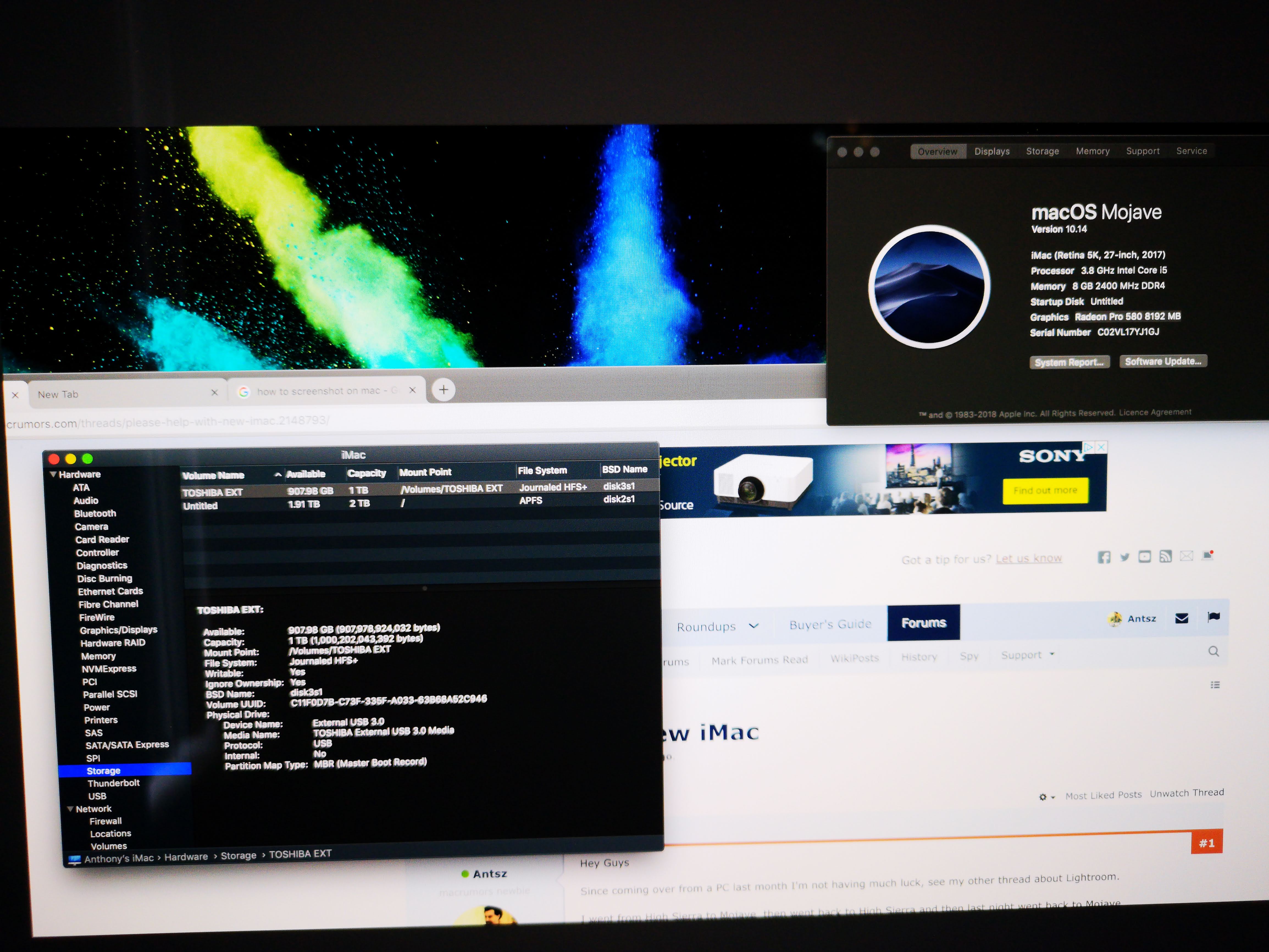

I noticed that my HD now says untitled instead of Macintosh HD.
Does anyone have any idea what has gone wrong? It all started so well and now I'm regretting selling my PC!
My specs are
iMac (Retina 5K, 27-inch, 2017)
3.8 GHz Intel Core i5
8 GB 2400 MHz DDR4
Radeon Pro 580 8192 MB
[doublepost=1540039619][/doublepost]the tosh drive is a usb external storage drive

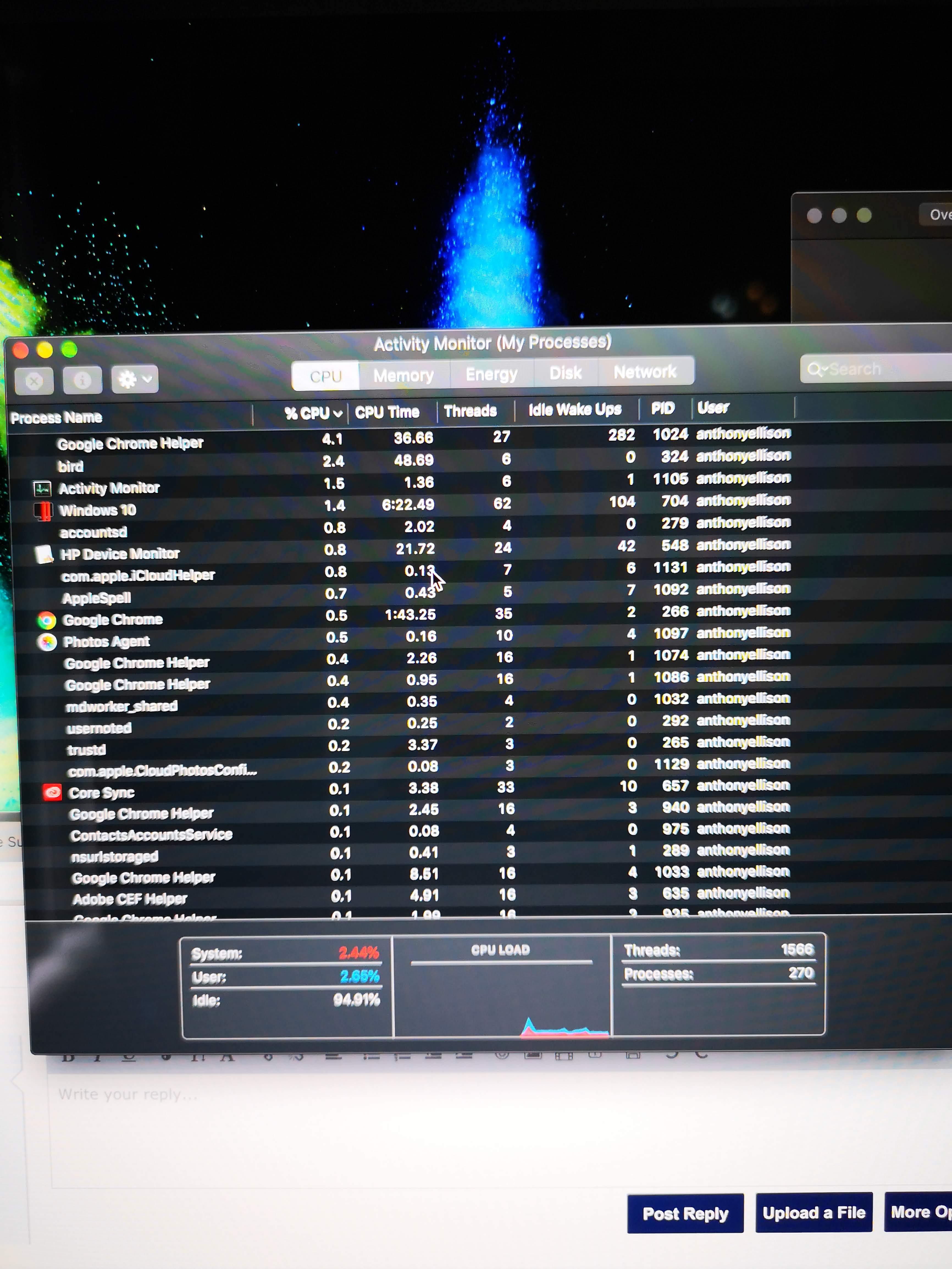

[doublepost=1540040186][/doublepost]My activity monitor says little use but still unusable

1. You've got Windows 10 running under Parallels there - how much RAM did you allocate to the virtual machine? An 8GB Mac won't stand too much being allocated to Windows, and if you're doing a lot of work with Windows you could do with a bit more RAM - go to the memory tab in Activity Monitor and look at "Memory pressure" (its normal for all of you RAM to be "in use" - don't worry so much about that). For the moment, quit Windows and Parallels to "eliminate them from your enquiries".
2. Probably not the problem but, as part of a process of elimination, unplug your external drive for the moment.
3. In my experience, its not uncommon for a Mac (especially with HD or Fusion) to run like a snail on valium for a while after its been upgraded, while it re-indexes the disc for Spotlight and does various other housekeeping - and if you get impatient and start messing with it then it can all go back to square one. If you've got a "fusion" drive (I assume you've got that unless you've really pushed the boat out for a 2TB SSD) then that will take a while to sort its cache out and get up to speed. I think Photos sometimes does a library re-index/conversion that can grind the disc for a while, too. The first Time Machine" backup can take forever and slow things down, too. Leave it to its own devices for a few hours, or overnight.
4. The system disc being "untitled" is odd, so certainly run the checks that other people have been suggesting.
5. If "upgrading" has got you to this point, make sure everything is backed up and then do a "clean" re-install of the OS. Major pain because you'll have to re-install, re-configure everything, but it gives you a clean slate...
