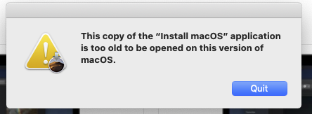

I downloaded the installer and it does NOT work. I have attached a file that shows the error. The message is essentially saying I cannot use this installer to go backwards.
Please advise as to how I can go from Catalina (V10.15) to Mojave (10.14)
Catalina updated the mac firmware. ALWAYS make a bootable backup (clone) before installing a new OS, such as CCC from Bombich .
Dis you just download the latest installer directly from Apple? They recently posted new versions because the old installers had an out of date certificate. Your error seems like you used an older installer. Use Internet recovery to guarantee the latest installer:
