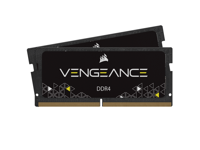

It sounds like you have a plan. If you're going to spend the time doing this don't cheap out on the RAM. I don't have benchmarks on the mini and maybe with your general tasks you won't notice but it is fact that RAM in single channel is slower. Ask anyone who bought prebuilt PC with a single 8 GB stick.
My only advice is take each step slowly then pause to see what it is you are doing. I had a YouTube video playing and even after watching it several times I paused each step to make sure. You should never have to force anything but on mine I felt like I had to put an uncomfortable amount of pressure to get the RAM modules to click into place. Maybe that was just mine but before I did that I pulled them out and reseated them several times just to make sure I wasn't doing something wrong. That and disconnecting some of the smaller connectors with tweezers made me sweat 🤣
Here's the modules I bought. You don't have to get the exact same ones but just make sure whatever you get it says that it's compatible with a 2018 Mac mini.
Let us know how it goes!
