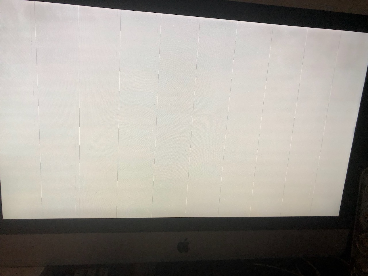

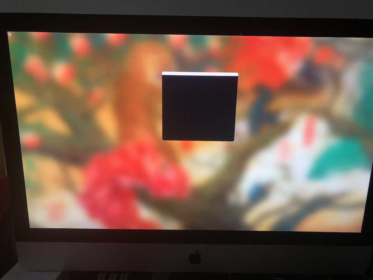

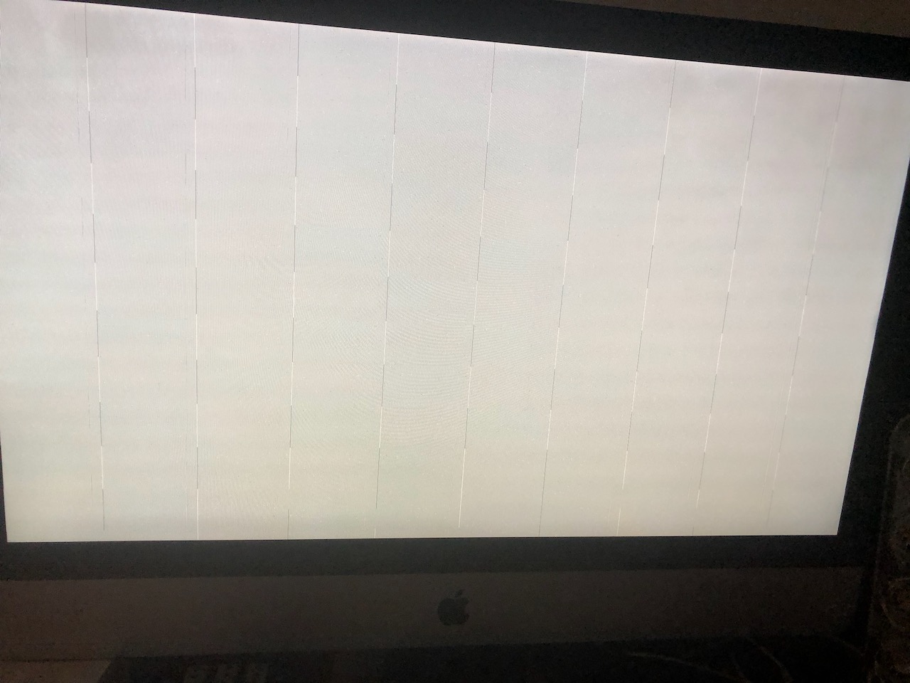

My iMac "died" on me a few months back and until now "survived" with my macbook but things are tough sometimes.
I know it's old but worked so well for my needs and this is not the moment to be even thinking about buying a new one, so please if you can help me diagnose.
I had already posted a similar thread in which the "impression" was about a failure of the graphics card.
As fixing that is not an option at the moment (and would probably just jump on the occasion and buy a new one if I could afford it) I'm asking is there's a way to be "sure" of this or rather ideas to exclude a memory or OS problem.

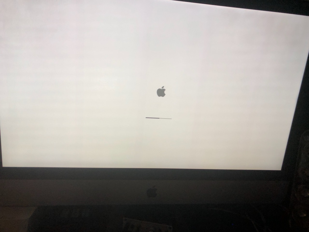

Here's the description of what I experience:

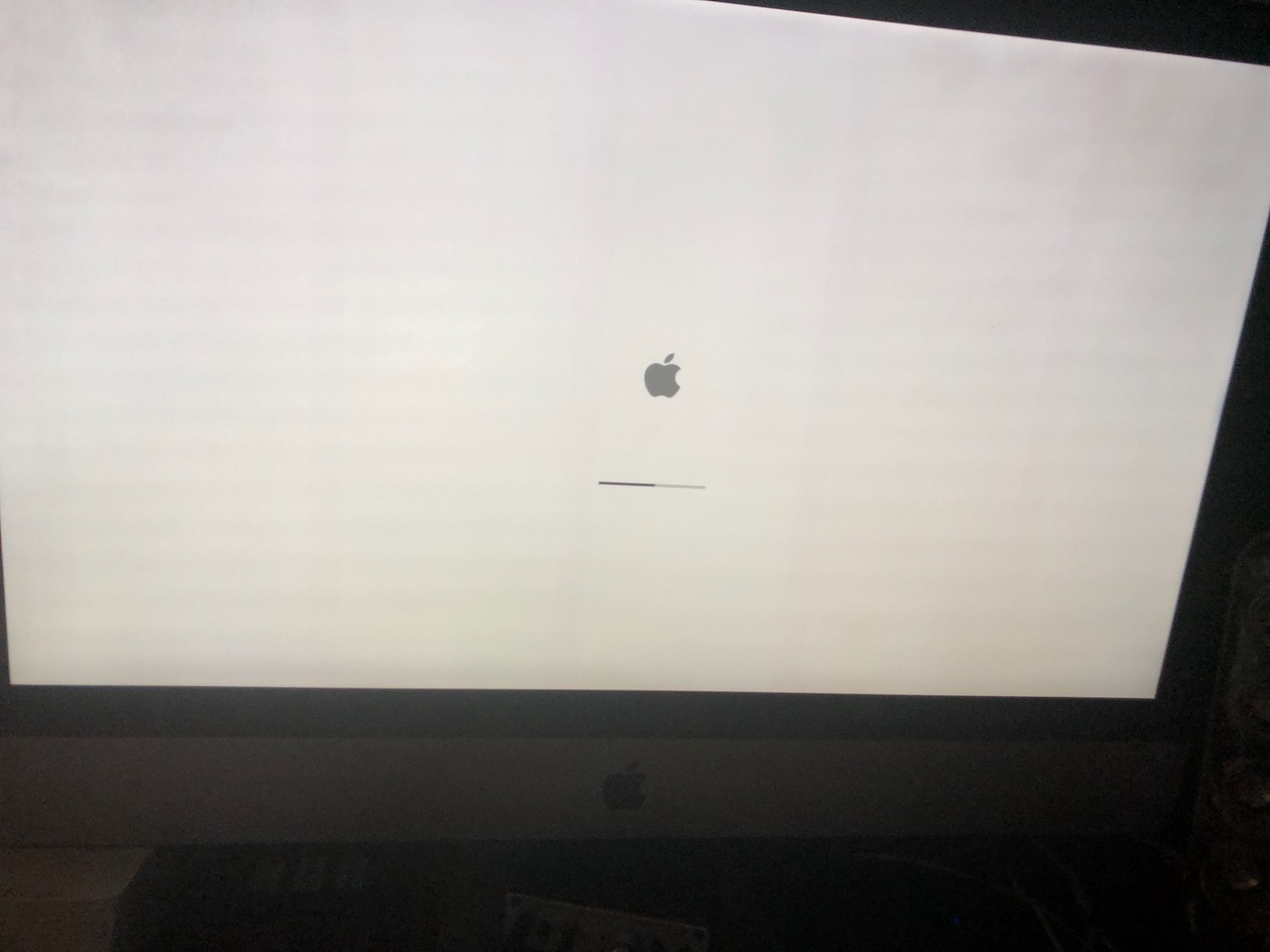

The iMac boots with one of the usual chimes and the first screen with the apple and a progression bar seems fine.

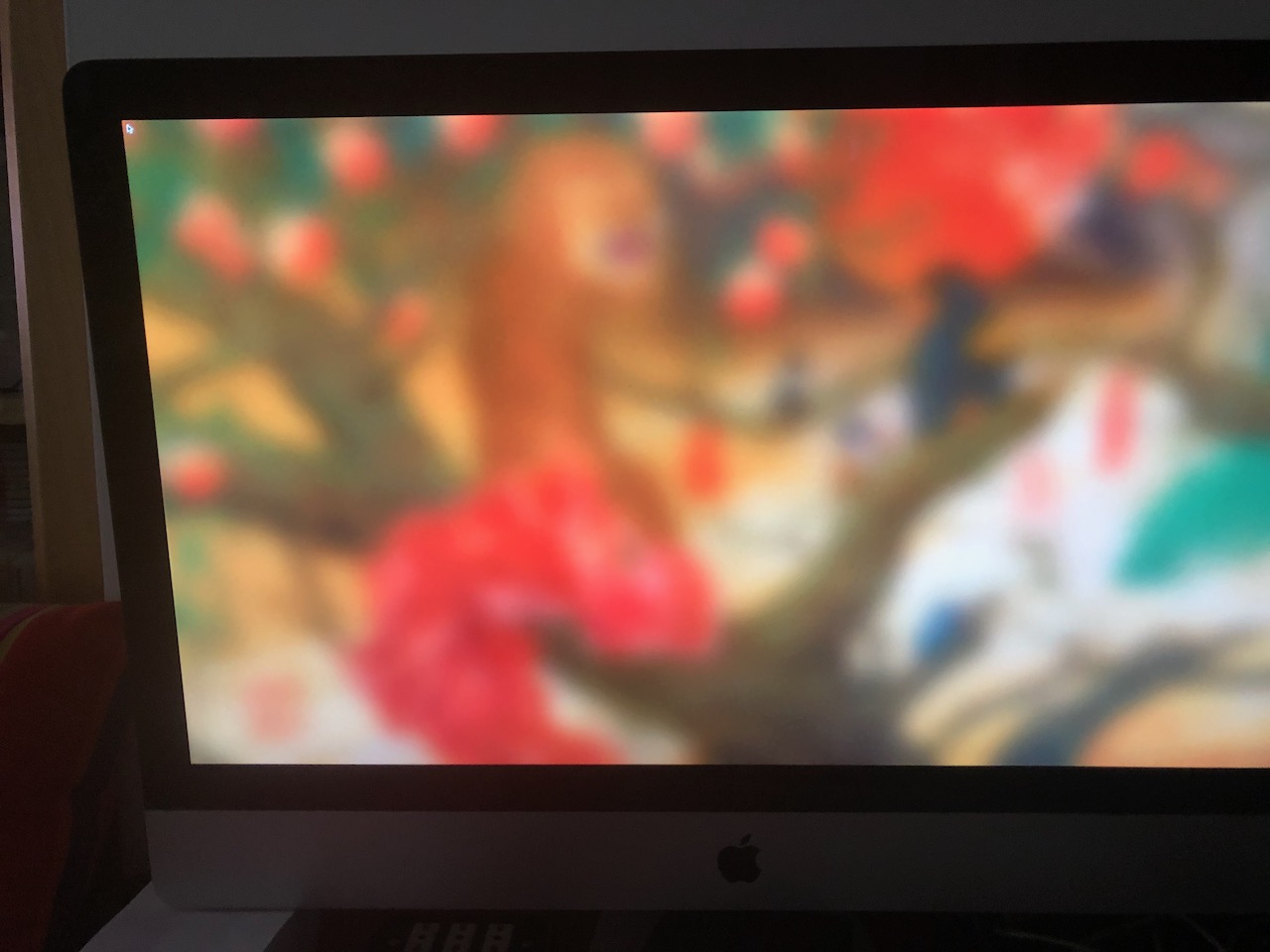

At about midway though the normal boot screen gets substituted by an abnormal "white noise" screen (will post picture) after which the boot screen resumes seemingly correctly, then loads my "defocused wallpaper" but then instead of progressing to the login or desktop it only opens a strange black window with nothing in it, the corners missing, a blue square.

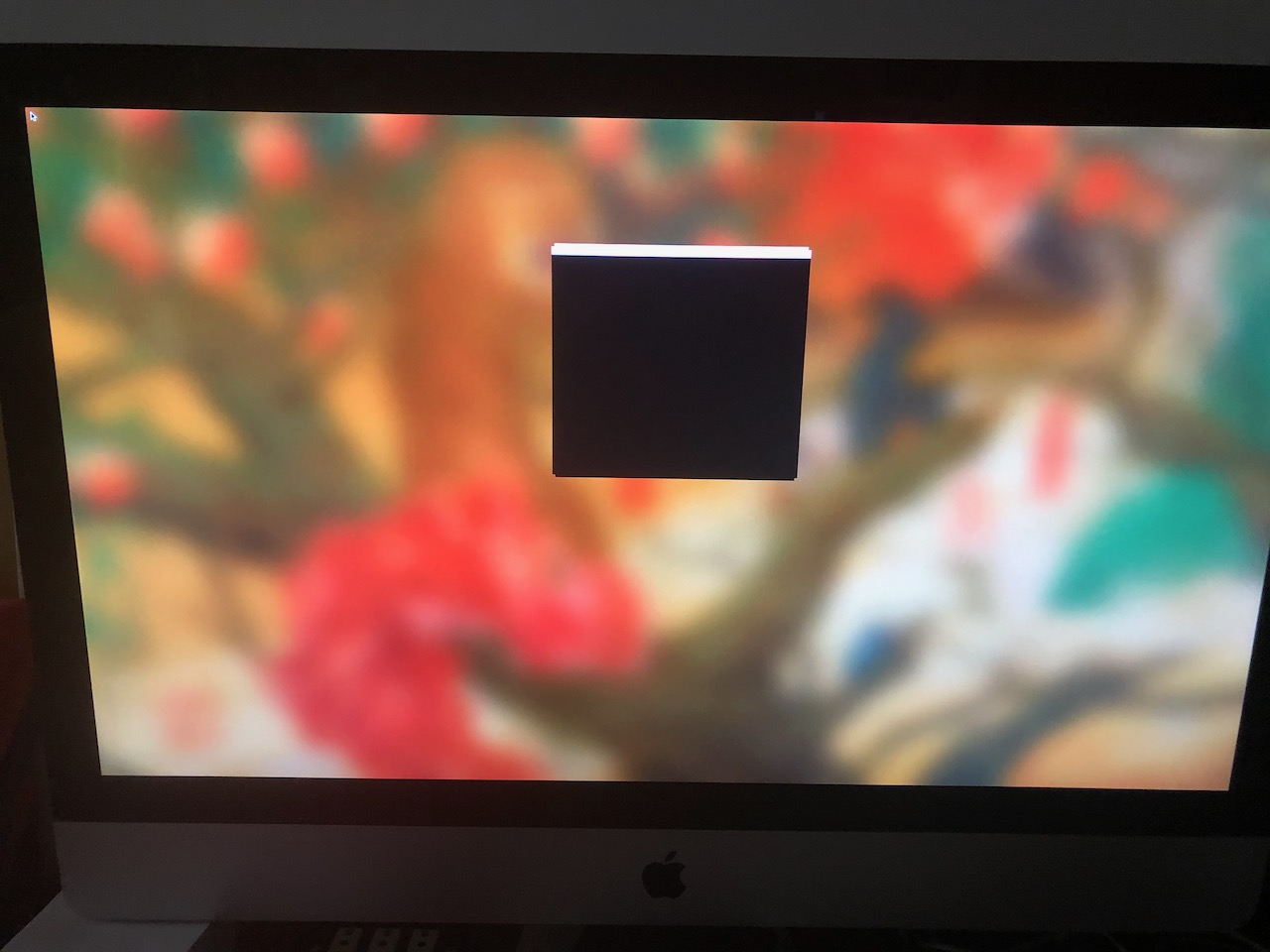

Mouse pointer is well formed and moves normally but nothing reacts and the only thing I can do is force a shutdown by keeping the power button pressed for several seconds.
When the iMac broke I was working in Lightroom normally and I believe just in coincidence when I loaded a new image the image loaded with glitches and at first I thought that it was the image to be corrupted but then all the desktop started corrupting and that was the end.
Tried booting with the D letter on the bluetooth keyboard pressed but this only stops boot at the "white noise" screen. When I release it it proceeds with the "unfocused desktop wallpaper" and then the single widget-less window on which I tried clicking and can only drag around.
Here is roughly the sequence:
Any ideas on how I could understand if it's memory, graphic card or OS corruption?

The second image clearly show GPU hardware problems.
If opening the iMac to replace/fix the GPU is impossible for you, then buy another iMac is the only option you have got.

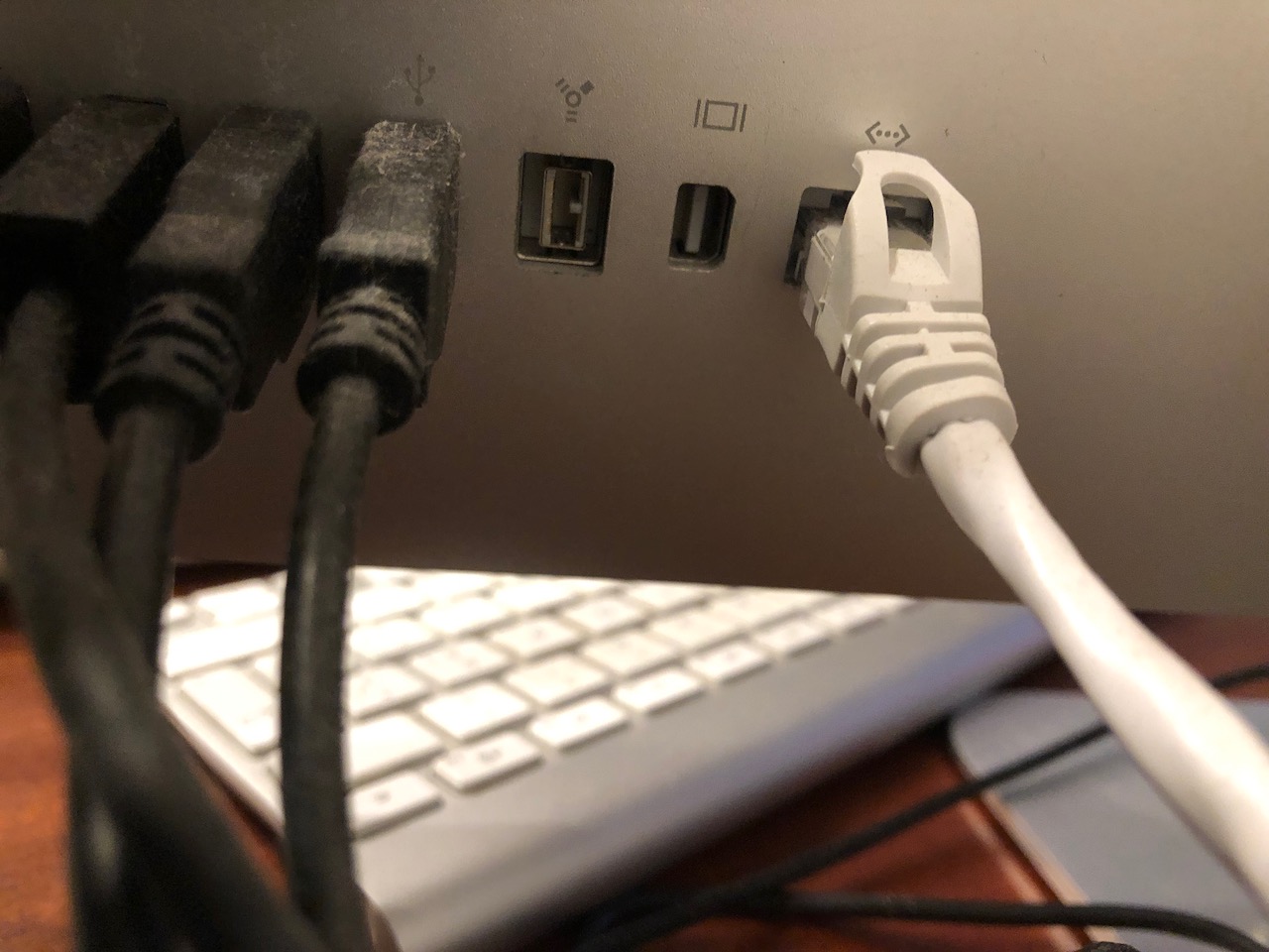

The connector is the little one between the Ethernet and FW800 ports, right?

1. If you can get to the login screen, then yes, you can use the iMac as a 27" Monitor.
2. I don't know about the Mac Mini, but the logic is: Newer is better, so buy the newest one you can afford. It should come with at least 8GB of RAM and an >240GB SSD inside for OS.
3. Adapter will depend greatly on what Mac Mini you would buy and what port it has. Options are below:
3.1 HDMI Port: HDMI to mDP active adapter (not very common)
3.2 Thunderbolt 2 port: Use a mini DisplayPort to MiniDisplayPort cable is enough for output. Thunderbolt 2 is backward compatible to miniDisplayport (downstream only)
3.3 Thunderbolt 3 port: You can buy a USB-C to MiniDisplayPort cable, but it's not very popular. More expensive, but easier to find is the combination of USB-C to multiport (including DisplayPort) hub, plus a DisplayPort to miniDisplayport cable. Another expensive option is the Apple Thunderbolt 3 to Thunderbolt 2 adapter, then miniDisplayPort cable.
The miniDisplayPort is the one next to the LAN port, or ethernet port.

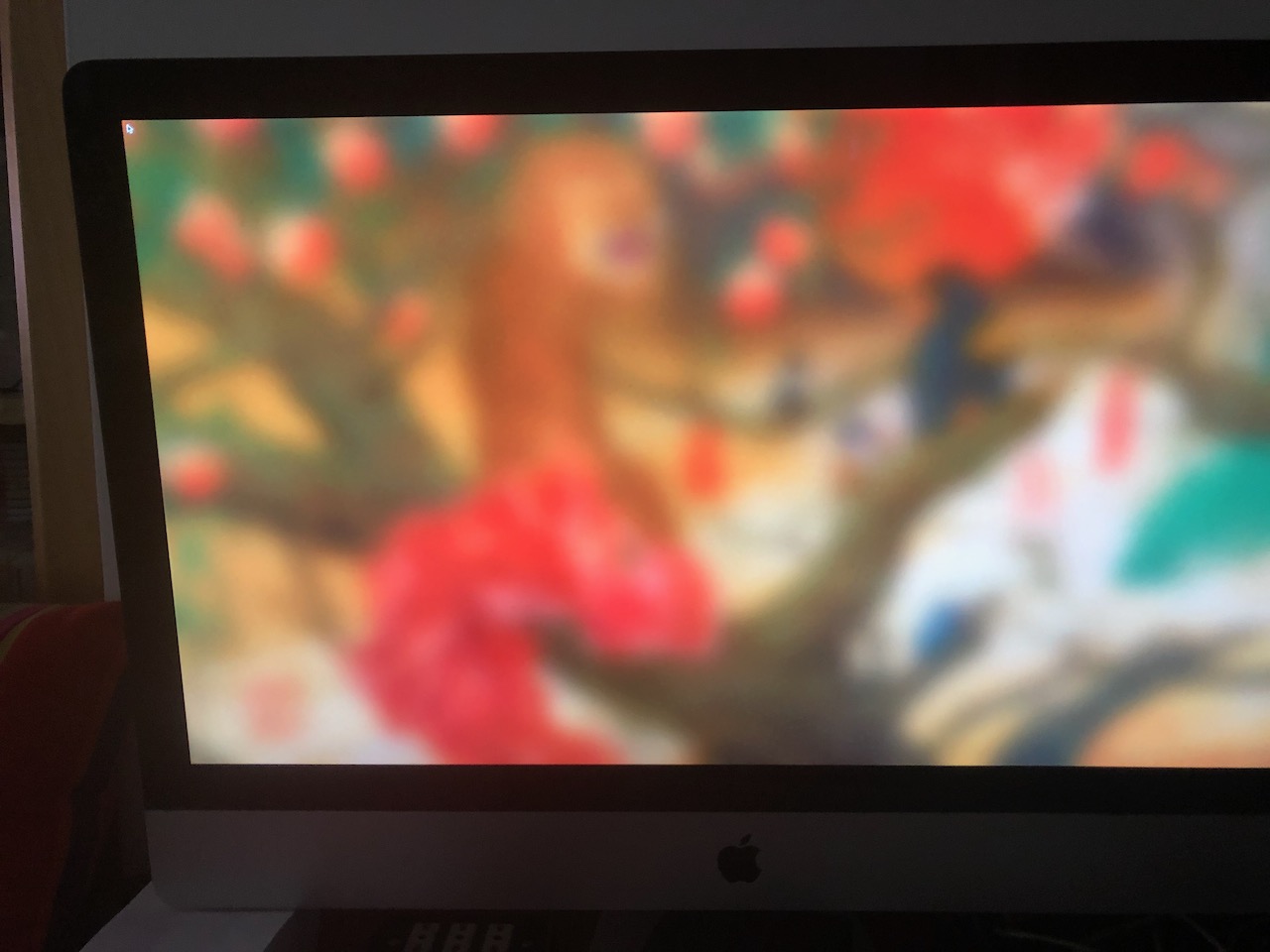

So tried with no keyboard at all (wireless K and mouse took batteries away) ... after some time the black window went away and I got to a password entry box without anything else. Tried my passwords but none work.
Tried with wired keyboard (an IBM Thinkpad external USB keyboard) and mouse pressing Shift as advised above and after a looooong boot OMG OMG with some strange screen flashing but then got to the login screen, logged in as myself and whoa I seem to be on my desktop.
Can't believe it !!!!!! WOW
So could I hope it's "just" a corruption of the OS???

Good news! It seems you booted into Safe Mode, which means that the OS didn't load everything it was being asked to load previously. So you're in a kind of minimalist state.
If I were you, I'd now grab some kind of external disk and copy off everything important, using Finder.
Then I'd shut down and see whether you can now get a normal boot (no commands of any kind, just let it boot).
Assuming that it boots normally, then, having again made sure there's nothing on the machine you can't afford to lose (meaning that you've copied it all somewhere else) I'd just go about my business for a while, and see how the machine behaves. If it gets wonky again, then I'd reinstall the OS and go from there.
