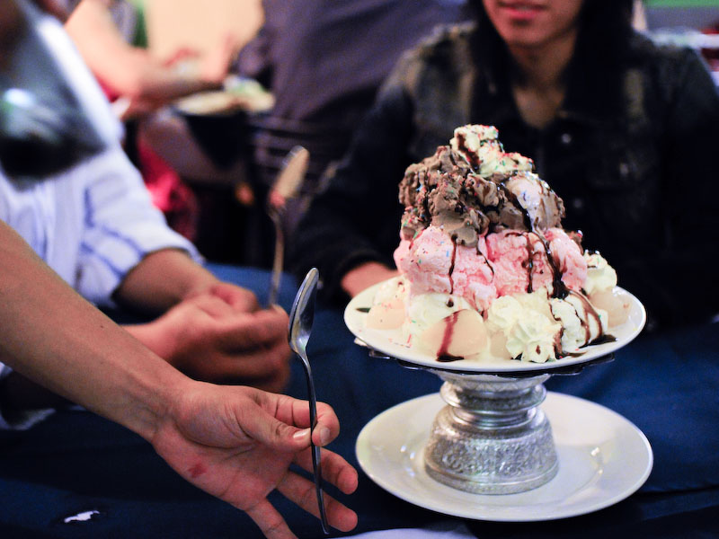

Here are some photos from over the past 7 days, all using the Sigma 30 mm f/1.4. The ice cream photo isn't sharp, but only because I didn't focus on it. The restaurant I took the photo in was quite dark, so I was forced to shoot at f/1.4. No flash. Combine the f/1.4 aperture and close focusing distance, and you get a very short depth of field. I'm still quite happy with the result.

Your shots all look fine to me. I agree that the 30mm focal length is very useful, but only if it also performs at lower apertures. Did you notice any softness and/or failure to focus perfectly on your low-aperture, relatively-close-up shots? I took some head shots of a friend and none of them were especially sharp, even when I aimed the AF point right on her eye. Very similar to what I saw with my buddy Spongebob.
