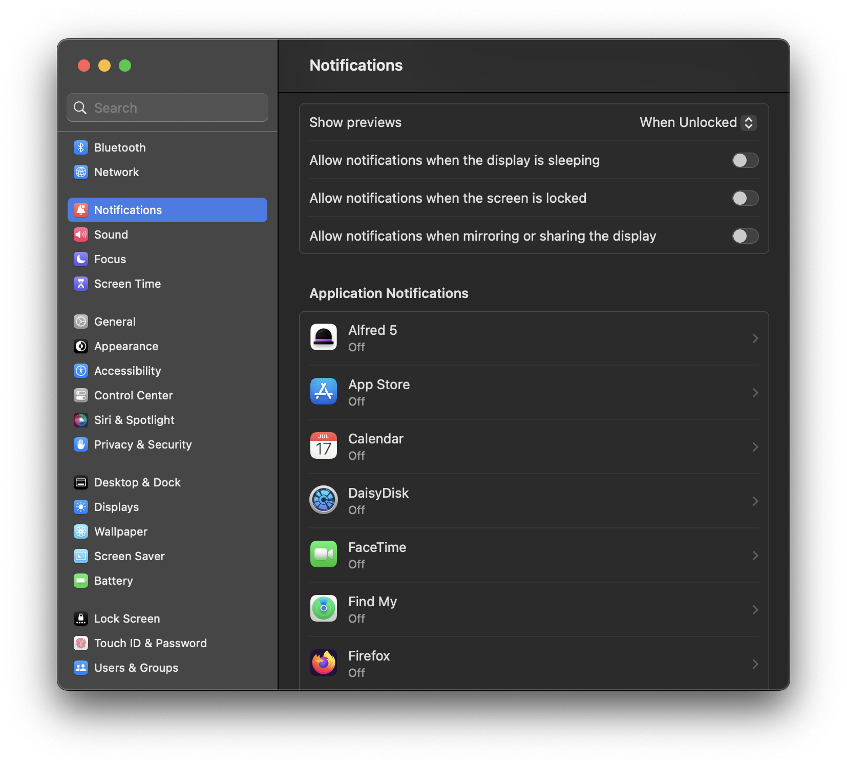

I've seen this happen when notifications are posted and wake the machine up from sleep. Try going to System Settings > Notifications and turn off the switches which allow notifications when the display is sleeping and when the screen is locked.
- Jon
- Jon
Thank you Jon,
But as you can see all notifications are already turned off

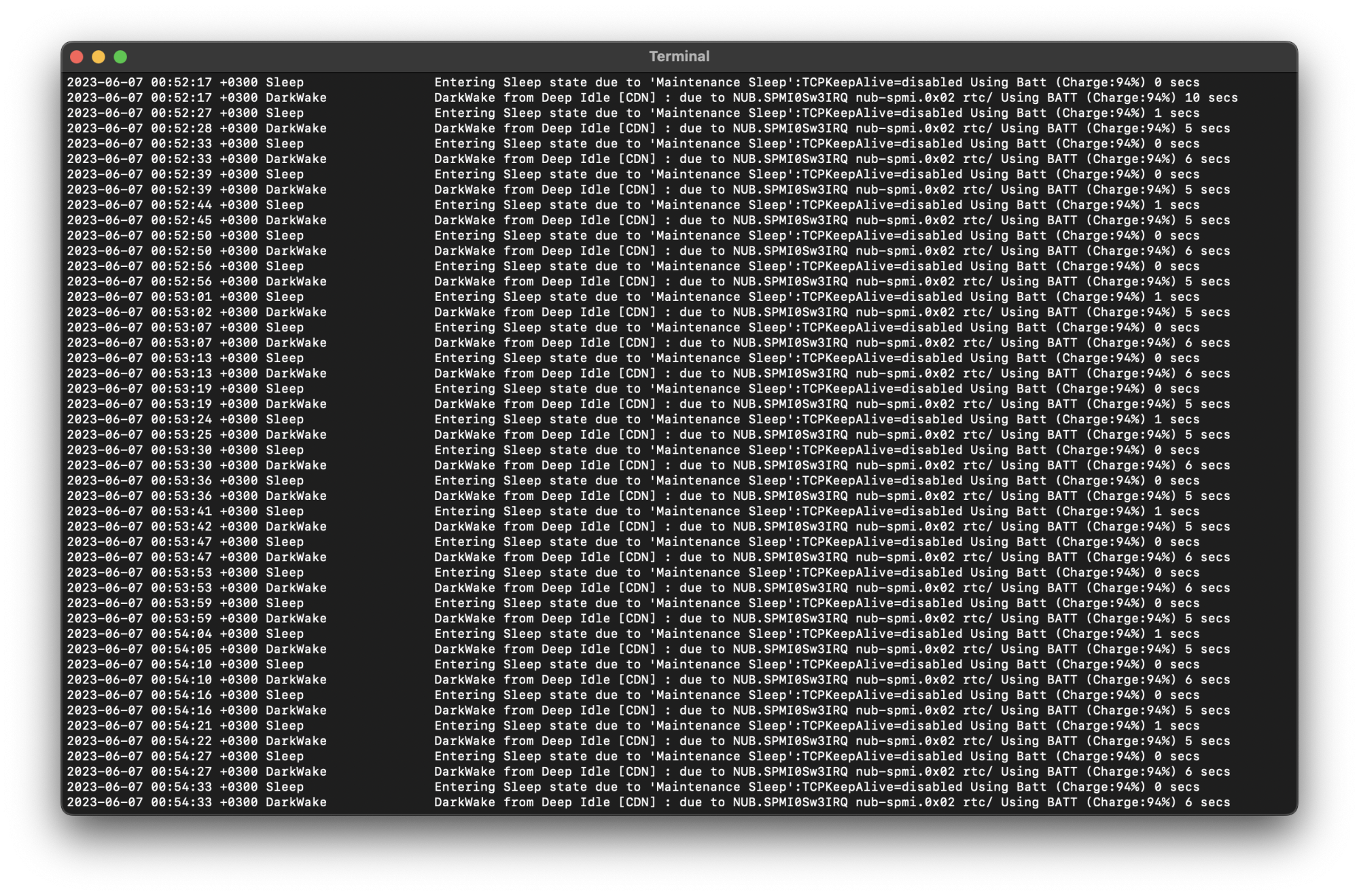

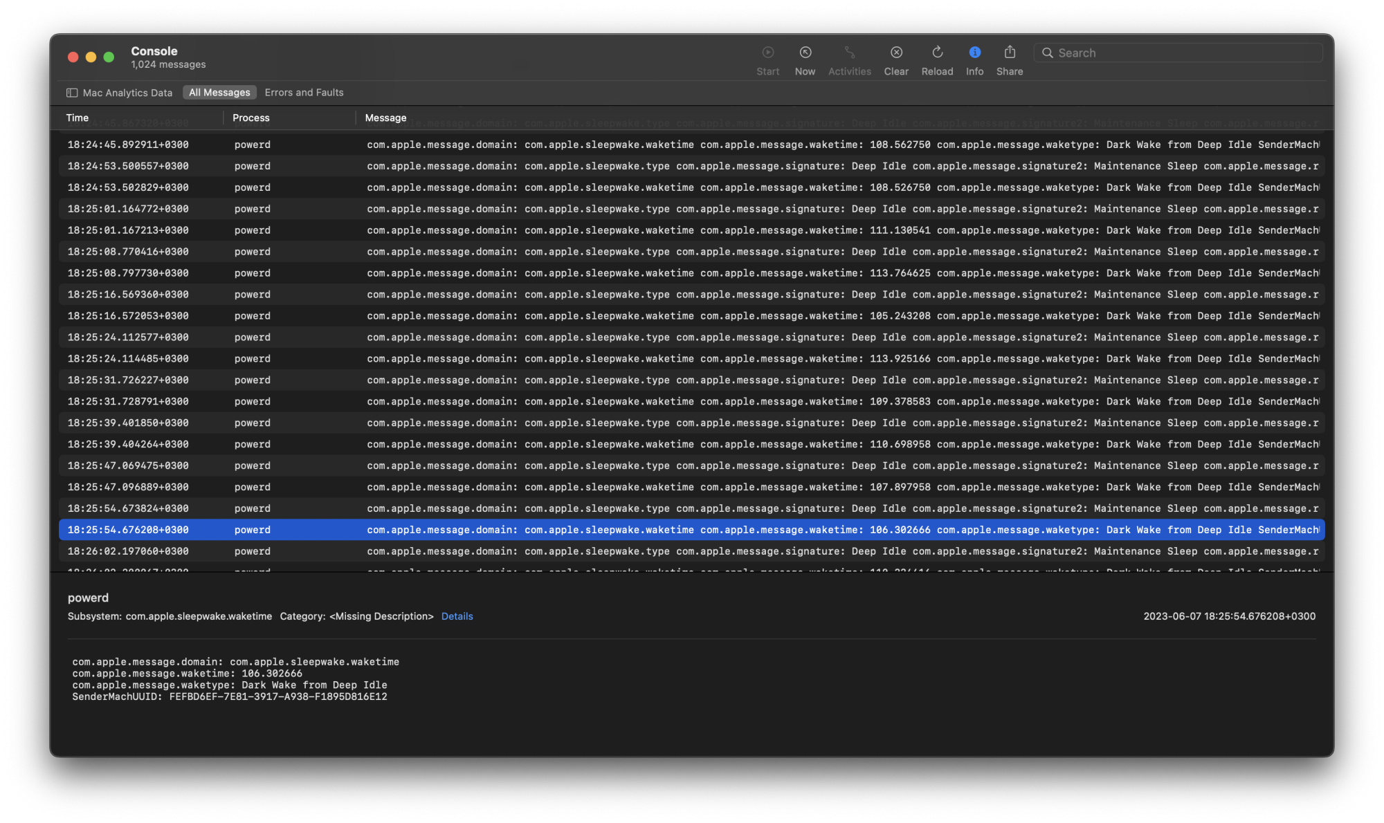

These are the console logs, maybe thousands, across a 12-hour period when the mac was closed

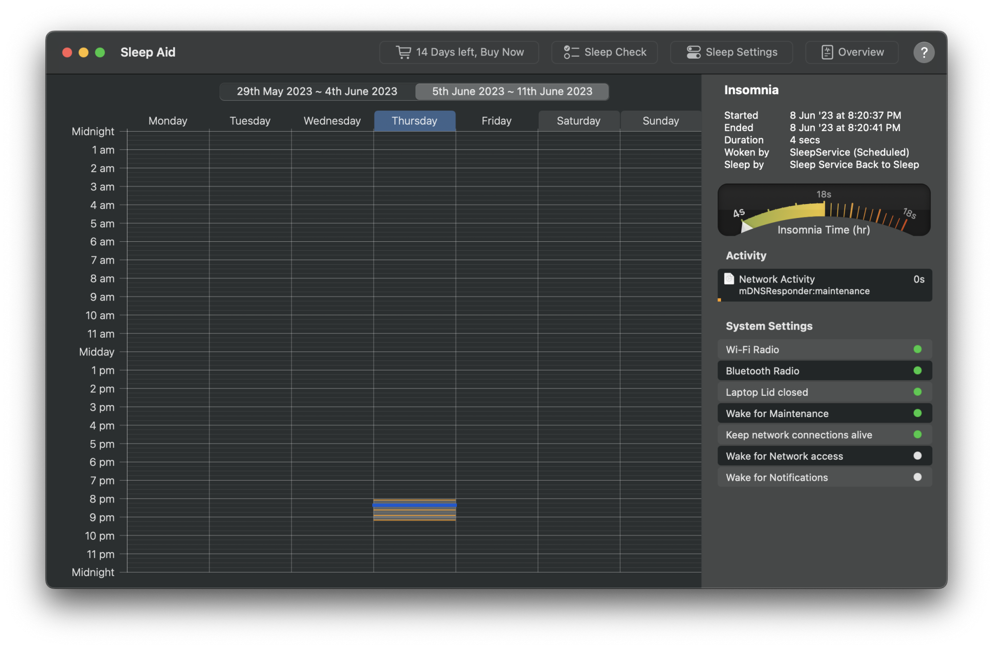

Grab a copy of Sleep Aid from https://ohanaware.com/sleepaid/ and see if it can give you more insight into what's causing the Dark Wakes. The console logs are giving you the instigator's Mach UUID, but that's not much help in identifying which software is actually triggering the wakes (or why).
Thank you Jon.
I've downloaded it and it is currently running and will close the laptop for the day. Will report back!
Jon, in the past hour while the mac is closed I see multiple instances of something called mDNSResponder:maintenance.

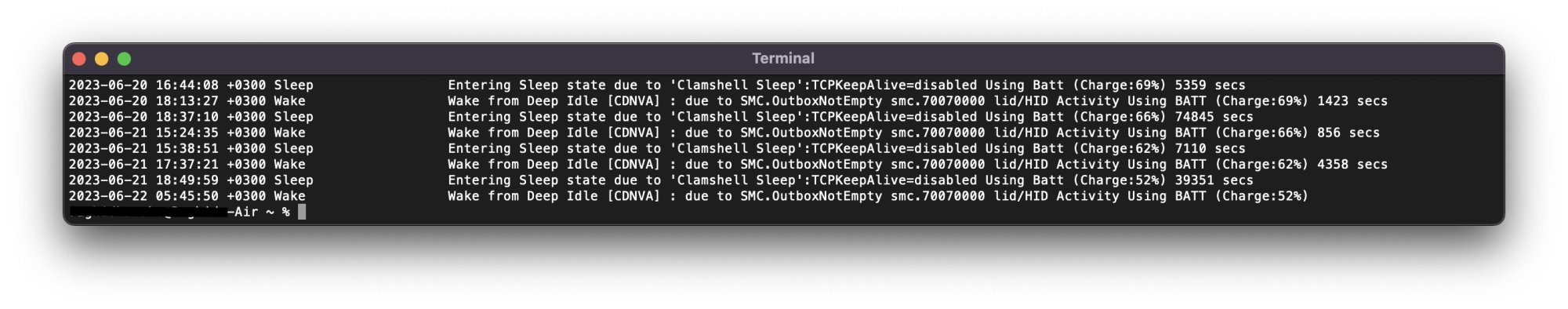

The steps I've taken so far are:
1. In terminal:
sudo pmset -a tcpkeepalive 0 ttyskeepawake 0 powernap 0 womp 0 networkoversleep 0
sudo pmset schedule cancelall
sudo chflags schg /Library/Preferences/SystemConfiguration/com.apple.AutoWake.plist
2. Install FluTooth, an app that turns off bluetooth when the mac sleeps (I instructed it to turn wifi off as well)
And it has seemed to fix the issue thus far. In the screenshot below, notice the last two entries, from 6:50pm yesterday until 5:45am today the mac slept peacefully while retaining the same 52% battery. Hope this is permanent and not a fluke.
