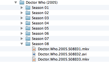

This is my example dr who directory. I tried removing it from the directory and rescanning then re-adding them and then scanning again. It added all but the current season. I converted the avi to and MKV and it scanned right away. So all the Dr. Who is all mkv and it works now, but any other show that has mixed file types fails to scan that season of the show. If the season contains all the same file types it shows up. So some shows have for example season 1,2,5 and missing 3, 4 because of mixed filetypes.

I wanted to thank all for your responses it seems to have been related to permissions that were on the media directory. Again thanks for all the help.
