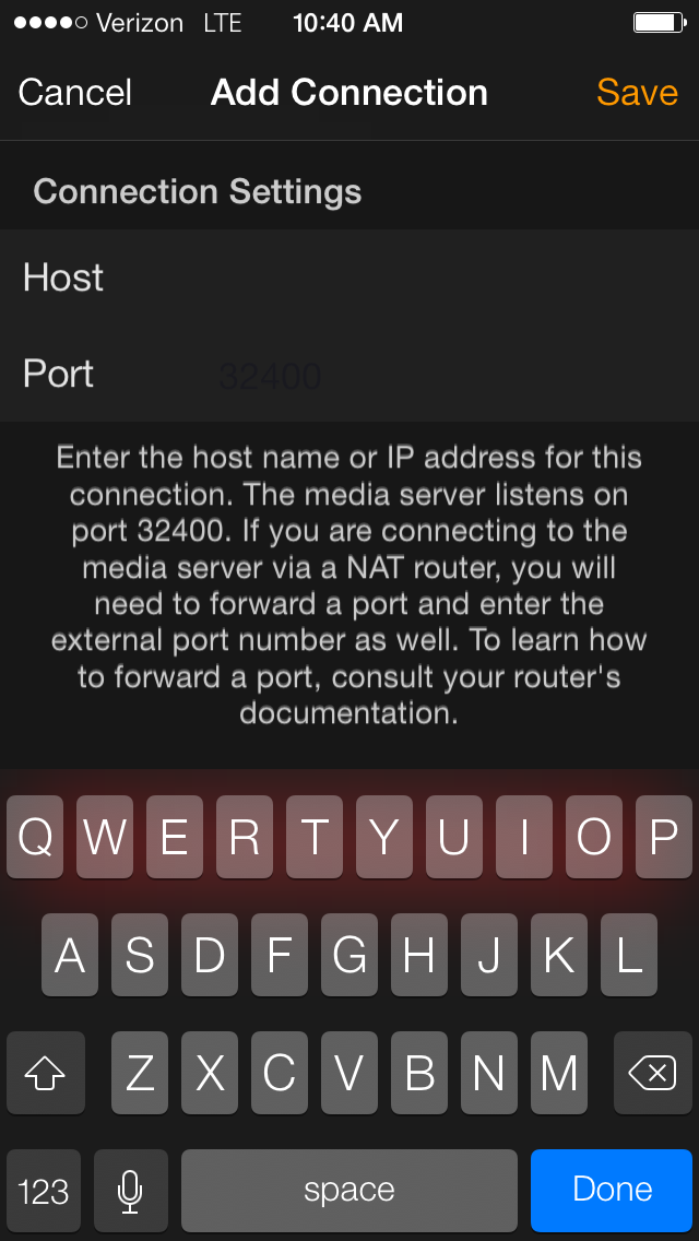

Looking at the IP address when the WiF is on, it's a short string of numbers, my router addres (127.0.0.xx)
So I'm assuming I need to hit 'Add a new connection...'
Is the 'Host ' supposed to be entered as my long string IP address? (71.201.2xx.xxx)
And the 'Port' should be the same 32400 as the home connection?
If this is all correct, it doesn't work, and no Channels appear.

I've managed to figure out the Port Forwarding but still NO sign of my channels on the iPhone Plex App.
What am I entering incorrectly either in the AP Utility or iPhone?
Should the IP address be my IP long string, or the 10.0.1.201 listed here?

You shouldn't have to mess around with the port settings.
Go to Plex settings (preferences).
Under myPlex, make sure you are signed on to your account and that you have a green check next to "the server is mapped to port xxxxx".
I found on my Mac, I needed to add Plex to my System preferences Users and group login items (i.e. to have Plex initialize correctly when I turned on my computer).
OMG! something worked!
I've kept it on cellular at home for experiment because I know if it works w/o wifi it's gonna work anywhere.
I added the Plex Server 'App' to login items like you said, and found in the settings in the app itself that the port was a completely different number.
I opened on the iPhone and expected to enter the dif number and apparently it added it for me already!
