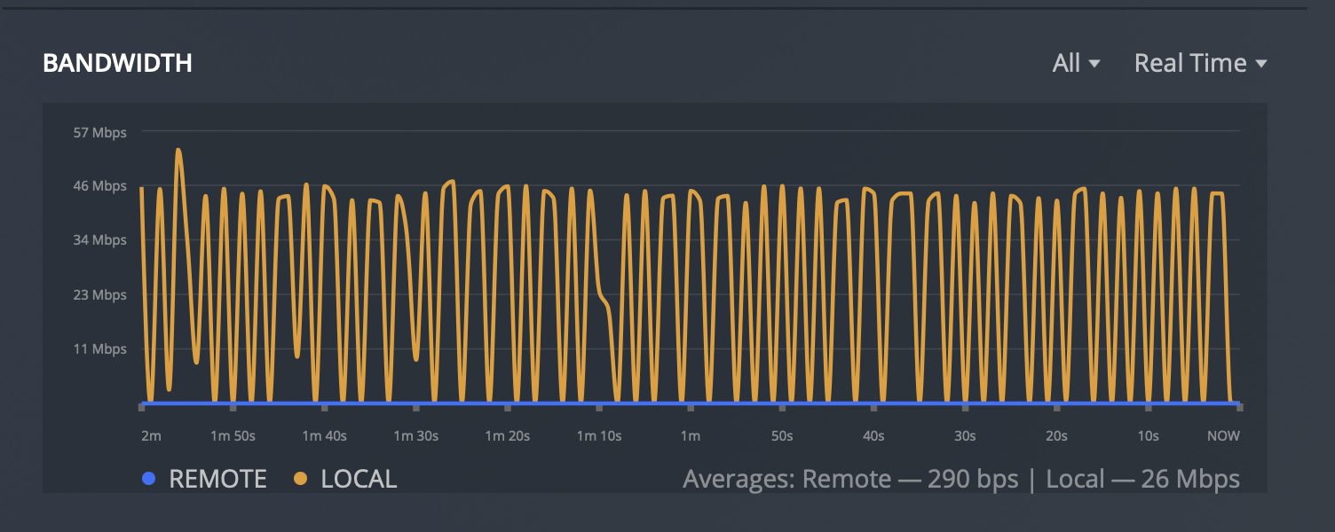

If you go to the Plex server dashboard when it is throttling what bandwidth are you seeing? You can also get this information from the Plex Dash IOS app.
These results are for Plex streaming a 1080p MKV to my Apple TV. Don't use the TV Plex app, but looks like the TV bandwidth could certainly be a problem for 4K given that a 1080p is hitting 46 Mbps. LG seems to hide this information as can't find in the technical specs for your TV.

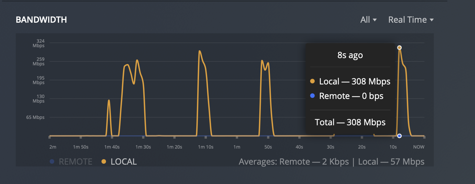

I ran a test of my highest bitrate 4K MKV (Snatch). Video is ~83 Mb/s with audio ~4.6 MBS so its ~87 Mbs. Streaming bandwidth peaks at ~308 Mbps. This is via WiFi on my C8 so looks as if it has gigabit ethernet. Experienced buffering issues which you can see on graph when bitrate is 0. Not all of these were pauses though.
Had fewer buffering problems streaming to my Apple TV maybe due to greater horsepower?
