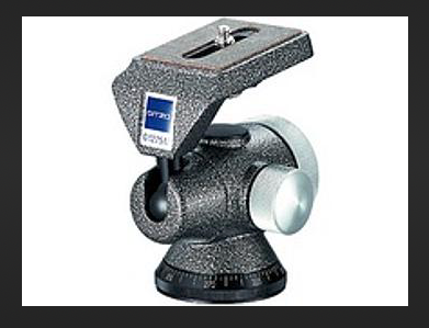

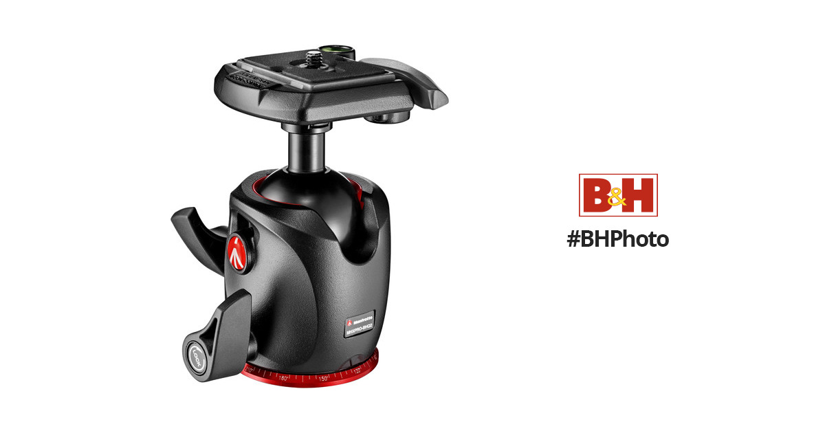

I had to replace a ballhead that was no longer supporting the weight of my camera with the Manfrotto below. I have mixed feelings about quick releases but have been fairly happy with it. Fortunately, I also found a great deal on an old Gitzo ballhead like the picture below that I love.

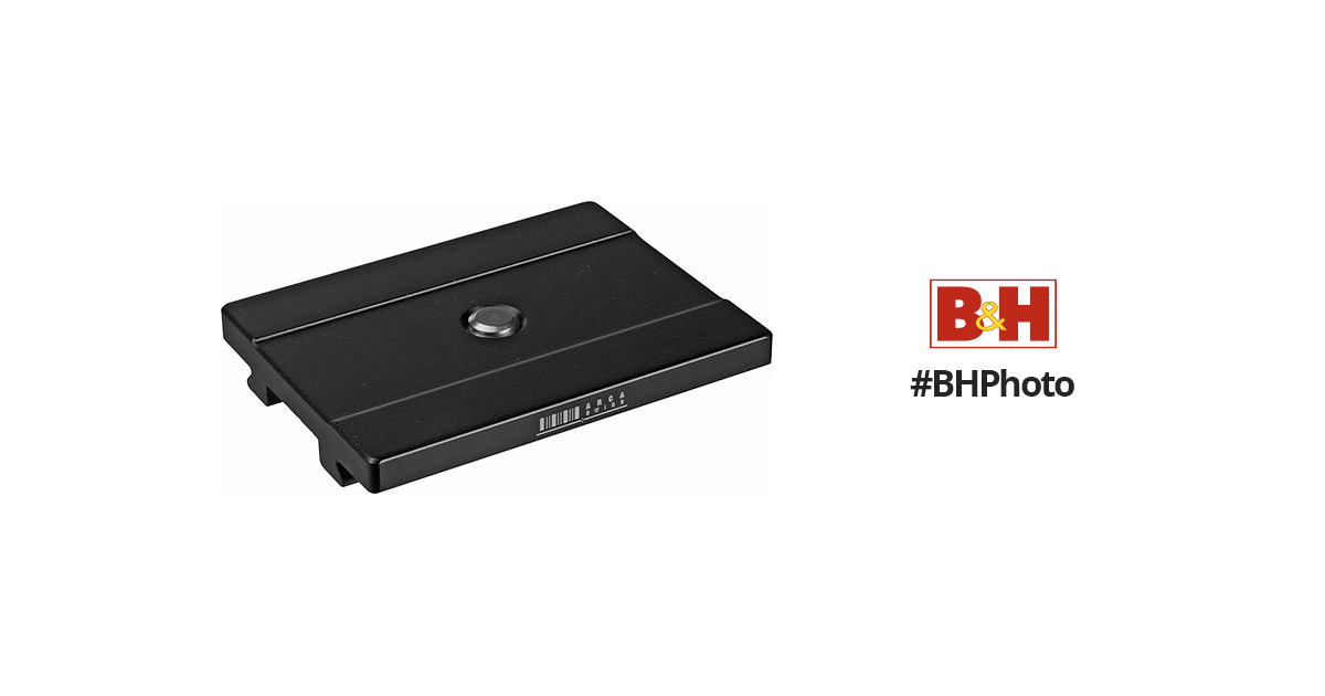

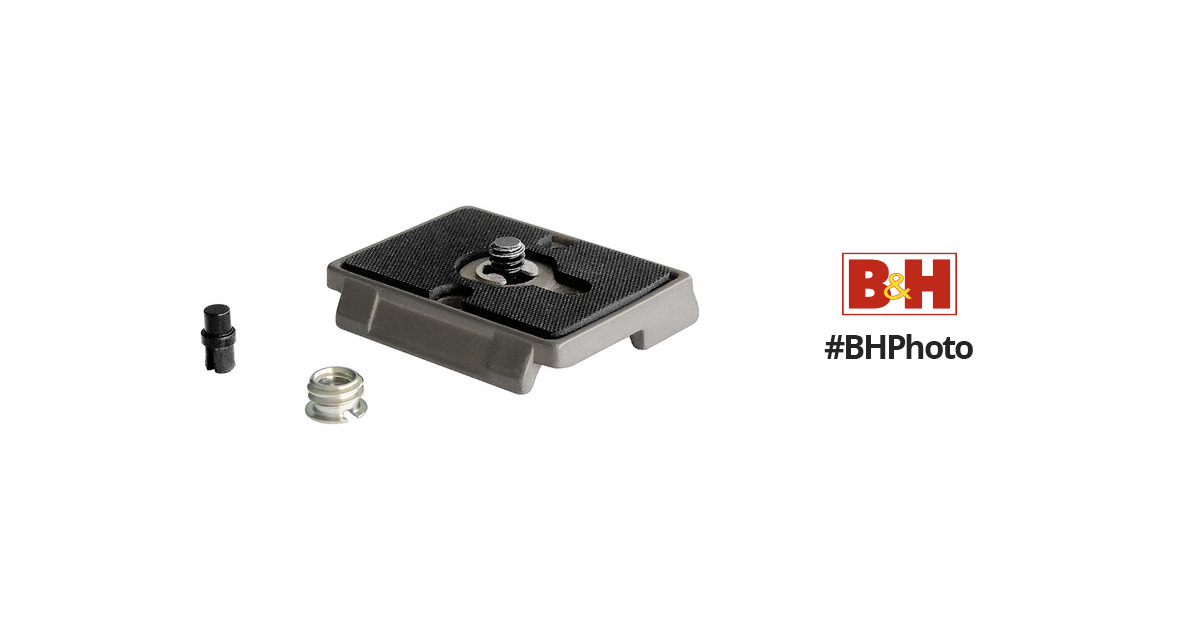

Here's the legacy Manfrotto plate:
The biggest disadvantage with this style is that's really bulky.

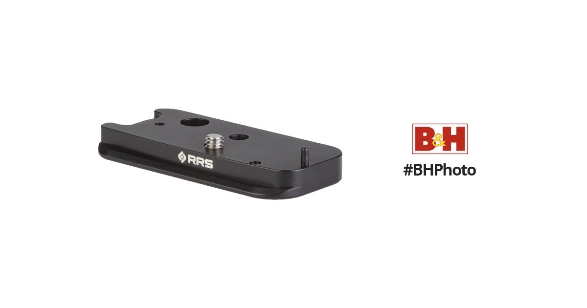

Really Right Stuff addressed this shortcoming in the Nineties by adding a safety stop screw on one side to only allow the plate to be mounted on the tripod head one direction.
Note the slim profile of the RRS plate. It doesn't extend beyond the SLR body's depth. A soft neoprene camera cover can be used on this combination. The large legacy Manfrotto plate often requires the plate to be removed from the body for storage.

The spring-release Manfrotto quick-release mechanism is decidedly bulky. Even if you have a compact, lightweight travel tripod, you're still stuck with a system that must accommodate a large mount plate.

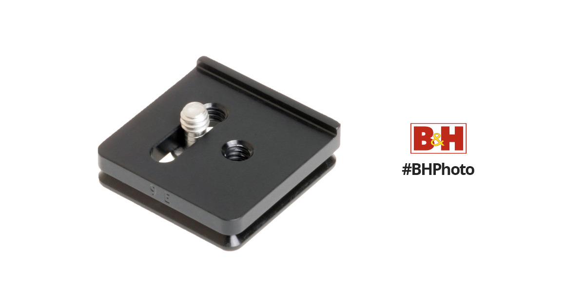

By contrast, with the Arca-Swiss style system, you can have really small mount plates. I have one of these:
a plate that I have moved around from camera to camera for over twenty years. Today it currently resides on one of those cheap smartphone clamp mounts.
