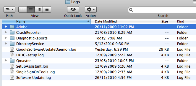

but thr is no such winclone.log file in my... library/logs folder/
any other methods to find the log ?

thnks indeed for tht,

Yes, but we need to know what flags were used to create the dmg to restore it properly, hence my request for the log file.
The "~" in front of the name is shorthand for your user folder and is important. The file is usually in /Users/<your_username>/Library/Logs
You could also run Winclone, go to the Window menu -> Show Log Window and just cut and paste any info that shows up there between CODE tags.
B
thnks a lot for your explanation , nw i've got the folder , i wasn't lookin at th rite folder b4,sorry indeed for tht .
since i am an amateur in readin th log file,ur explanation will really really appreciated.I tried to restore the image many times so the same log file may have repeated many times.
