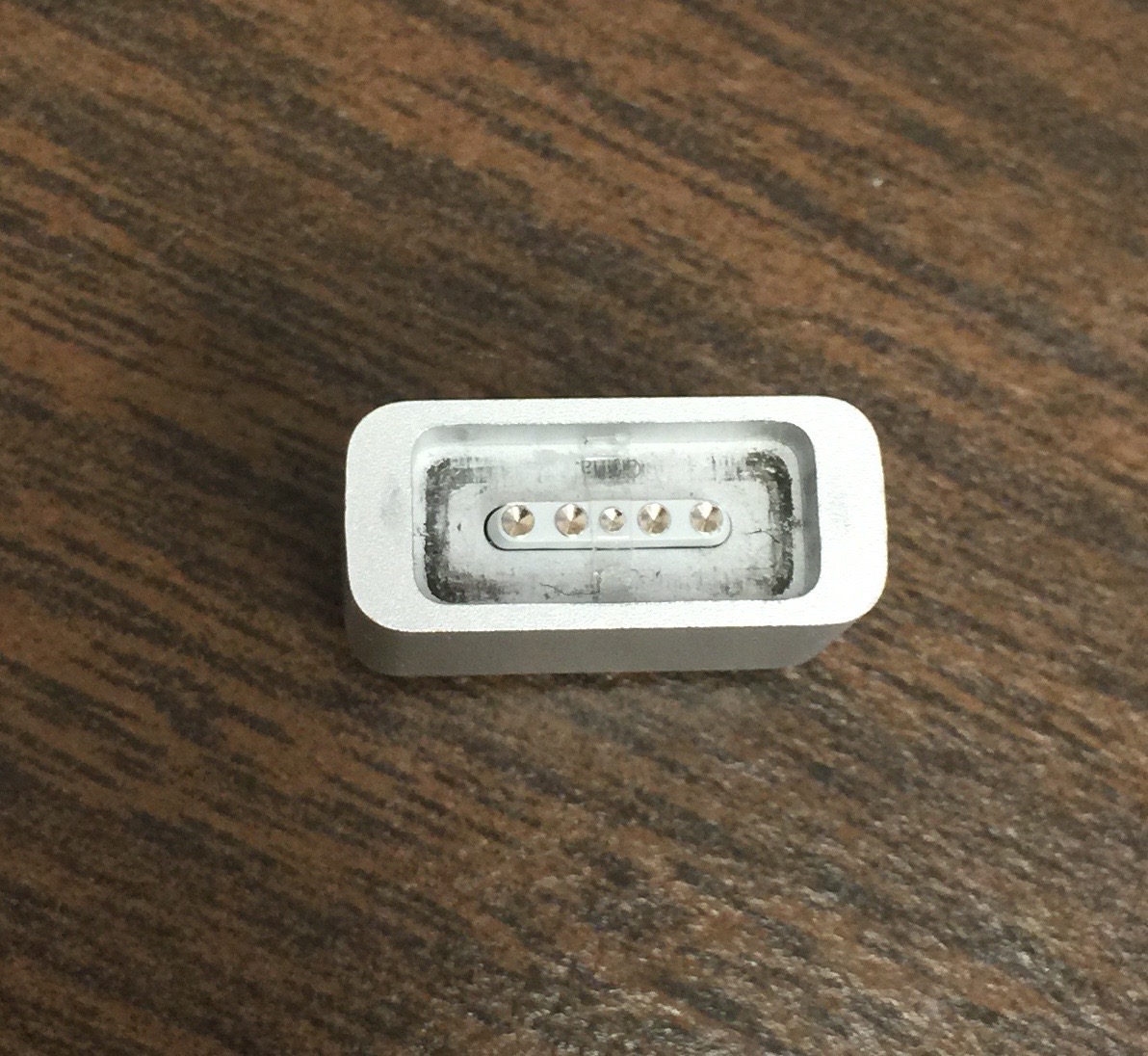

They also like to be exercised once in awhile. I'm OCD so I've decided to a little trick with my MacBooks. For the ones that I don't take on the road, I use their batteries down to about 50%, I then put a little strip of electrical tape on the middle pin on the magsafe connector on the laptop. When this is done, the AC adapter will continue to power the macbook, but the battery won't be charged. I know it's an inelegant solution, but unfortunately Apple doesn't have a battery saver app like Lenovo. Lenovo's app is awesome, you can dictate at what percentages to start charging/discharging. That way you can keep the battery from being maintained at >90% all the time when plugged in which is harmful.
Hint: It's easy if you use a magsafe 1 AC adapter on a magsafe 2 macbook, the tape goes on the magsafe 1 to 2 adapter...
