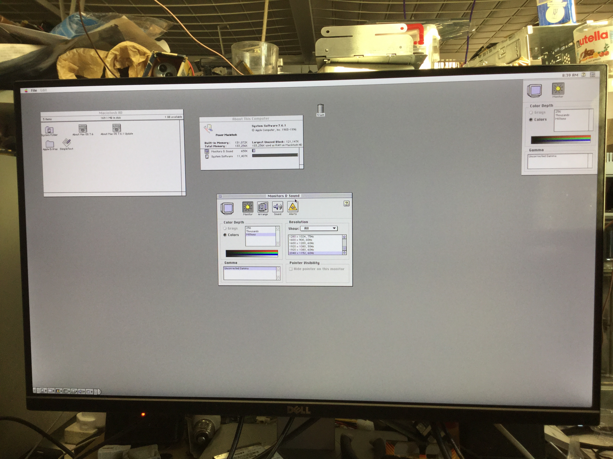

not quite what the OP is looking for but have a picture of my own U2715H Jabbed into my Power Macintosh 4400 (through DVI on a Radeon 9200) running 7.6.1 LOL
(although if the OP cant get an adapter to work, picking up a cheap DVI card for his G3 beige might be another option, of course you could also remove the HDD from the G3 beige and connect to a modern mac if all else fails)

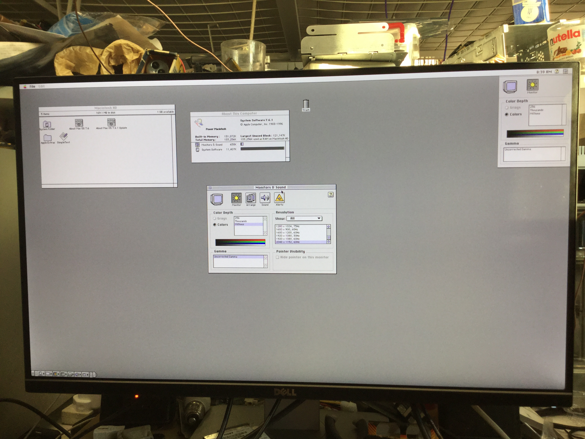

This is useful to see, thanks.
