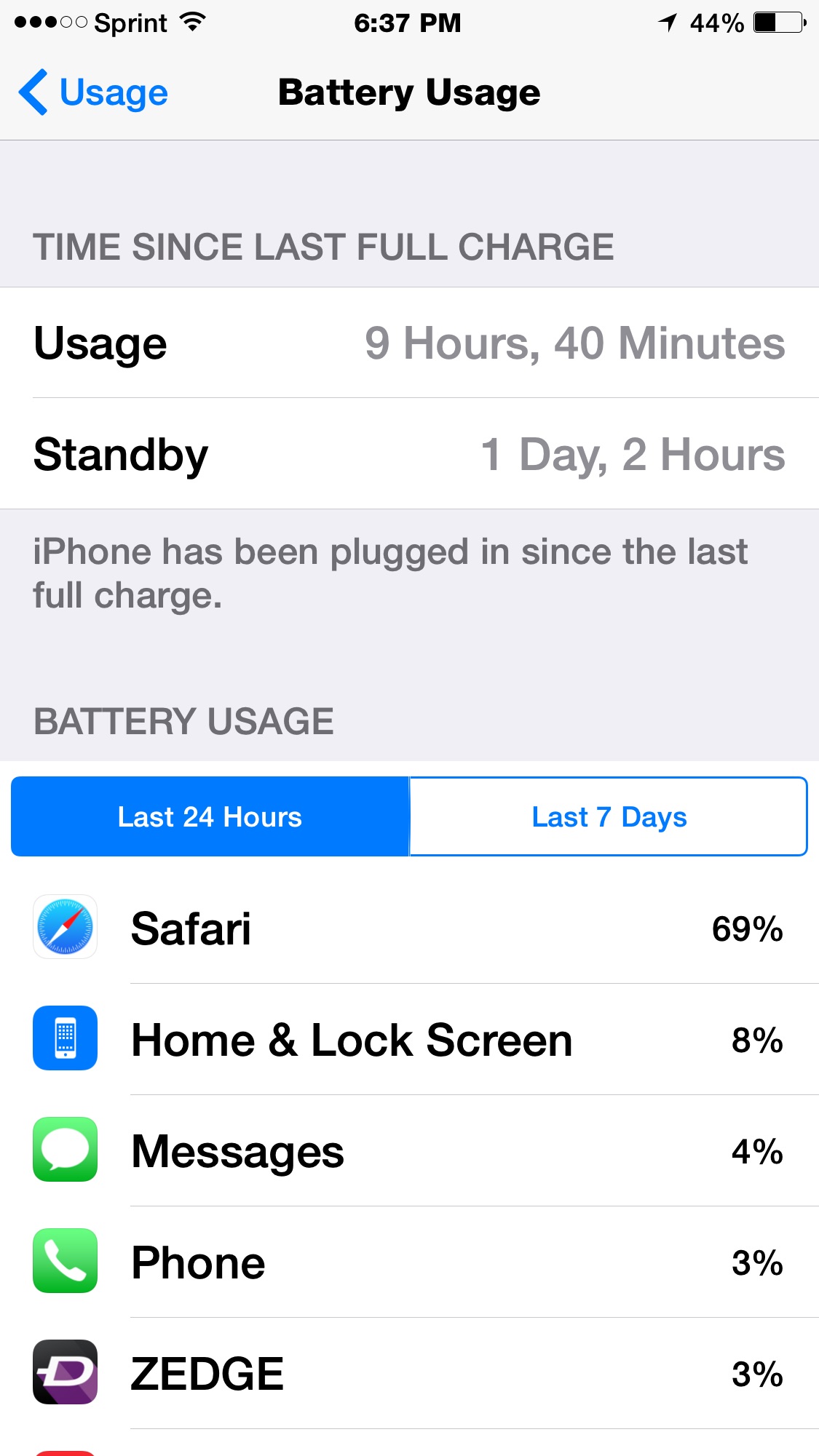

Couldn't be happier with mine. I have come over from android and this is best battery life I have seen on one of my phones.
